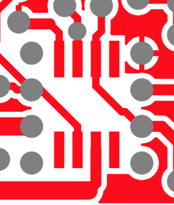

By the way, I have now redesigned the PCB that has incorporated all items I listed earlier. It now includes opamp compensation for both the + / - inputs, retaining matching impedance for both + /= inputs of the opamp for both AC and DC, same as in Jung's "Improved" document. It also includes a proper implementation of the RC for remote sensing as in the "Part 4" document. I have tightened the PCB tracks as Jack suggested. I am very happy with the result. I have ordered the PCBs from PCBWAY.com and ordered the new parts from Mouser. I expect that I can start building it with the new PCB in about a week's time.

On your plan to lay out two PCBs, one with DIL. other with SMD: with a bit of effort you can have the two footprints together so need only one layout, saving a bit of money. See the diy store PCB.
Jan
Thanks, Jan.
I noticed that AD817 has 8 SOIC as well, so the same footprint will be good for both the AD825 and AD817. So I have abandoned the idea of having 2 PCBs. I will have just one for the 8 SOIC.

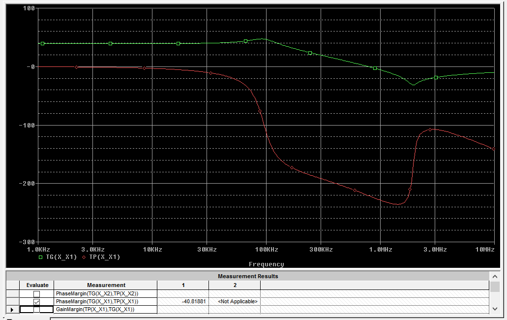

It is actually pretty easy to watch in LTSpice (or any other simulator) the stability impact of a high Q ceramic cap at the output. Below, the loop gain for 100uF (model includes ESR and ESL) and a 100nF ceramic cap with ESR and ESL set to zero. A Tian probe is used for this analysis.
Phase margin is -40 degrees, a clearly unstable loop.
Thanks. I don't know how to model the "capacitor" out of ground plane / power plane.
When I designed the load board I deliberately designed it so that it has large overlapping areas to minimize inductance, EMI and maximize the "free" capacitance. I measured the capacitance to be as high as 2nF.
So what is the ESL and ESR of this 2nF?
Would you mind replacing your 100nF in your Spice model with 2nF with the same 0 ESR and 0 ESL and let me know the new phase margin?
