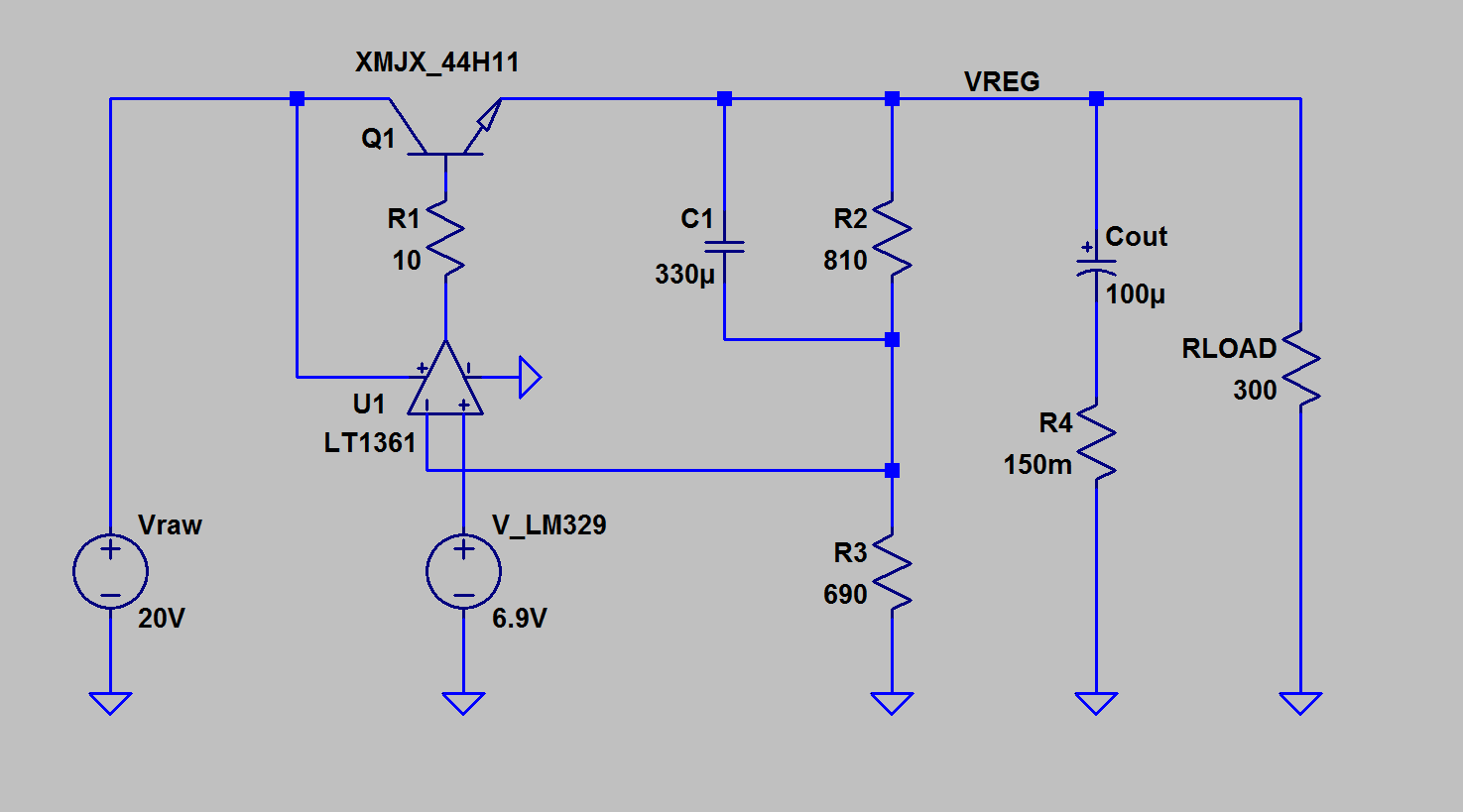

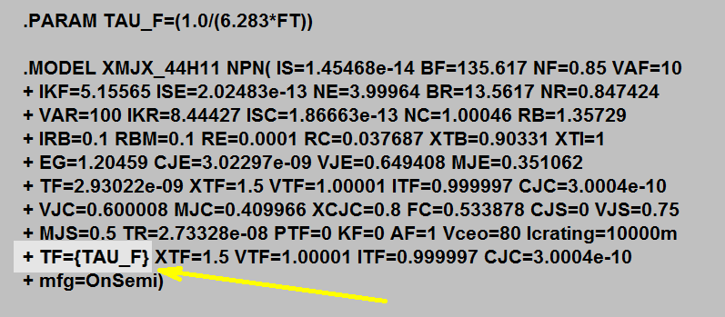

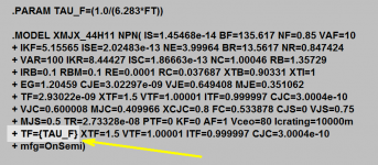

I slapped together a barebones Super Regulator using a 50 MHz opamp (LT1361) and a D44H11 pass transistor: see Figure 1 below.About the pass transistor Ft. How important is that because it is used as an emitter follower...
EXCEPT that I made the pass transistor's fT into a user adjustable parameter. SPICE BJT models include a parameter TAUF which is simply (1/2*pi*fT). So I simulated this Super Regulator with pass transistors having many different fT values, see Figure 2 below.
The results are shown in Figure 3. This is the open loop transfer function; notice that changing the fT of the pass transistor, changes the overall loop bandwidth. Does pass transistor fT have any effect at all? Yes. Yes it does.
By the way the frequency response plot clearly shows the output capacitor's "ESR Zero" (reference) around 20 kHz or so. TI didn't lie to you; that's a very real phenomenon.
