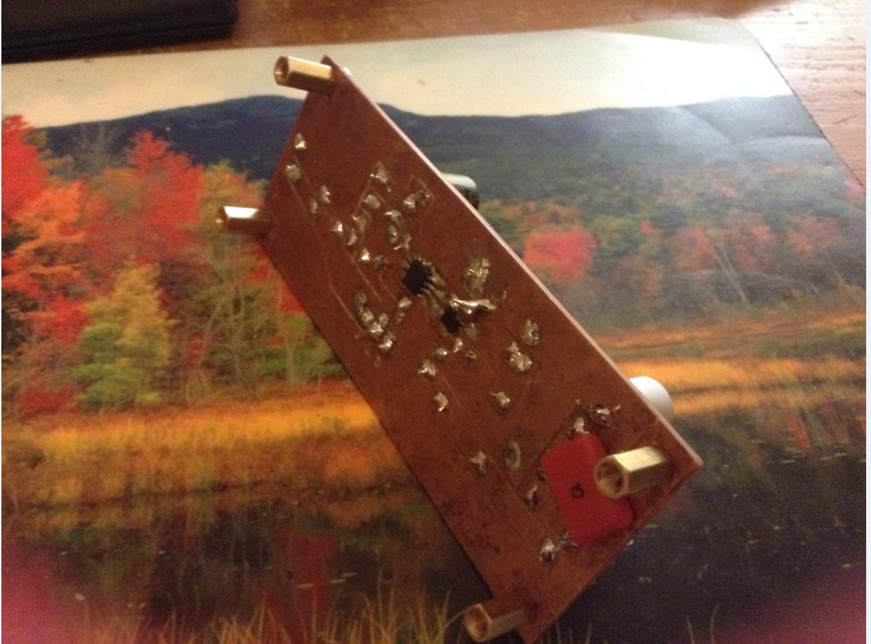

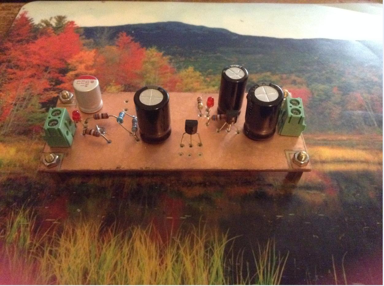

my build!
Notes:
-sole jfet ccs (2n5457)
-last reference voltage cap is a ceramic 4.7uf (cap is determinant to sound and ceramic sounds better in balance than any other (electrolytic,film,sp-cap) to me, for 3.3v clock supply). the sound is now similar in this regard compared to the venerable Salas PSU.as per official schematic, the lytic cap made the sound high pitched and not enjoyable in the long run.
pass bjt is bc550b (this high gain type sounds definitely better than other lower gain gain caps) and plan to parallel to lower output Z further.
-i'm waiting for a part for my "special" Salas build for final battle.
-lmp7731 is the op-amp fed from output
-i made a quick point to point build previously and i THINK the one i'm presenting sounds better. Short cable to load defenitely is a major improvement.
-i have no scope, so only subjective impressions.
