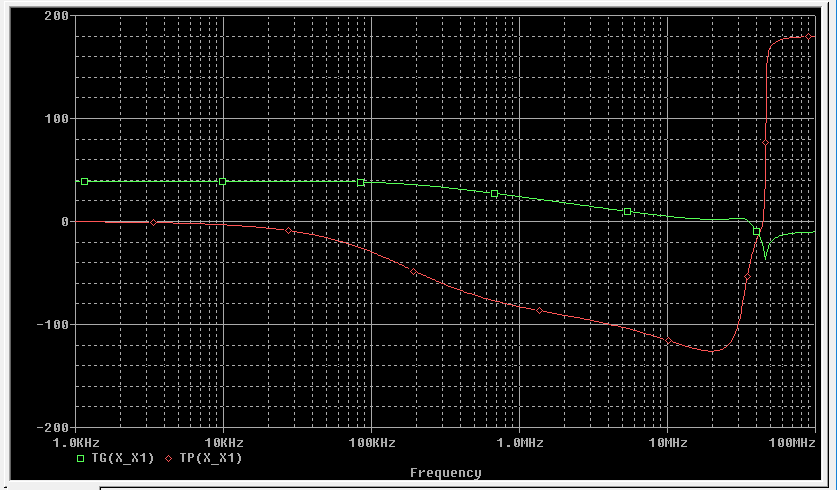

Thanks. I don't know how to model the "capacitor" out of ground plane / power plane.
Would you mind replacing your 100nF in your Spice model with 2nF with the same 0 ESR and 0 ESL and let me know the new phase margin?
You ought to learn this stuff, if you ever want to go beyond building kits. Anyway, find below the 2nF case. Not good, ULGF is over 30MHz, meaning the stability will heavily depend on the layout. Very likely it won't be stable in any DIY friendly implementation (through hole parts, generously spaced).
Mr. Jung is entirely correct. No high Q (ceramic) caps at the output of such a regulator. I would suggest even avoiding tantalum or any aluminum polymer devices, just use an old plain electrolytic.

Hm, my new PCB will possibly have up to some tens of pF between the power track and the small ground plane on top of it. I have not got rid of the habit of doing it that way trying to minimize track inductance and RFI. The error amp and sensing tracks are not covered by the ground plane to avoid getting noise.
Based on your simulation, some tens of pF should be fine as it will probably affect only the tens of MHz region, and if the opamps are compensated with a -3dB at 3MHz, hopefully, won't cause problems.
