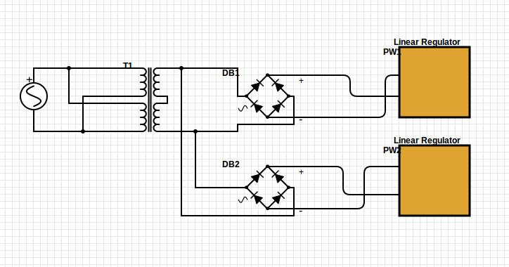

Here is a diagram of how i have it wired up. I forgot to mention that i had c8 polarity reversed so i replaced it with a new cap in the correct polarity, could this have damaged something else in the supply?
... but of course if you now connect a + from one supply to a - of the other you short out the bridges. You do see that, right?

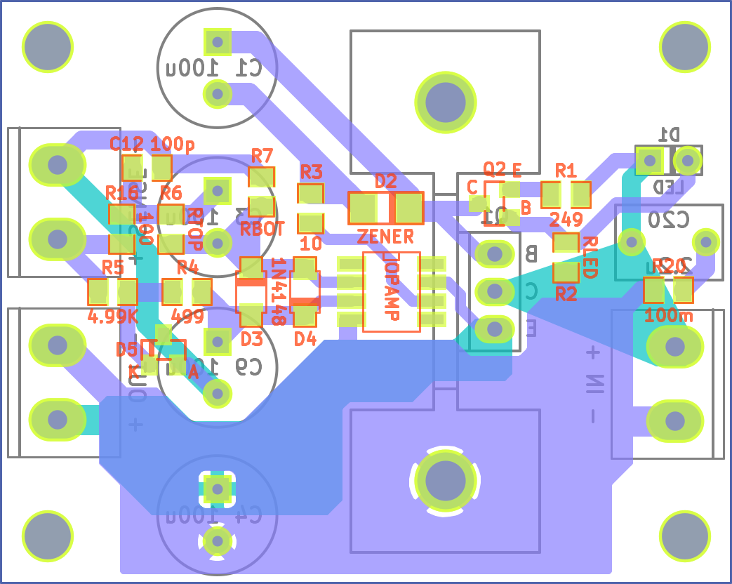

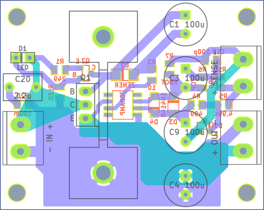

Hello,
I've layed out an SMT board (49x39mm) for 10V@50mA duty
Flip D1 180 degrees.
Depending on the input voltage, you might be able to get away with pouring copper instead of using a heatsink -- in this case you can use an SMT pass transistor.

Hm, I believe it is already correct (notice the cathode notch on the silkscreen).Flip D1 180 degrees.
Perhaps AndrewT meant that the opamp needs local decoupling of the whole circuit, i.e. 120uF C2? I've replaced it with a 2.2uF film cap in series with a 100mR resistor to get more HF attenuation, just in case the snubber on the bridge+filter board passes some of it through. The bridge+filter board will be ~2cm away, so I was hoping that extra ~20mR (from connectors) and ~15nF won't make much difference compared to the ESR/ESL of the last capacitor in the filter.Normally you are correct but this can end up in heavy oscillation.
