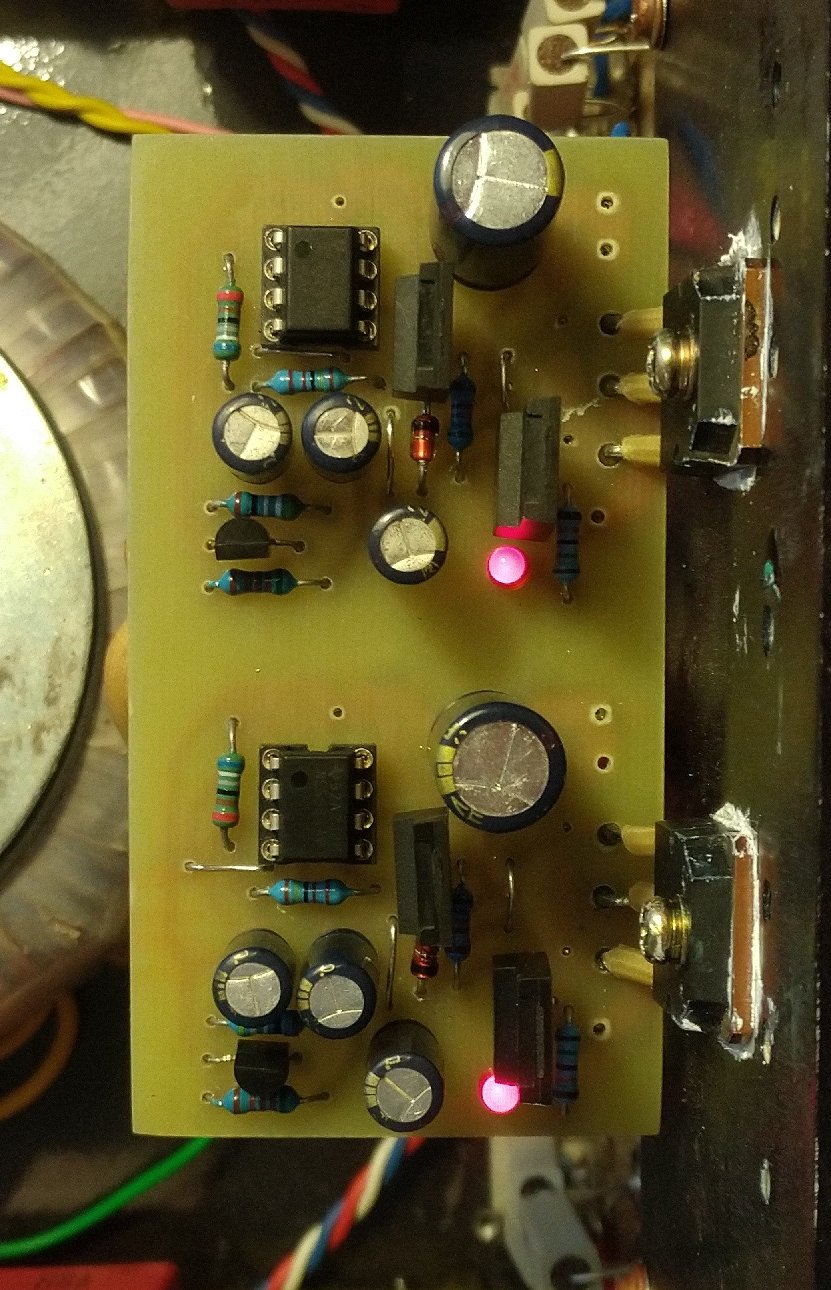

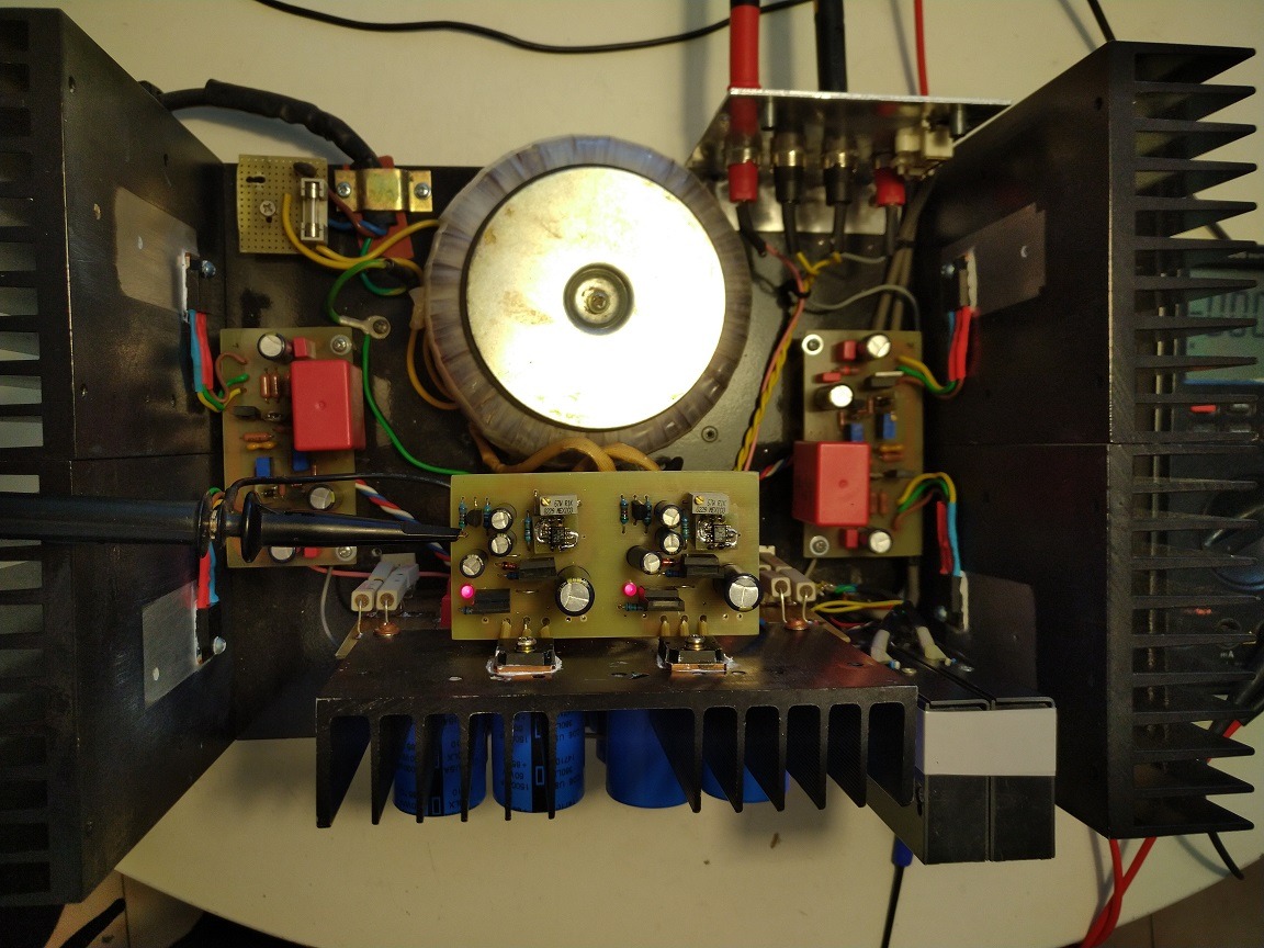

Four years ago I made the first 5A version, it took a bit of effort but it paid off in the end.
I haven't taken them out of the amp (JLH69 or Le Monstre) since then, except that they are now quite improved.

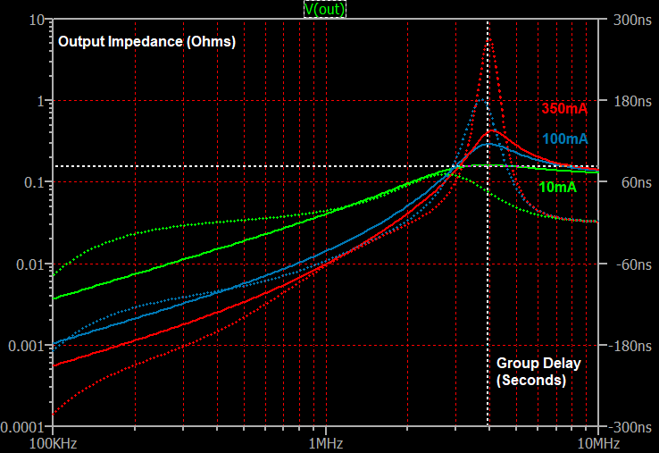

As the current increases the gain of Q1 increases...approaching 100mA you start to experience impedance peaking....MJL3281A DC gain is about 50% higher than D44H11 IIRC.
The compensation is C3||R6 (120u||1k) and C4. For my simulation I plug in an ESR value of 120 milliOhm. Jan, in his 2015 schematic draws C4 across the output. Instead, decouple it via R16.

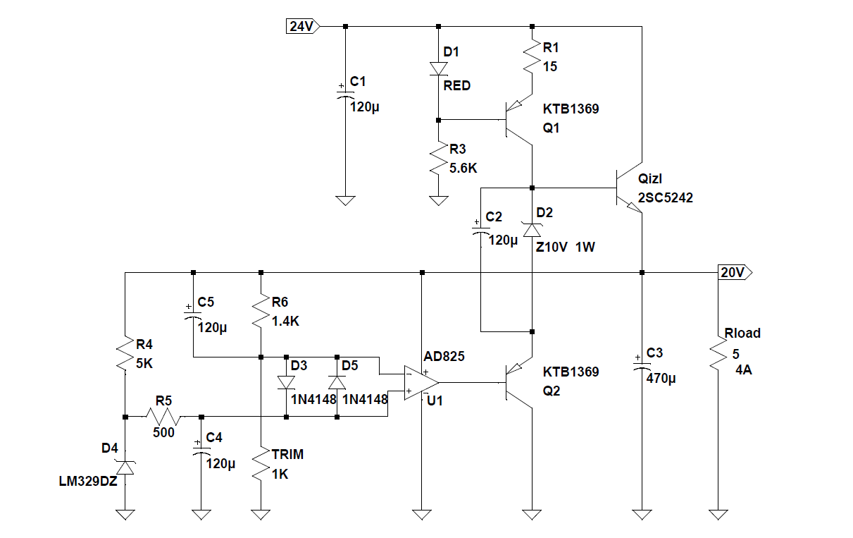

The new version is no longer so simple, now it has 13 transistors (10 SMD) and does not use any zener diodes or references. All parts of the schematic are not mine, so the publication will have to wait.
To begin with, I am attaching the first test version that I used in JLH69, instead of KTD2061/KTB1369, TTC004/TTA004 or the popular BD139/140 can be used.

J-fet op amps enable much better performance of the regulator, especially if the value of resistor R4/11 is increased (up to 10k depending on the op amp itself and the used C9/10) in the RC filter.
Which type of op amp's input resistance, common mode or differential mode, allows increasing R4/11? For example, AD797 is known to perform well in the Super Regulator (if not oscillating). Its input resistance is 100 MOhm common mode, but only 7.5 kOhm differential mode. Can R4/11 be increased with this opamp, say, from 500 Ohm to 5 kOhm? Thanks!
It is not input impedance but opamp input current noise that makes a difference. Here is good explanation:
https://www.analog.com/media/en/training-seminars/tutorials/MT-047.pdf
With bipolar opamps as is AD797, large resistor at input will have more noise voltage produced by opamp input current noise passing through resistor, than is resistor thermal noise. Resistor is a part of RC filter, so noise will be attenuated, but we have a higher starting point.
JFET opamps have 1000x less input current noise.
For AD797 no ,because, like all bipolar op amps it has a much higher input bias current than jfet op amps, in combination with the high resistance of R4/11 it increases the error - voltage variations. For this reason capacitors with low leakage current are essential when using R4/11 with a resistance above 1k.
