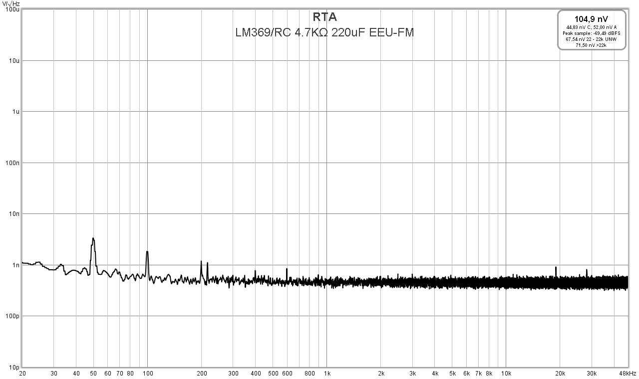

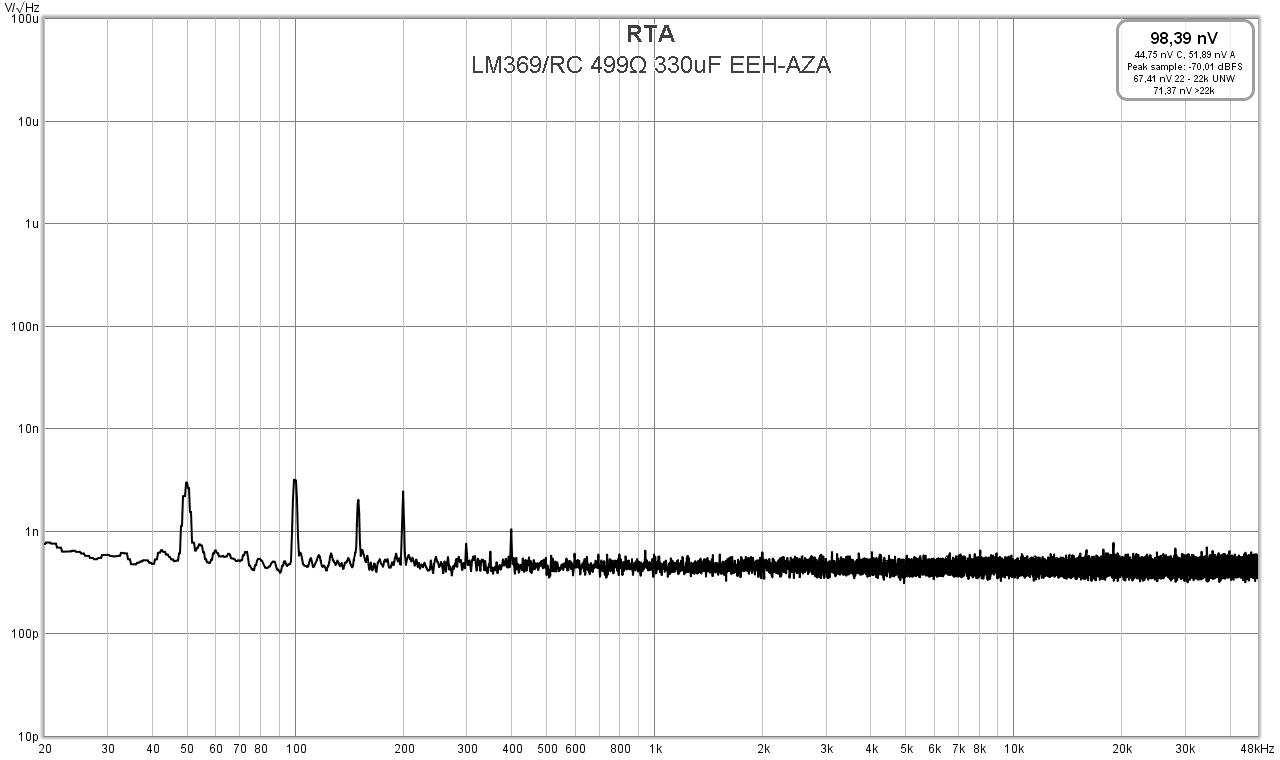

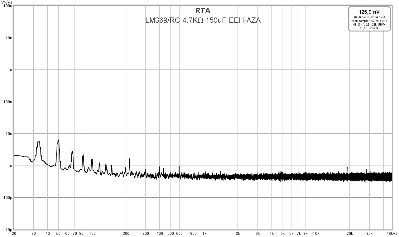

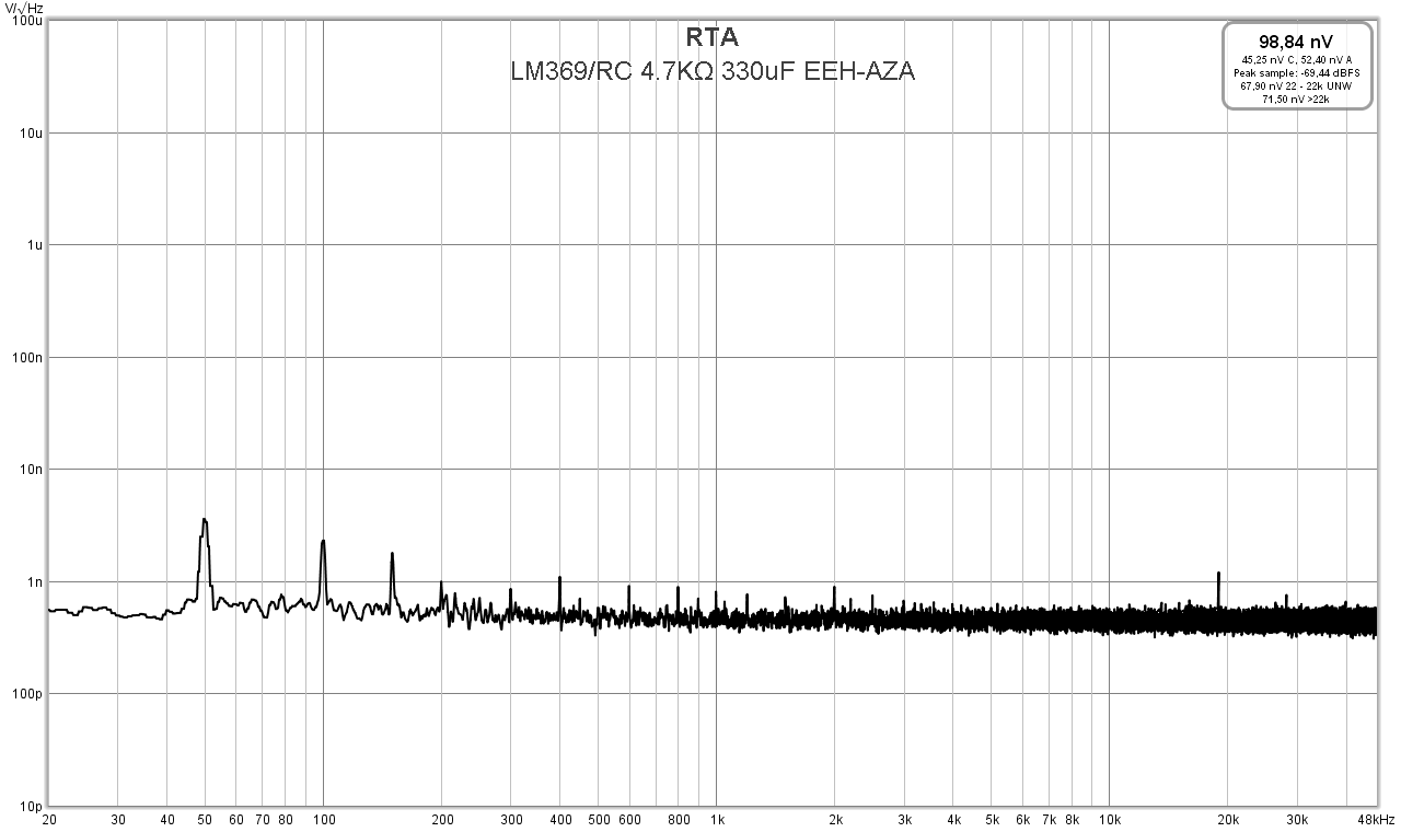

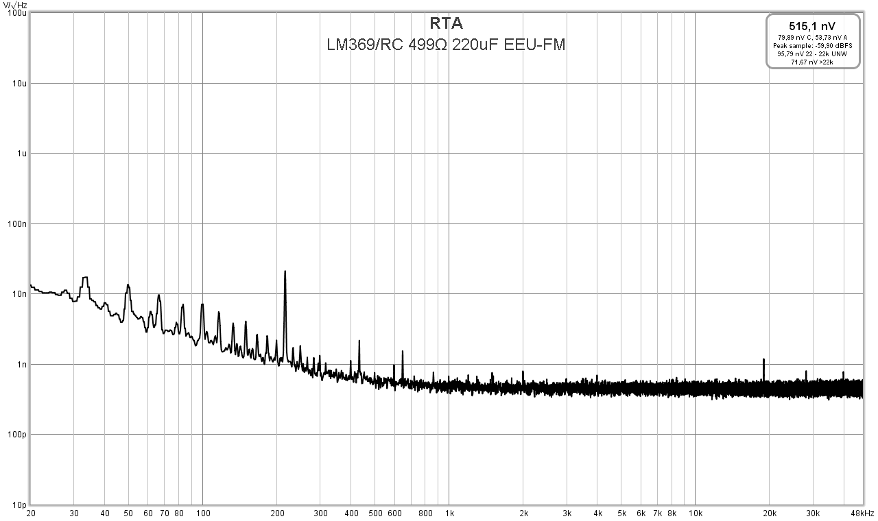

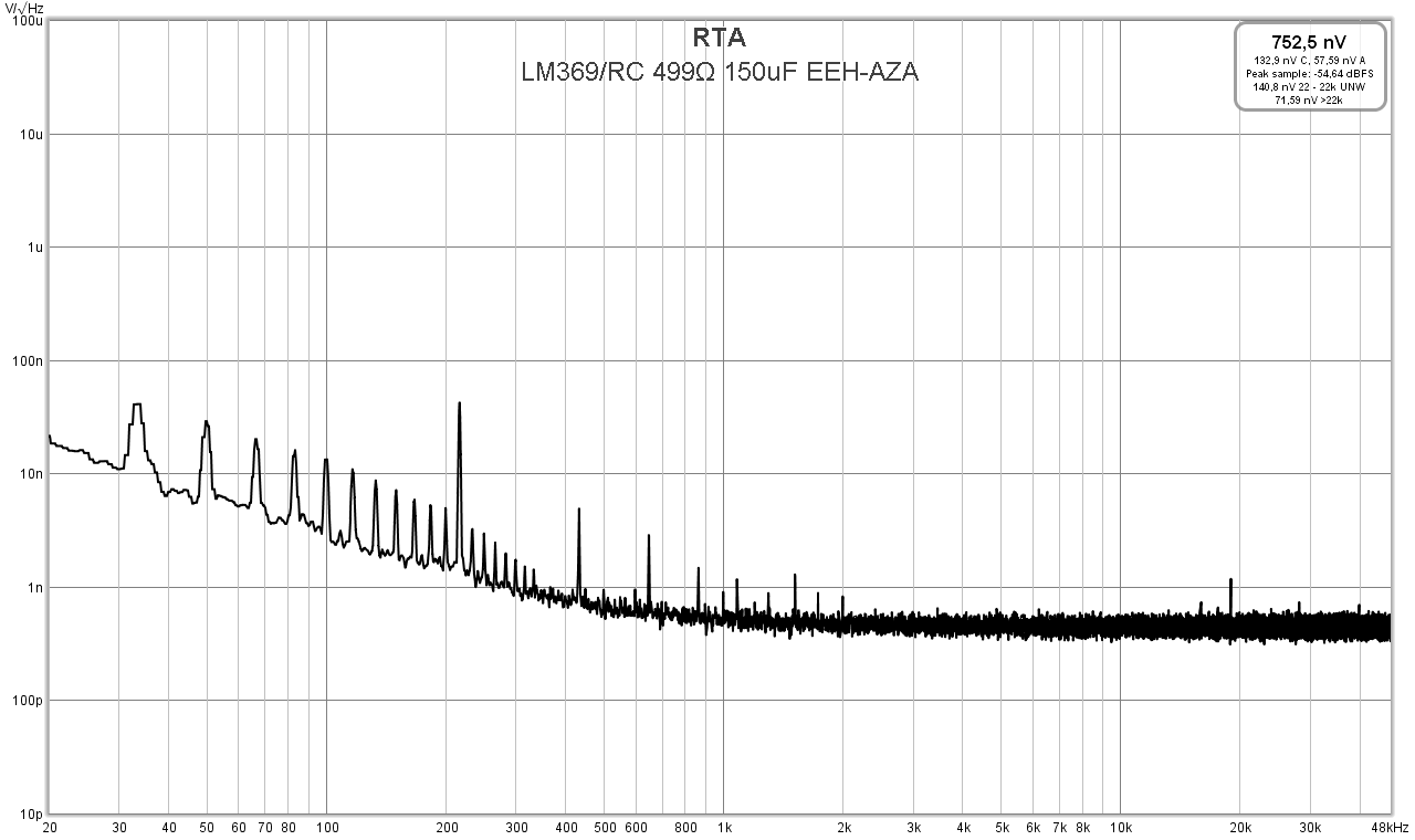

Don’t hold your breath expecting much from UKZ capacitors. They have larger than average leakage. Here are some leakage measurements. All capacitors were measured after 5 minutes with 6.8 V applied. As leakage is proportional to capacitance, and capacitors had different values, normalized value for leakage per 100 uF was calculated.
  • Nichicon UKZ 33 uF/50V – 28 nA (84 nA)
  • Panasonic EEU-FM 330 uF/35V – 25 nA (7.6 nA)
  • Panasonic EEU-FM 220 uF/35V – 12 nA (5.5 nA)
  • Panasonic EEH-AZA 150 uF/25V – 4 nA (2.7 nA)
  • Panasonic EEH-AZA 330 uF/35V – 7 nA (2.1 nA)
Attached are noise measurements of RC filtered LM329 voltage reference. LNA used for measurements has noise floor at 0.445 nV/rtHz.
I’m using now in my super regulator builds only EEH-AZA hybrid polymer capacitors as they are triple L - low ESR, low leakage and long service life.

This is a great information, thanks! Can you please spell out for those of us less advanced, in which positions do you use these caps? Is it C9/C10 or also C3/C7? What is the value of R4/R11 and the value of the caps in your build? (I see the test values on the charts, but which did you choose for the actual build?) Did you change any other resistors or capacitors? Finally, have you tried to see if this makes any audible difference? Thanks again!
PS. It looks like with EEH-AZA 330 uF you get more noise with a higher resistance. Is the difference perhaps due to the resistor noise?
No, at least not directly. The higher resistance produces more voltage noise
but at the same time it lowers the corner frequency where the filtering starts
to work. There is nothing wrong with 22Meg/10uF foil at the input of a
FET amplifier.

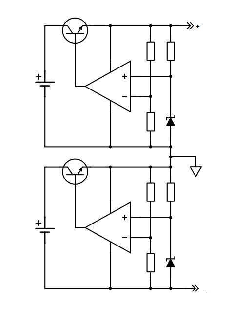

I’m using those capacitors for every position, but my voltage regulators are different, though they are still super regulators based on Jung-Didden essential design principles (picture attached).
For the original design, they can be recommended for voltage reference filtering (C9, C10). They could be good for C4, C8 and all other positions as well, but someone else will have to check that.
For my actual builds, I used 330 uF and 150 uF values with 1 kΩ resistor (different builds).
When measuring such low voltages in the several nV range, environment noise (EMI) can vary results in consecutive measurements. To measure actual LM 329 filtered noise instead of environment induced noise, I had to switch off any AC power in vicinity and especially all switching power supplies and LED lighting. Battery supply for DUT was used as well.

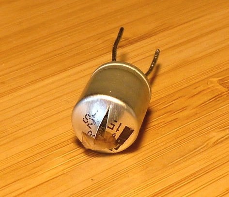

Yesterday, I discovered another good property of EEH-AZA capacitors. They explode gracefully with no smell, spill or smoke. 🤣
One 330 uF capacitor was borrowed from another breadboard circuit on the bench. I managed to return it reverse connected. After some time, I was greeted with very loud and sharp crack.
I have checked the specsheet of the AZA range and could not find the Panasonic EEH-AZA 330 uF/35V – 7 nA (2.1 nA). Can this cap be from a different serie?
Thanx, Ruthless
You are ruthlessly correct (pun intended). 😀
There is no 330uF/35V in the EEH-AZA series. It was 330uF/25V.
Another typo is LM369 specified on the noise measurements, while it was LM329.

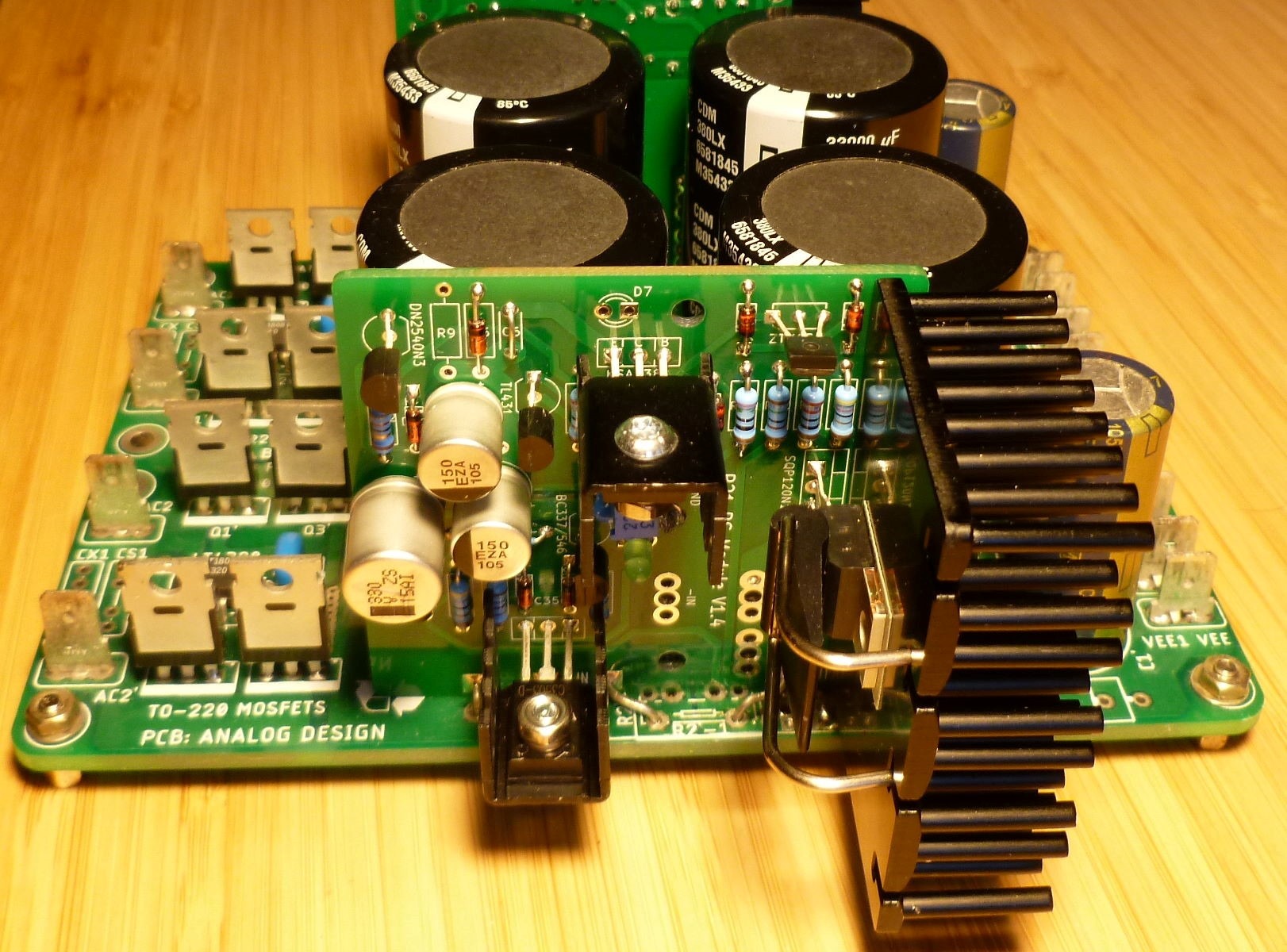

I noticed on your board, see picture #3087 that you are using a 35V/330uF EEH-AZS cap. Did you test this cap as well and how does it perform compared to the 25V/330uF EEH-AZA?
Regards, Ruthless
I went to workshop to check and it was 330uF/35V EEH-AZS after all. 🤦‍♂️
Comparing results of 150uF/25V EEH-AZA and 330uF/35V EEH-AZS, it is evident that their leakage is practically the same.
More important fact is that many recent production capacitors will exceed requirements for a low leakage capacitor in voltage reference low pass filter, explained in the Walt Jung’s article: An_Improved_Reference_Filter_for_Audio_Regulators.pdf
Just look at the Panasonic FM series results,
When checking capacitors for actual leakage, it is good to put some working hours on them. Fresh out of bag, they will have several times higher leakage than after being under voltage for a day. In example, after leaving UKZ capacitors under voltage for the whole day, their leakage dropped to 25 nA per 100 uF.
So, without much headache in finding components, we can use 150 uF/4.7 kΩ RC filter in the super regulator. However, that will result in slowly ramping regulator output voltage, requiring some 3 seconds to reach 95% of nominal output voltage.
