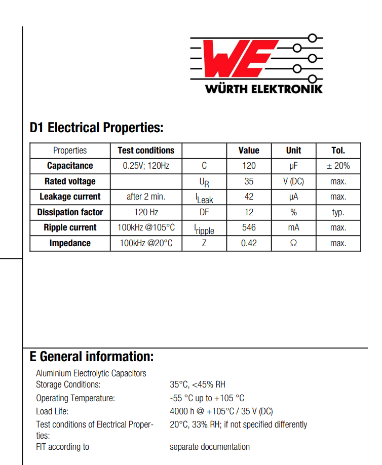

I changed out C3 and C4 and with the OP27 this got rid of the oscillation.
So the wurth 120uF (mouser 710-860160574014) had something to do with it, and I replaced these with Panasonic 100uF (mouser # 667-EEU-FRE101). Happy with myself I thought I would move on to the neg regulator to see how it would go - I swapped C7 and C8 for the same caps. I had left the OPA1611 on this neg regulator - and it worked perfectly, no oscillation.
So then I thought I would go back, take off the OP27, and see if I replaced it with the OPA1611 what would happen - it would be good to know if this worked. Anyway, the answer is no, there is oscillation. Replaced the OP27 and no oscillation.

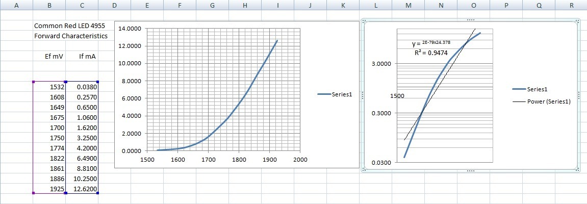

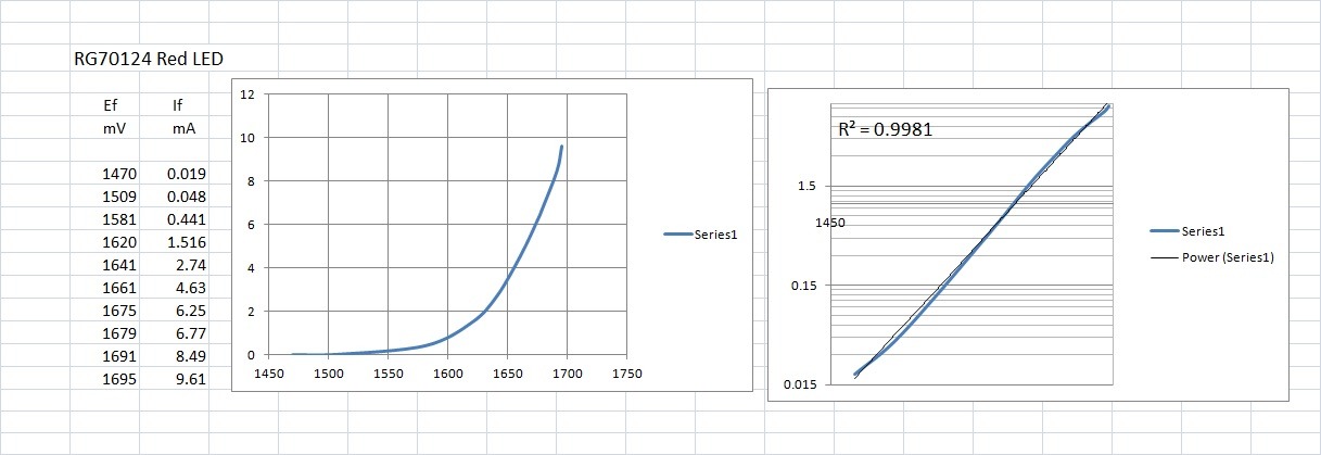

LEDs are just another forward biased SS diode & follow a square law EI curve. For the technically inclined SS diodes have a slope of 2 on a log-log graph while a vacuum diode has a slope of three halves on the same graph. And an ordinary resister has a slope of one. Tunsten lamps run around a slope of 0.7-0.8.

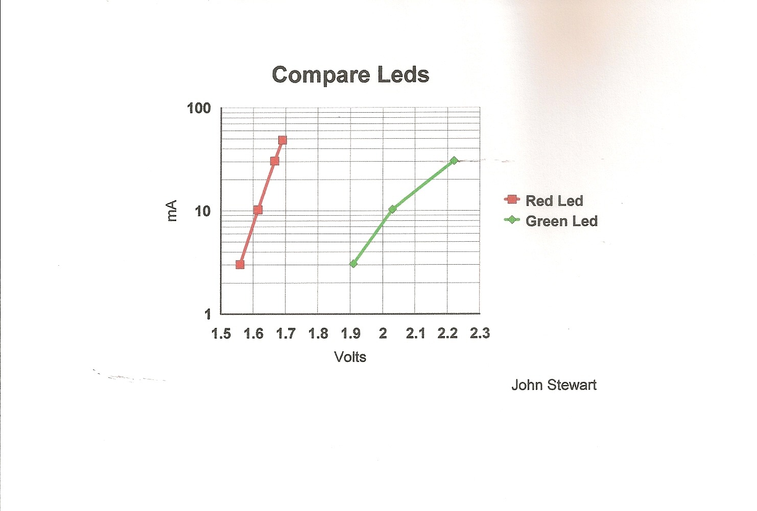

And has anyone ever measured that LED noise in a carefully controlled experiment talked about a lot here on DIY? Can we please see the results, have they been published? And why do people use a non-linear device to bias a tube?

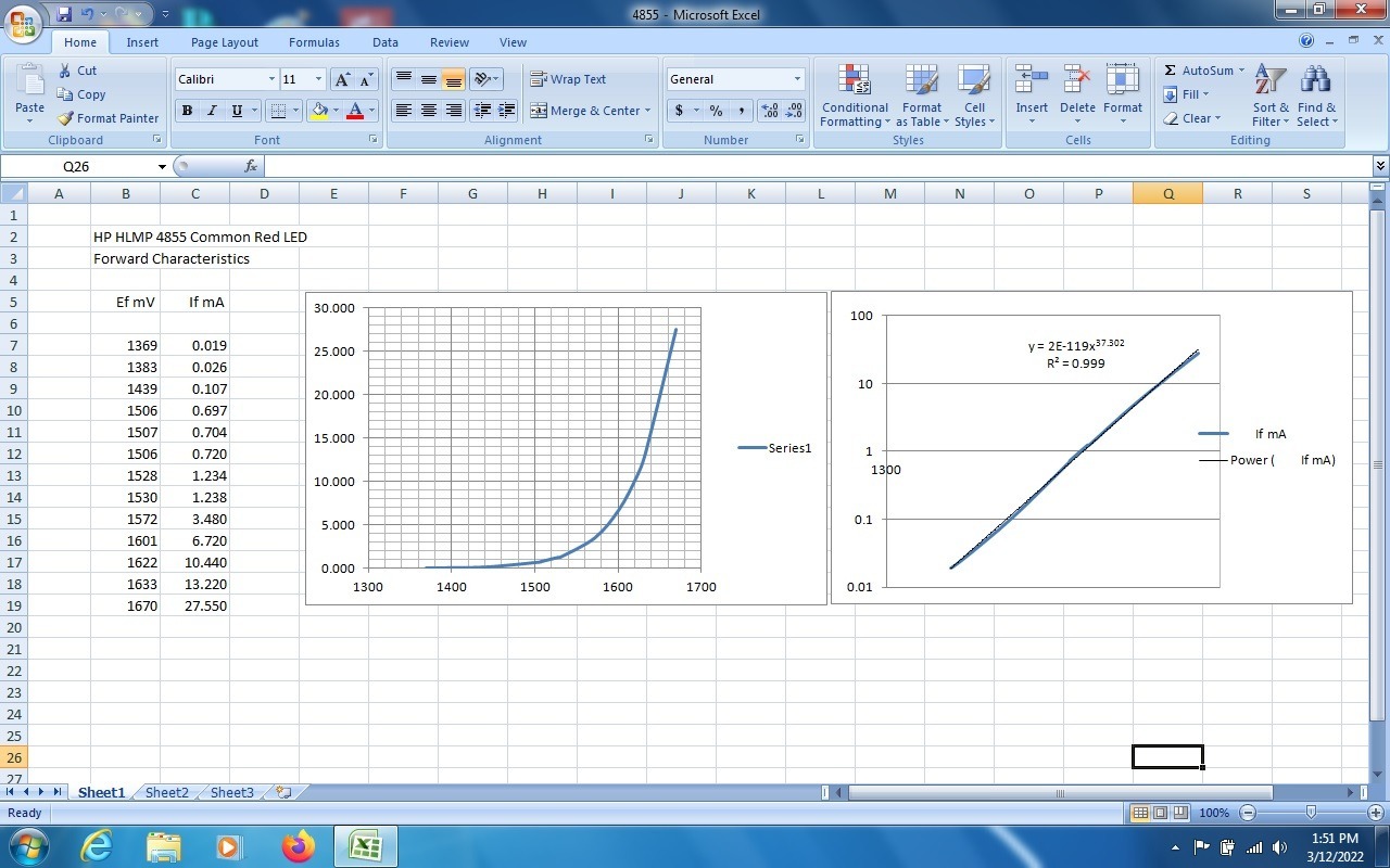

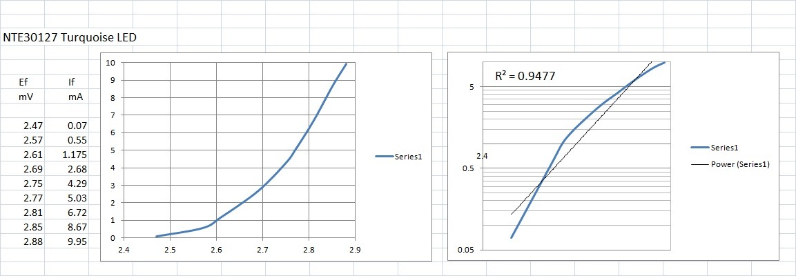

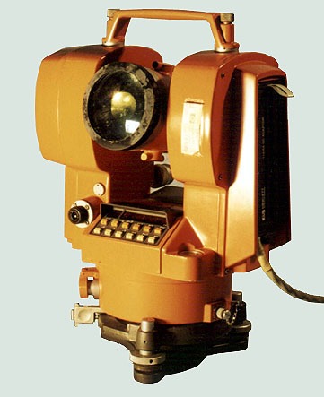

HP used the high power IREDs in equipment we sold for Land Survey & Civil Engineering. These were sourced from Monsanto.
The IRED was modulated so that the time of a reflected IR beam could be used as a measurement of distance,
Angle was measured by an optical glass disc in the base of the instrument scribed in Gray Binary code.
All microprocessor controlled. And for ~3yrs I went to work wearing Jeans, Safety Boots & a Hard Hat.
And traveled the entire country, 👍
