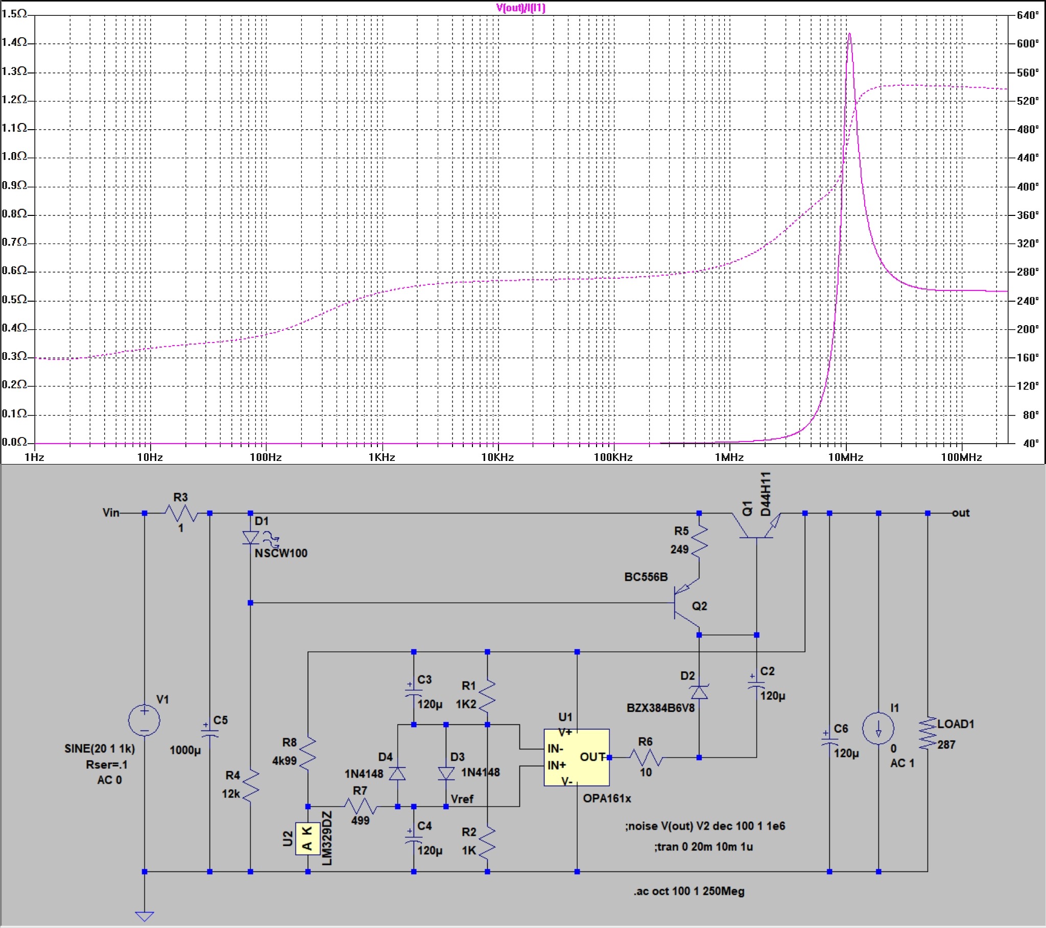

OK, here's the SR impedance sim, using the OPA1611, which had given the best/lower impedance results until now. As you can see there's a 1Ohm peak @ 10MHz, which might be considered small, and then goes and stays around .53Ohms until 250MHz.

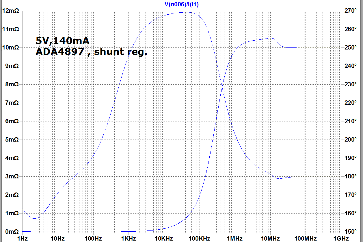

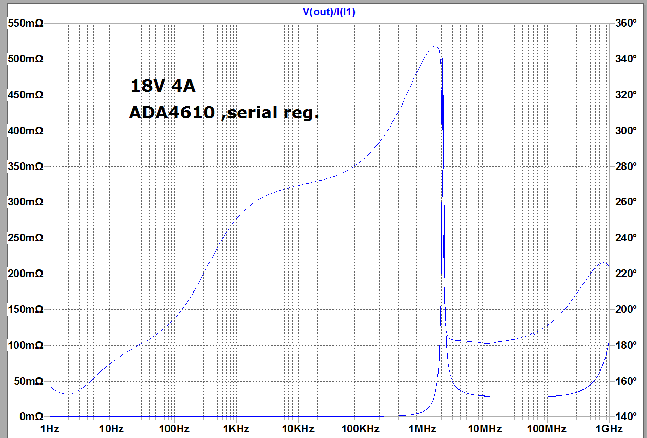

Just for comparison, I am attaching my two simulations, both regulators work in my audio system, serial in the amplifier and shunt in the DAC. I've mentioned both in posts before.

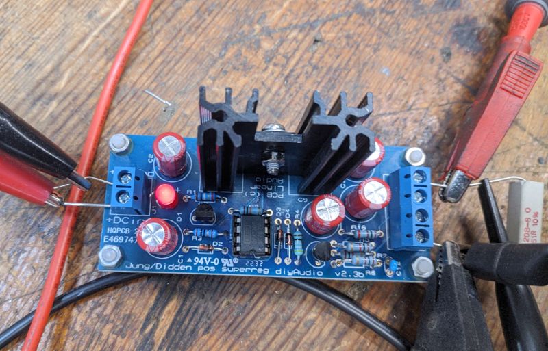

I think I might need a little help here.
So I am building the positive super reg first - and I'm seeing oscillation under load. No oscillation with no load.
Some details of the build:
Aiming for 12V
Used LM4040diz-10 for the reference diode
BC556BTA
D2 zener is 6V8
I used the table quoted just a few posts above to set R6 at 100R, R7=1k
I also was mindful of the PDF from Jan Didden to make sure enough current flows through the LM4040, so I decreased R5 to 1k, (12V target -10V reference =2V, and 2mA then needs 1k).
I had some OP1611AIDR - and have installed that (and maybe this is my error) - although as posted a few posts above, this "should" work.

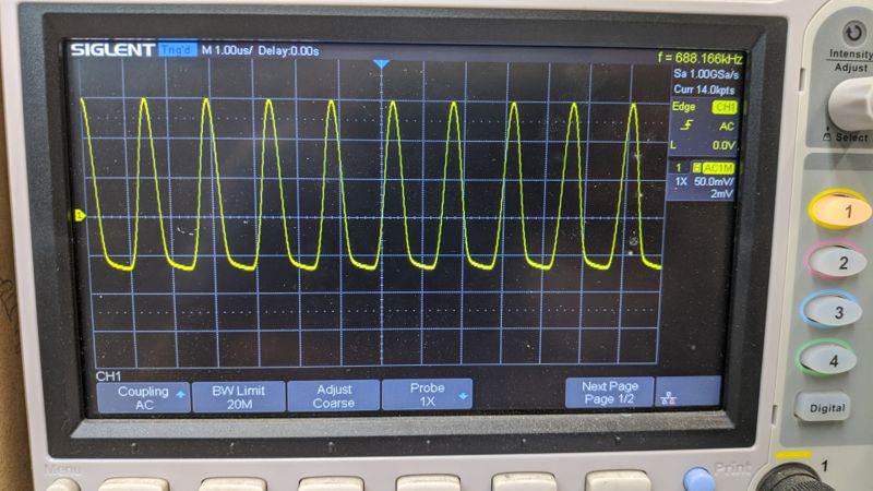

Anyway, power is from a bench supply set at 20V, target voltage with load or no load is just at 12v, so great stuff. But loaded with 51R resistor, 270mA I see oscillation at ~5mHz.
What would you gurus suggest to tackle this first? I'm not awash with opamps, but have some LM6171, OP27, NE5534, AD820
Fran

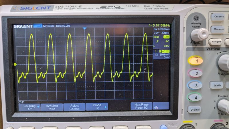

Ok, so a change to op27 changed the nature of the oscillation, much slower but still there. Back to trawling through the articles for me.
If anyone sees anything wrong with my build, please do let me know.
