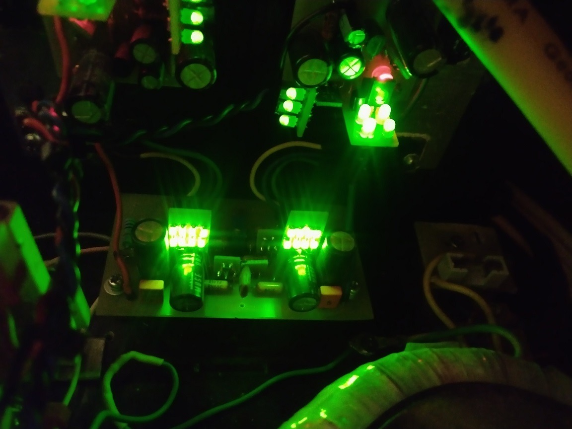

You didn't read my post 2952, the LED reference is already finished and tested(even PCBs), I currently have 14 of them in my audio system from 2.5V to 9V, and I made four 16V for Hiraga 20W A-class and even a 180V version for HV regulator but with zener diodes because who would solder so many LEDs. 🙂The option to use series LEDs as references hasn't yet been quite analyzed in this forum. Least of all build an SR and measure it to see what you get. On simulations it seems to do fine, but noise is still an issue.

The LED version will be low noise and with the zener precise reference, I don't know when Walt will announce it yet, but I will give a hint here on the forum.

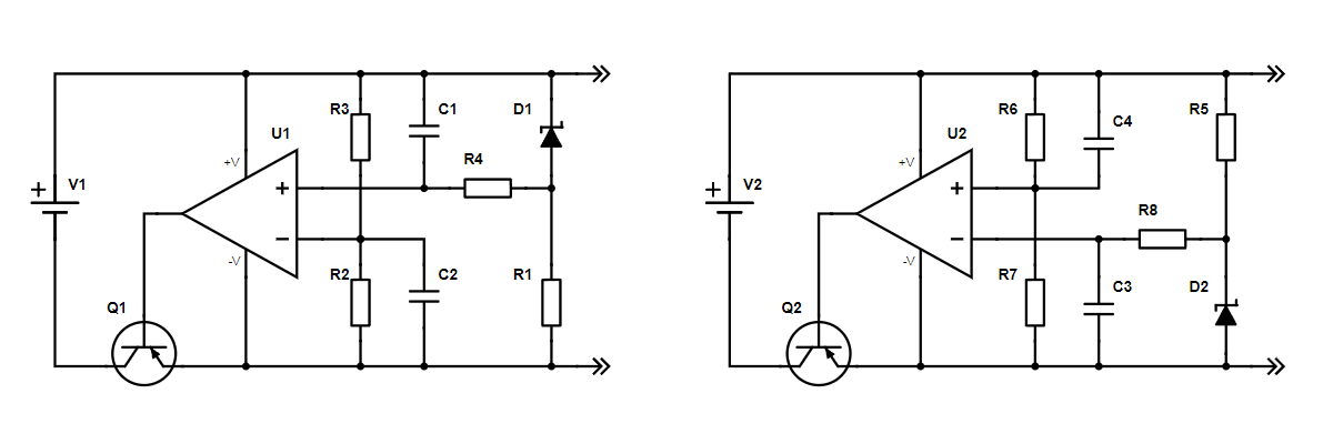

Hello everyone,
I have a quick design question. I'd like to use low noise series voltage references in the Super Regulator, but it is impossible on the negative side without modifying the circuit. The diagram on the left is the (highly simplified) negative Super Regulator where using a series reference instead of the zener is generally impossible. The diagram on the right is a modified (mirror flipped) circuit where a series reference can be used.
My question is if this modification will work and if any concerns exist with the modified circuit (performance, noise, etc.). I would appreciate any insight.

Thanks Rick, I am familiar with Jan’s article. My circuit above on the left is his negative circuit where a series reference cannot be used. The circuit on the right is modified to allow the use of a series reference. Please notice that the reference is connected to the inverting input if the opamp. So no change of the transistor flavor is needed.
