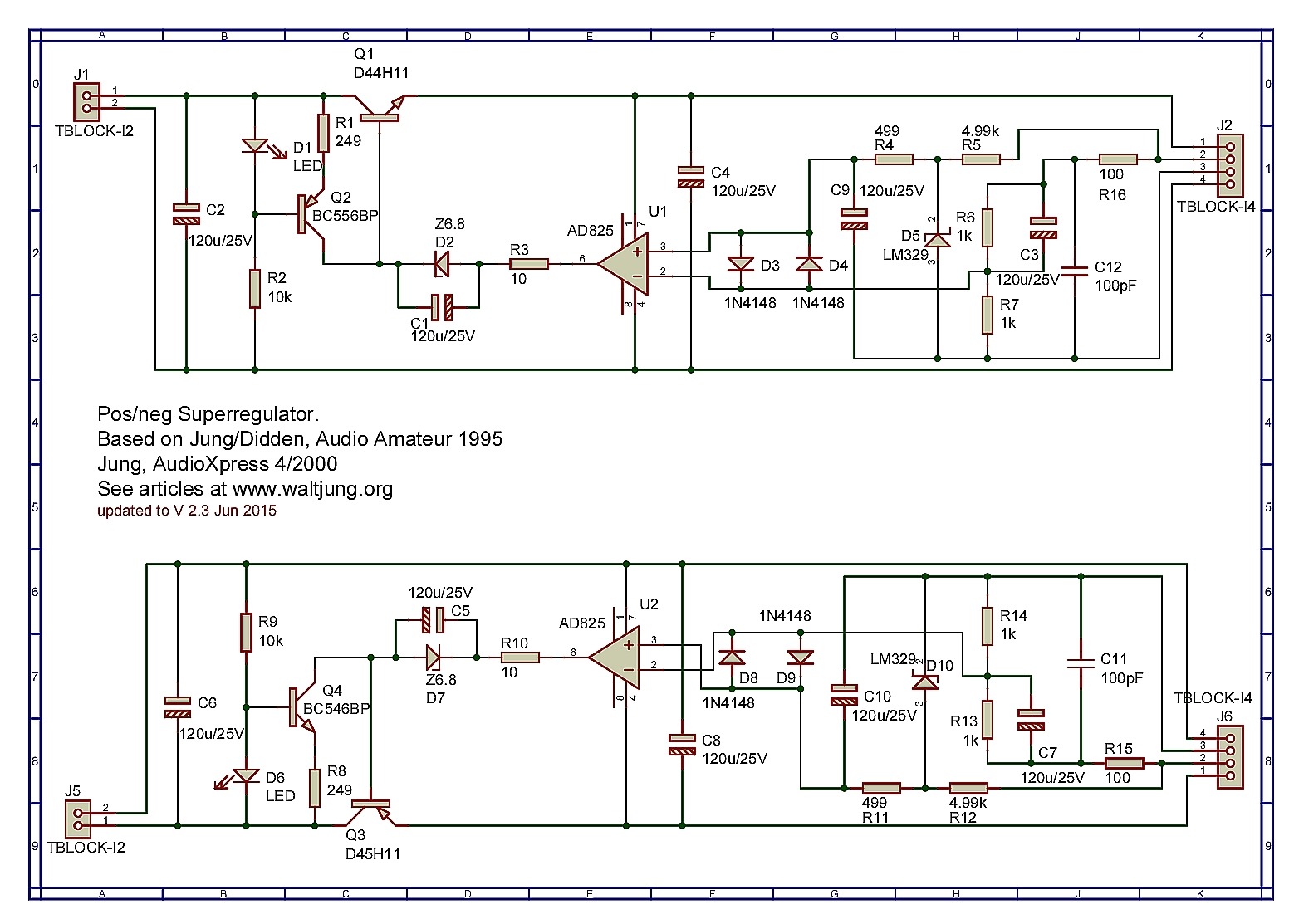

What are the voltages on D5/D10? Also, are the outputs connected to the senses? On Jan’s 2.3 diagram, the pins of J2 should be connected 1 to 2 and 3 to 4. Also similarly the pins of J6 also should be connected 1 to 2 and 3to 4.
To make sure my statement is clear, do NOT connect any J2 pins to any J6 pins. The connections should be like this:

The voltage on D2 is incorrect. It should be 12V. Check the polarity of this zener again. Note that the polarity if this zener is different between the positive and negative regulators. This however may be only a symptom of the opamp inputs being out of range.

It will work with these links, but the sound quality will improve if you remove the links at the J2/J6, run all 4 wires from each output to the load, and connect the same wires at the load instead of connecting them at J2/J6. I use twisted pairs: 1 and 4 is one pair, 2 and 3 is another pair. The latter pair (2 and 3) ideally should be shielded and the shield grounded, but it should work even without the shield.
Just for the record, I'm uploading the original latest Didden SR schematic. It will be easier to check all parts and connections above. I don't remember them all.

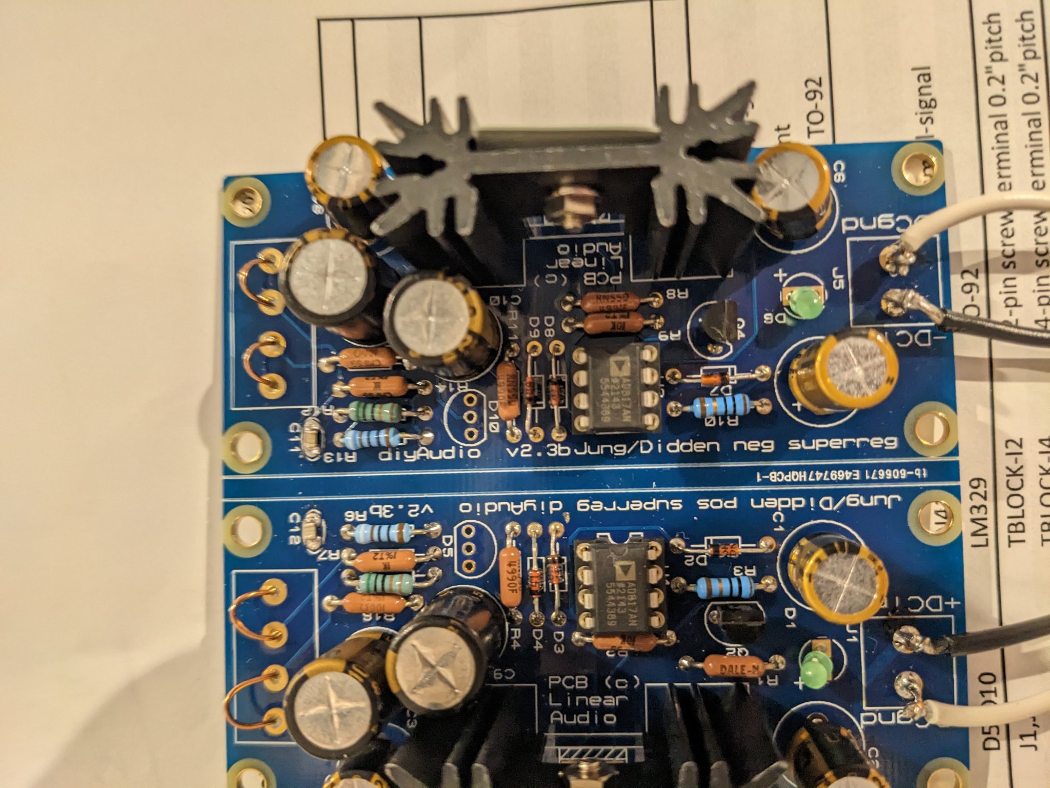

I would like to have advice.
I built +/-5v super reg but negative rail has only -4v output.
I checked resistors again but couldn't find my mistake.
I use 5K for R1,R8
910 for R6,R13
1k for R7,R14
2.5v zener for D2,D7
Q2=BC556C Q4=BC546C
AD817
