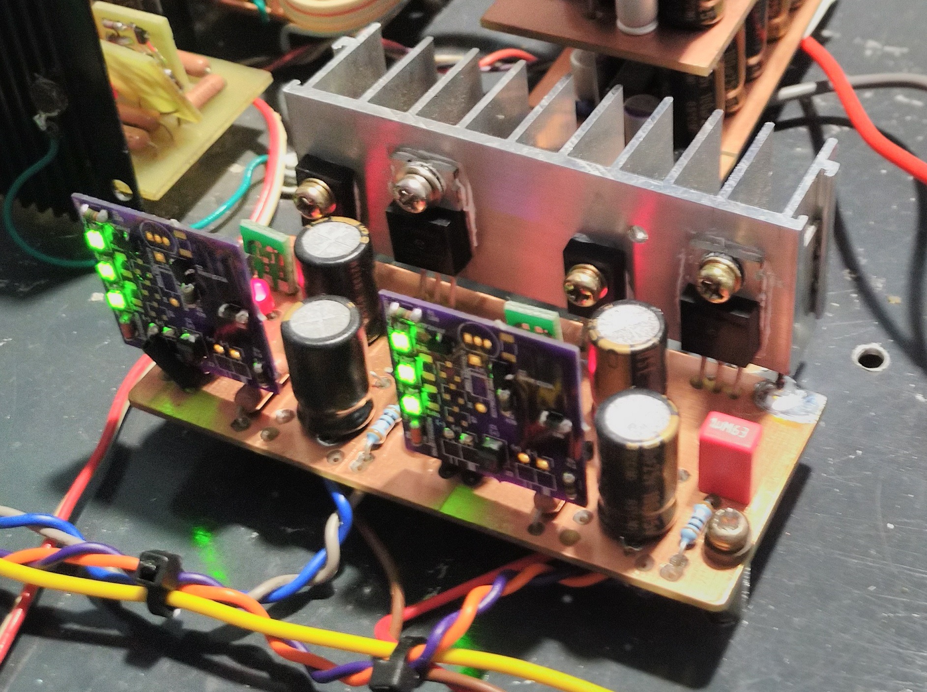

OK, so I now have two super regulators working in series: 32VDC raw into the first reg with 24 volts out into the second reg with 15 volts out to the load. What I did notice that with that 32 volts in, trying 20 volts out produced lots of overheating of the IC. 24 volts out cured that.
As to the sound, It sounds better to me. I'll leave it at that.

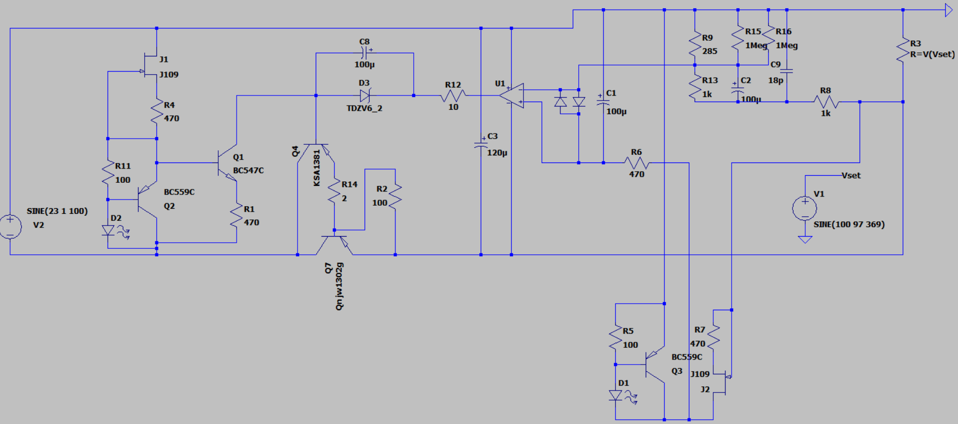

I have a question about a high current version. Beacuse i could not cover a whole load from 0 to 5 A from a pass transistor driven directly from opamp, i decided to use Emitter Follower/Darlington to buffer. I simulated this version and it seems to work well.
I noticed however, that on the schematic from grunf, he uses his buffer transistor BEFORE zener // capacitor. I use it in classic darlington conf, i.e. with driver transistor after ther Zener.
The diffrence is the amount of current going through the 6,8V Zener and it`s parallel 100uF capacitor. In my version, the swing through the Zener is of 0,15 mA, whereas in Grunf`s version it`s in the range of 20mA.
What configuration is better for the speed, noise, or output impedance of the regulator, i.e. overall quality ?
  • Superjung plus.asc
    Superjung plus.asc
The Zener doesn’t significantly affect the speed, noise, or output impedance for several reasons, particularly because of the filtering capacitor. The current should be in the working range of the Zener. Check the data sheets for the test current.
While on this, what is the purpose of R8/C9 and how do you calculate the values?
Also, if your output is 20V, shouldn’t the Zener be closer to 11V than 6.8V?
R8/C9 on my schematic do the same what 220R/100pF did on original schematic for Super Regulator. I changed the voltage reference for 2,5V instead of 6,9V from LM329, hence i had to adjust the voltage divider from remote sense point. I run out of LM329 and went with GLED from Walt Jung with some mods (red led, bc559 instead of ESD unreliable ztx951 and jfet CCS to set up the current through the refererence to about 10-11 mA, split in half between bc559 and RLED).
I calculated the RC filter point from original schematic and recalculated (reduced) the value of the capacitor for higher resistor to stay more less in the same region of remote sense filtering.
After reading some more info about the optimal Zener current and lowest noise, i found that original 6,8V is the worst i could go with (highest noise). Also Zeners seem to like more current through them. I can change now for 12V in the same package, since i ordered the pcb already, and 12V according to Diode noise measurements from this forum is actually quiet. I should also burden the Zener (and opamp) with more current, and think about additional 1k resistor from output to the base of driver transistor KSA1381.
I considered once a string of 3-4 LED forward biased as supposedly quieter, but without darlington transistor, i had a swing of 5000mA/120beta= 0-42mA through them, and thought it to be too much, not to mention the parasitic photoresistor effect between blinking LEDs.
Now, in search of "absolute best", i consider using NiMH batteries to offset the output voltage of opamp. The offset is, according to the 4 original articles about the regulator, not that critical as long as it gives enough headroom from supply, i.e. could be 6,8V, 5V or 12V. I did run simulations with as little as 2,4V battery offset (2 x 1,2V NiMH cell) and with 25V input and 1V ripple, and load from 50mA to 6A, opamp seems to work fine. I aim for 18V output and did notice that regulator really needs at least 5V offset from the input to work well. Beacuse of wild mains voltage diffrencies (photovoltaics), i see from 213 to 253 V in my socket, and cannot go with the regular transformer and bridge rectifier. 2x 24VDC 10A SMPS i bought very cheap off ebay are surprisingly quiet under heavy load (my analog Tektronix barely triggers, i doubled checked agains other noisier SMPS), so 24-18-5V offset give me still 1 Volt of headroom for heavy choke coil filtering.
