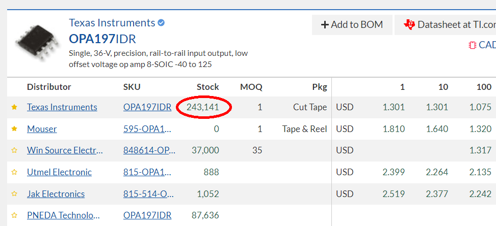

Octopart.com says there are plenty of parts for sale at Texas Instruments' web store. Image #1 below.

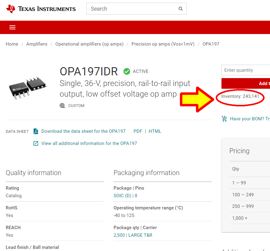

I logged in to my account at the TI store to double check. TI agrees with octopart: plenty of parts on the shelf. Image #2 below.

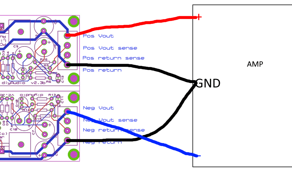

Hello, is me again and i hit 2 roadblocks. I cannot figure out the Z6.8 D1/D7, if its 6.8V Zener then im stupid and excuse me. Second problem is that i wont be able to get LM329's but found the PM829 which uses 2 1N5234B diodes back to back as a replacement. I'm asking if any modification have to made to the board to house the replacement. Thx in advance.
(Figured out that the sense wires go with the power wires)

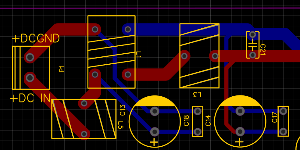

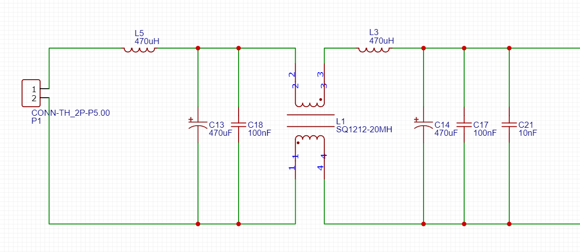

Thanks for answering Jan, but i'm back with one more question if you don't mind. How much problem would a 2 stage LC and an EMI filter would cause in front of the super reg?

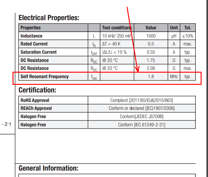

If and when I include a series inductor in a DC supply, I try to find out that particular inductor's "self resonant frequency" . Either by looking it up on the datasheet, or by attempting to measure it on the bench. Then I attempt to devise damping circuitry that will lower the resonant "Q" below 0.5, so the inductor won't oscillate/ring at its self resonant frequency.
Perhaps this is needless paranoia, but the cost is usually very small, while the benefit (peace of mind) is, for me anyway, quite large.
