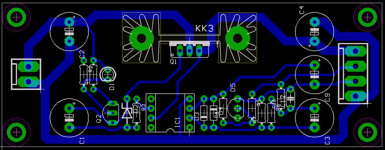

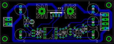

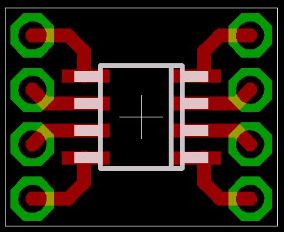

Hello, everyone,
I want to build a pair of boards myself.
That's why I tried to get the layout one-sided.
Do you think there are any downsides or limitations to be expected from the layout changes?
Thanks and greetings Martin

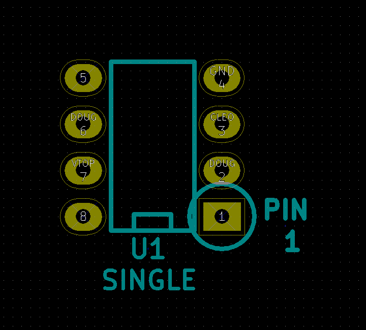

The thru hole footprint for IC1 doesn't quite look correct -- it appears, visually, to have excessive spacing between the two vertical rows of four pads-with-drill-holes.
For reference, here's a footprint of a DIP-8 opamp on a PCB I designed recently. Blue is the top silkscreen (comment text) layer, and gold is the solder pads which are on both top and bottom copper layer. I've had boards built using this footprint, and it perfectly matches DIP ICs and DIP sockets.

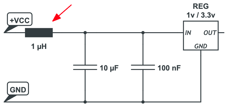

Another question... following the thread I noticed that film and ceramic capacitors are not allowed in the regulator... but,
at load they are not a problem, due to the resistance and inductance of the cables, right?
Sometimes we have small 3.3v/1v regulators in the load... and they have an LC arrangement (attached image).
Should this inductor be removed and keep only the capacitors?
