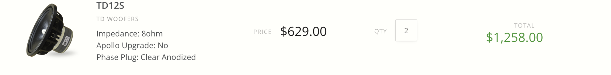

For anyone reading, I think in my case, the best action would be buying a pair of Faital 12RS430 and measuring them. And if they are not what I'm looking for, AE TD12S looks like the niche driver that nobody wants to do anymore. I couldn't find an alternative to it here in the EU.
With current prices, you are going to pay a fortune to get those 2 drivers to Portugal.

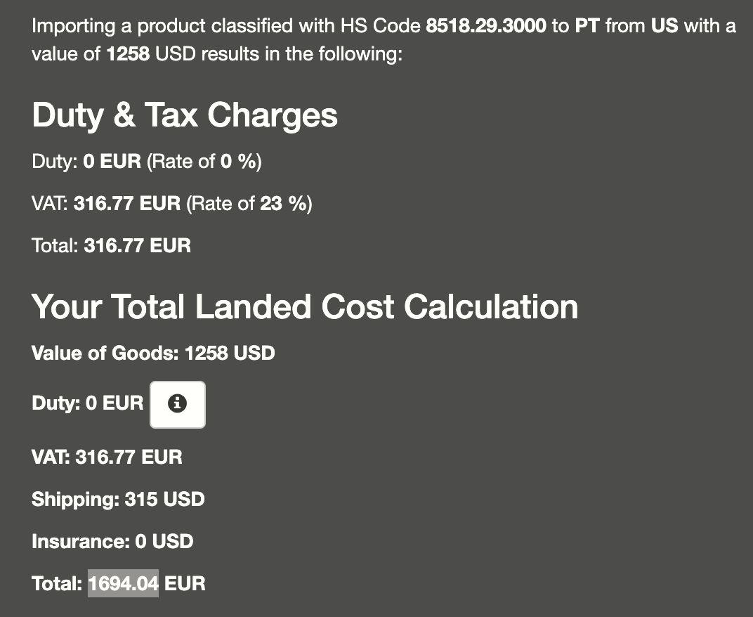

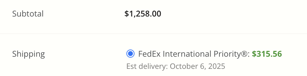

Here's a detailed breakup:
And after taxes:
So basically 847€ per driver.
The AE drivers "only" make sense if you want to take advantage of the extended midrange.

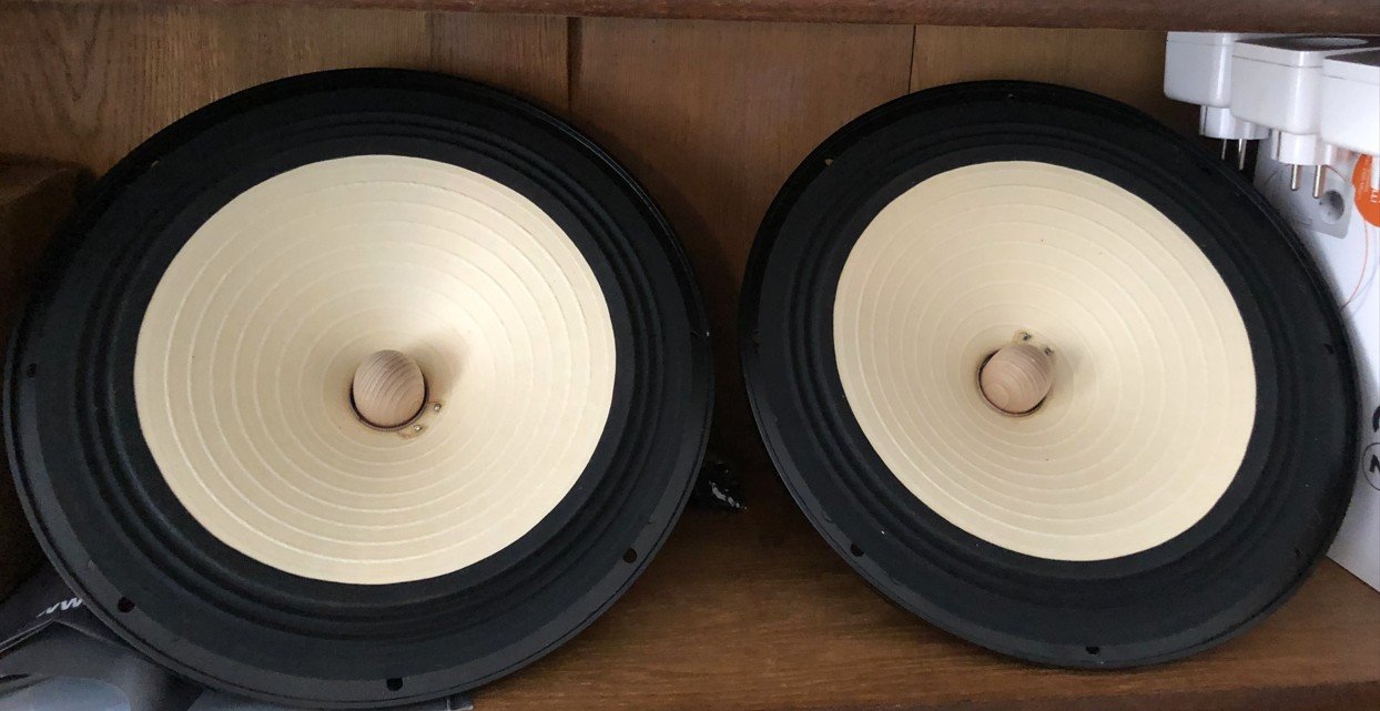

i like very much the custom builds of Istvan in Hungary www.sonido.hu
hope it helps, Stefano
this one have the highet Qms / lowest Rms value i have seen for the size, custom build with phase plug but no whizzer cone and capton voice coil carrier instead of aluminium voice coil carrier

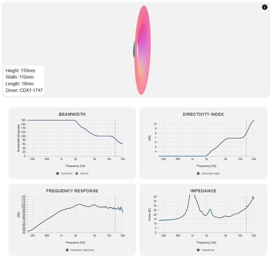

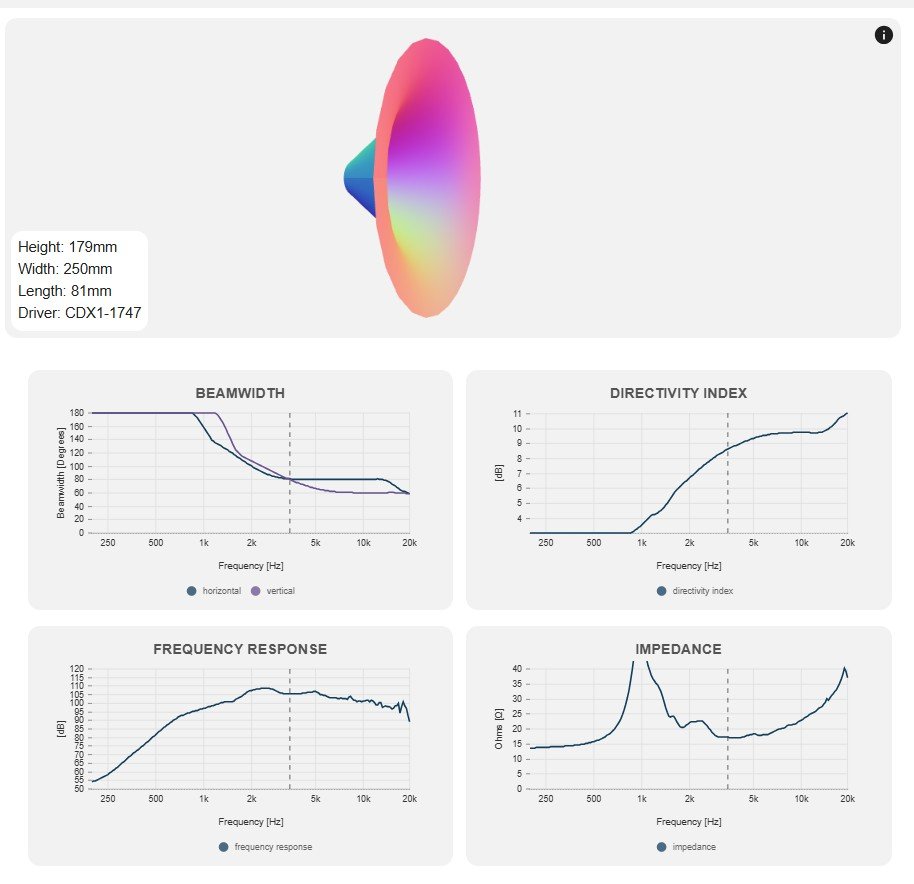

my problem was the quite high directivity index in the treble region, the small tractrix wood horn with only 110 mm horn mouth diameter is much less beaming than the much larger horn mouth of the XT1086 horn with the elliptical 250mm x 200mm mouth size
to check how a horn behaves with beamwidth and directivity on the frequency axis you may want to check out this one
https://celestion-horn.netlify.app/
here the example what the CDX1-1747 will do with the elliptical horn parameters of the XT1086 and the small circular wood horn
i have CLIO Pocket measurements - never seen a better transient response behaviour than the 18sound NSD1095N driver with the small wood horn above 2200 Hz
