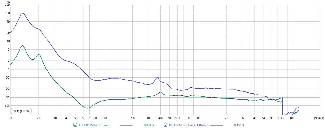

Unless you really need the high sensitivity, have you considered the Purify tweeter?
- https://ptt.purifi-audio.com/shop/ptt1-3t04-hag-01-ptt1-3t04-hag-01-wg104-2088
Have a look at the Purify tech data, you may find it interesting 🙂
- https://purifi-audio.com/blog/tech-notes-1
And more specifically:
- https://purifi-audio.com/blog/tech-notes-1/spk16-reference-design-12
Amplifier power is so good and cheap nowadays, that for home use, the Purify combo may be the best available high-end option right now.

Purifi is the more modern style, but is way less sensitive so harder to match to a compression driver in horn. It would indeed be better to use a dome tweeter in waveguide to match this driver.

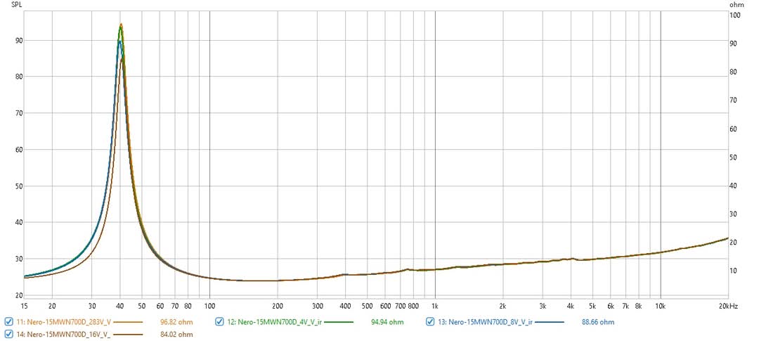

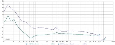

SB 10MWN600D?
15MWN700D? (Pics below).
THPL (France) is the only dealer.
Not really, LSV in Germany fx.
That's exactly what I'm thinking. Better with a dome tweeter due to low sensitivity. Kills the purpose of using horn (Having watt available doesn't mean they play nice together...)

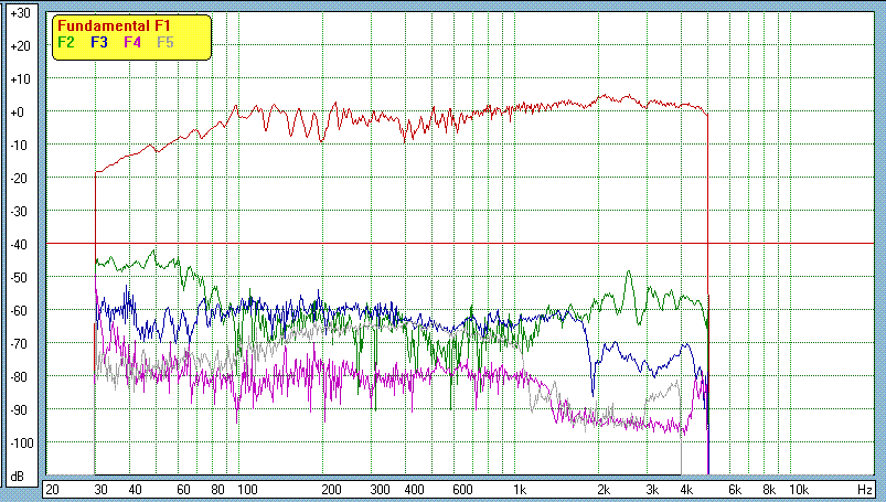

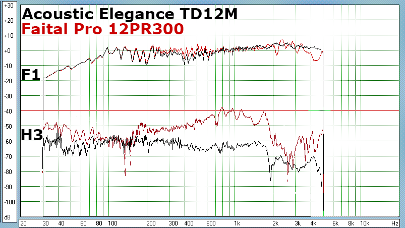

You can check a comparison with some known 12" models here:
- https://www.facebook.com/aespeakers...ference-yesthis-is-a-quest/10153778505096866/
And the full driver vault data can be found using Wayback Machine:
- https://web.archive.org/web/2020103...vault/driver-measurements/tang-band-75-1558se
Thanks a lot for these.

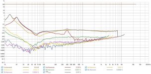

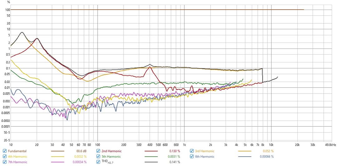

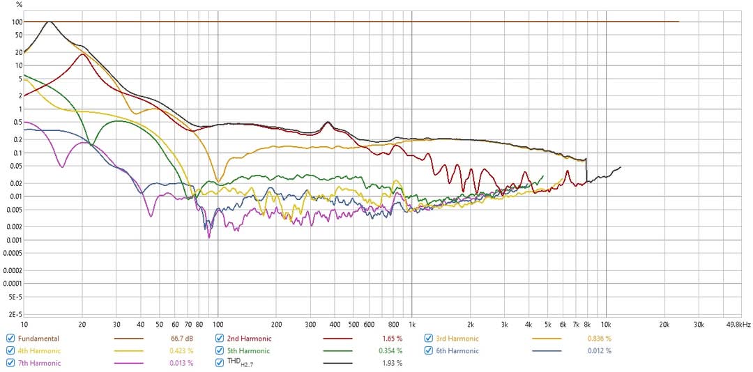

Boy! AE smokes the old Faital.
I really started to worry about RS430's THD.
This is again TD12M. I wonder how it's different from TD12S, but in any case, the THD is below -60 dB on most frequencies, and that's 0.1%!
I don't know how much THD is too much, but 1-2% vs. 0.1% tells a lot.
