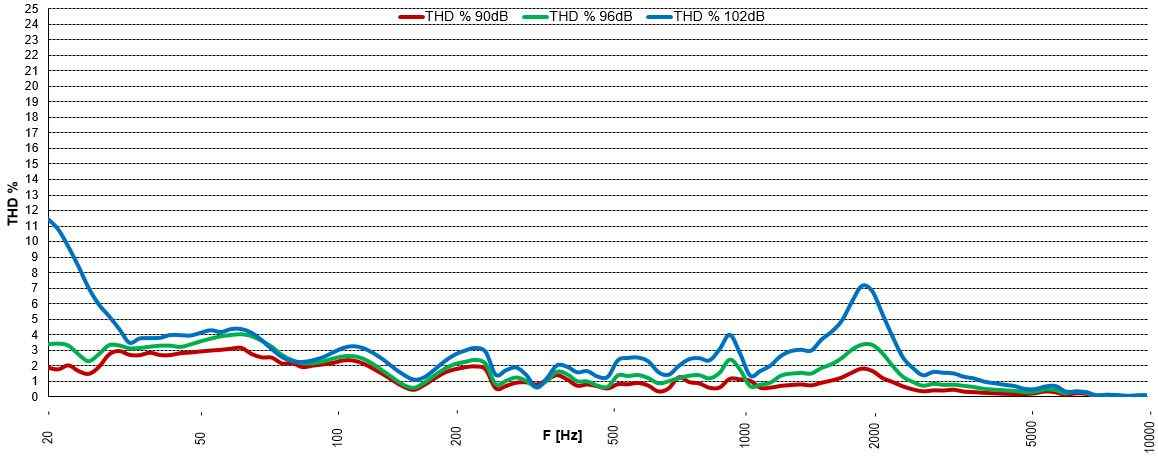

I would choose the 12RS430 too because it goes lower, xmax is higher and more power handling.What do you think?
Are you sure?xmax is higher
Faital, Satori, Sica etc. xmax numbers are just calculated based on depth of gap, VC length etc. for 70% BL = xmax.
But there is no way to know what the suspension allows for linearity etc.

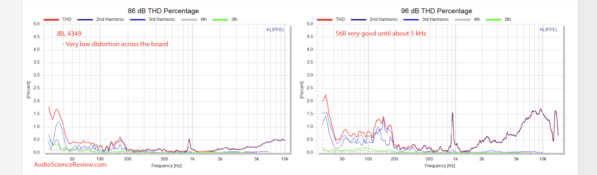

The Kartesian data is verified with Klippel and the data is accessible.
Also the inductance is more linear and better "controlled".

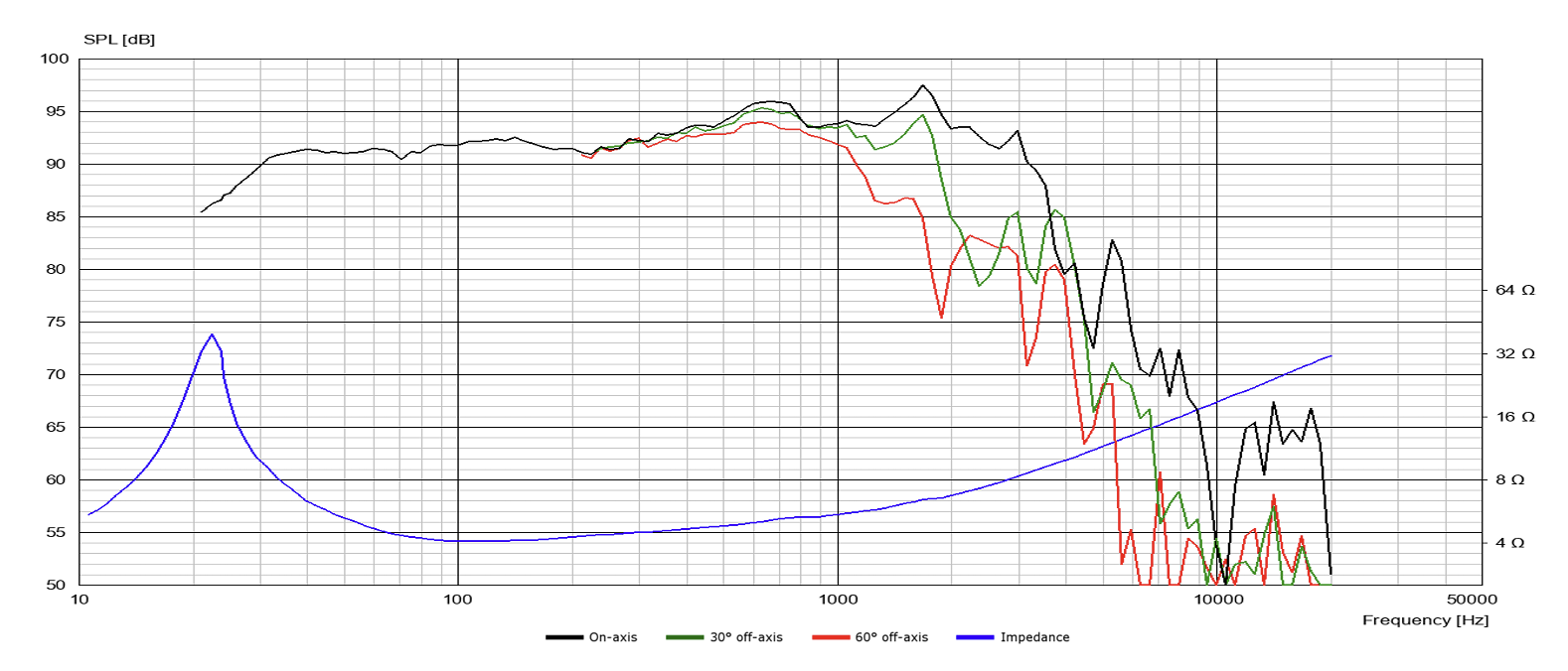

Any thoughts on Scanspeak 32W/4878T01 crossed around 800 Hz with LR4? 60 degrees seems to fall off pretty quickly

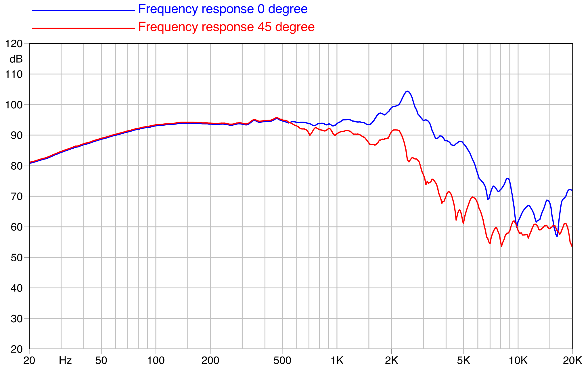

Faital 12RS430 for comparison (although red above is 60 degree, here it's 45 degree...)
