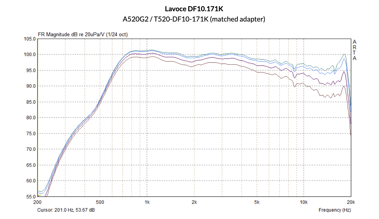

He might be right, but it depends on the horn. The horn I first thought was Marcel's beautiful A40G2 with a matched throat for 1 inch Lavoce DF10.171K, I saw many real measurements, and they were almost just perfect for analog xover. Here are the measurements from the ATH website:in the last few months there was a quite professional DIY audio magazine in Germany - HobbyHiFi from Bernd Timmermanns - with a couple of high sensivity speakers builds, he called the whole story "PA meets HiFI"

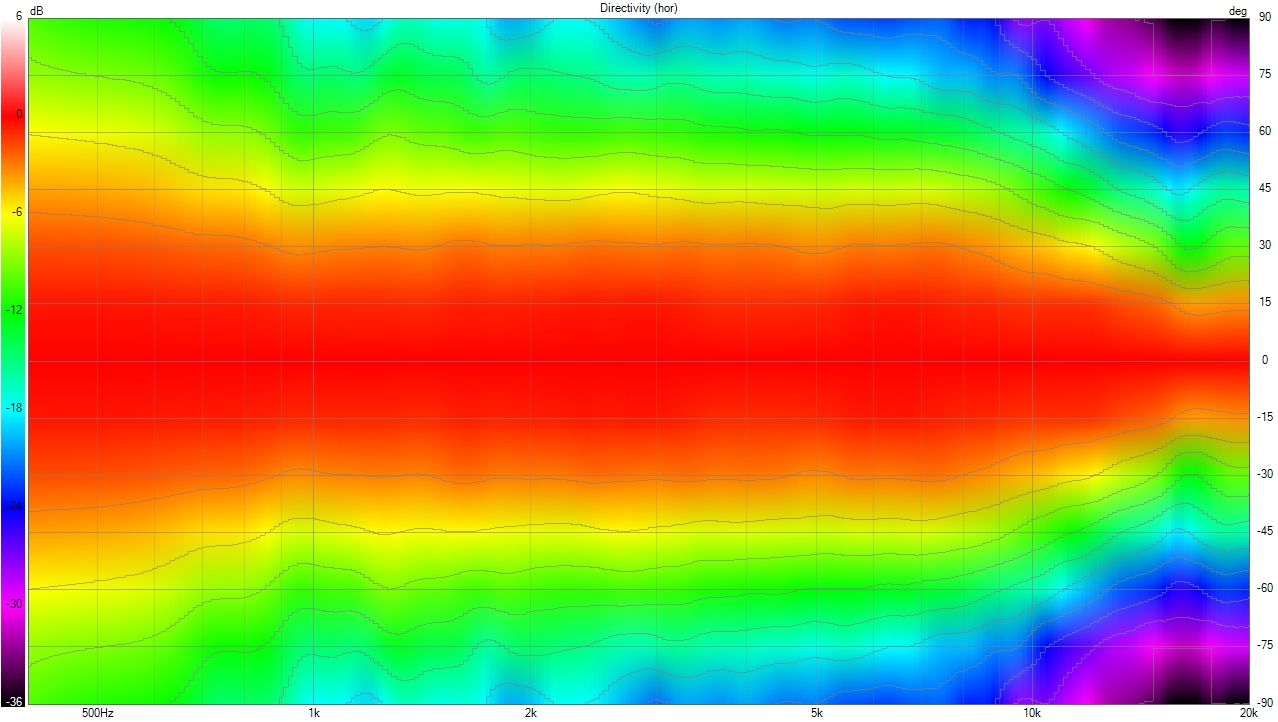

Then I changed my design and considered Xhorn, so I opted for a 1.4-inch compression driver, Faital HF1440 - so the problem is high-end. Well, it's not perfect, but it's more than good enough. Here is the frequency and directivity, from xhorn's website:
I can fix it with DSP easily.
I think narrowing above 10 kHz is not a bad thing; no need to excite the room.
I'm on the edge with both options, 1.4-inch going up to 20 kHz, and 1-inch going as low as 1.2 kHz. I'm no expert, so I can only buy and measure. Ofc, I want the lowest THD with the most natural sound and minimal DSP...

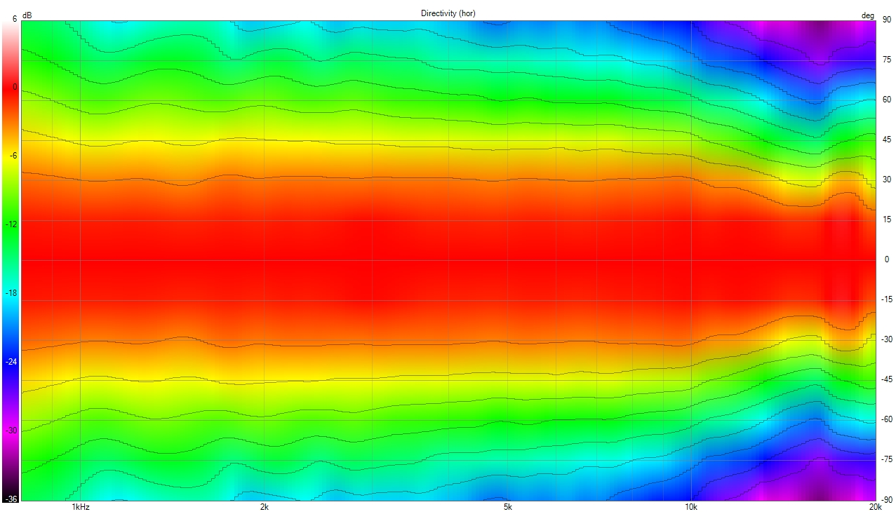

Here is the directivity of ND1095N on Xhorn (33) for reference.
Maybe change the horn inside the cabinet and make it a 2-way? I don't count on myself to match the directivity of more than 2 drivers. That's why I don't even think about doing 3-way (unless the 3rd driver is a sub bass...)my problem was the quite high directivity index in the treble region, the small tractrix wood horn with only 110 mm horn mouth diameter is much less beaming than the much larger horn mouth of the XT1086 horn with the elliptical 250mm x 200mm mouth size
I'll check this, and if I choose 1-inch, maybe NSD1095N is the right driver. What do you think about its sound? What are your subjective comments?to check how a horn behaves with beamwidth and directivity on the frequency axis you may want to check out this one

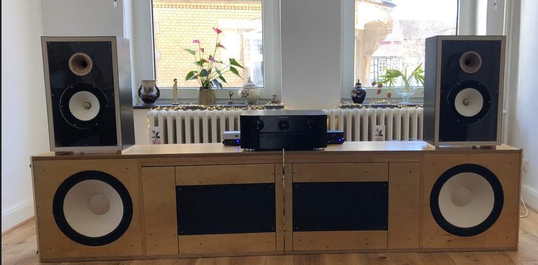

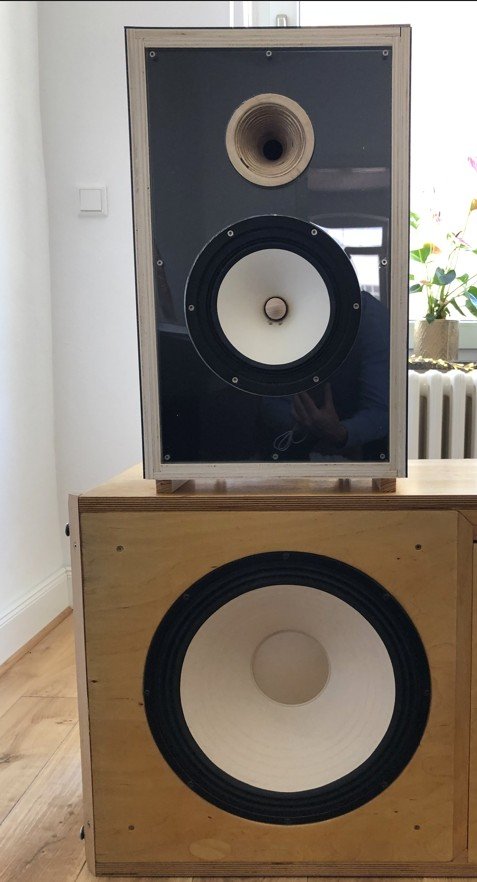

this was some years ago the next iteration of the high sensivity speakers in the living room
with two 2X4HD miniDSP's and the Marantz AV receiver as 6 channel amp, probably the cleanest build i have ever made
Sonido SCW400 as subs, Sonido SFR200A custom build with no whizzer cone for the low-mids / mids and the NSD1095N with the 4.5 inch circular wood horn as the tweeter
have more fun with your project, Stefano

It looks great! Those Sonido woofers are interesting. I checked them after you wrote about them in a few posts.
I started to question why would I need a horn from 2-3 meter distance in a small living room. It’s all below 90-95 dB - even the most demanding peaks. Or am I wrong?
Wouldn’t a dome tweeter with a shallow waveguide would be more suitable? (when crossed between 1-1.5kHz)
