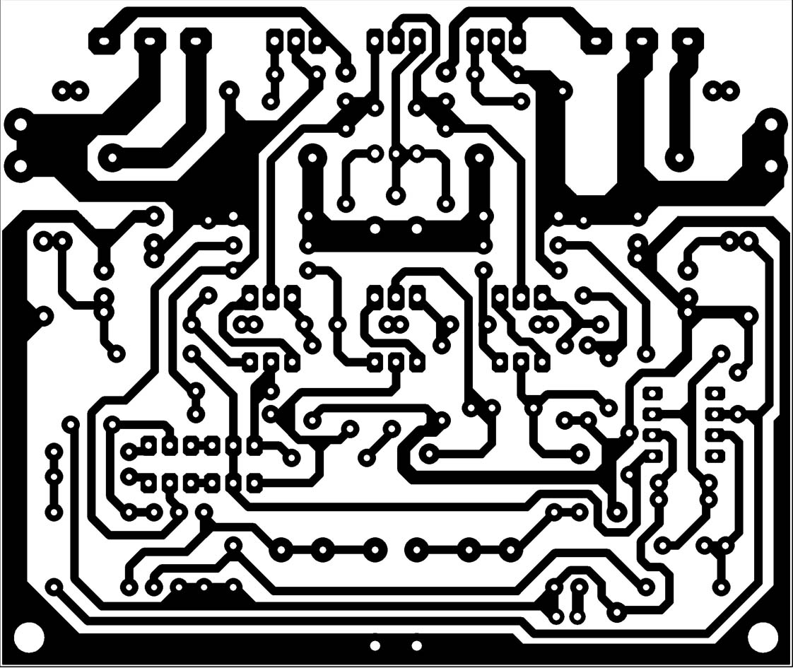

..... PCB ready , please someone check if it's correct layout . I will post in B&W the layout of PCB .
Schematic will follow soon .
Regards ,Alex
Alex,
a much better layout.
The V+, V- and Power Ground enter the PCB in a tight close coupled group. This minimises Loop Area and thus minimises interference.
Output is also fairly close to this Power Group again minimising Loop Area.
Well Done.!

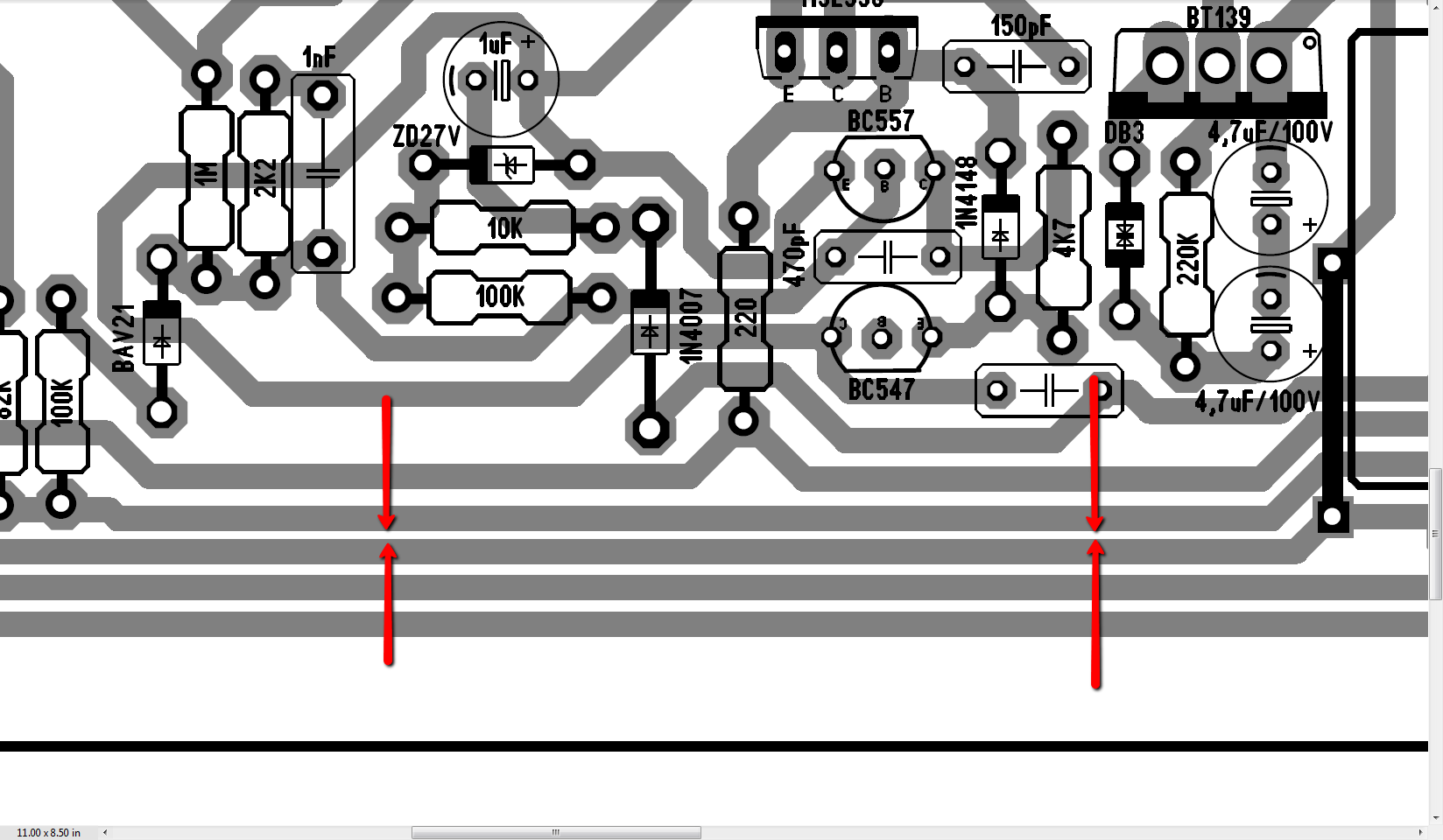

Regards ,Alex
Hello Alex don't get upset with me but for manufacturing PCB's will be no problem at all but for etching diy those traces are I think way too close each other maybe you can give a few extra millimeters so etching will be no problem.
Regards
Juan

I like the dual pot arrangement.
Works for both a lay flat skeleton pot and for an inline multi-turn pot.
Well done.
What about adding an offset pin for the staggered pin multi turn pot.
Add dual or multi pin pitch options for all your capacitors.
If possible orient all your electros in the same direction.

Thanks AndrewT for your suggestion
I will add some pad latter
all the electrolyte are at same direction 🙂
Right now I already make a board to test it, I hope no oscillation or other unwanted one...
I will share the layout after it is "tested OK" 😎
Hi John, do the mje340/350 inthe middle of pcb need heatsinks, so do they run cool enough on the lower supply voltage
Hi Vostro, I will check that out after I finish stuffing it 🙂
(one PCB already done)
I will add a little heatsink for each transistor (I don't know if it is need or not)
Regards

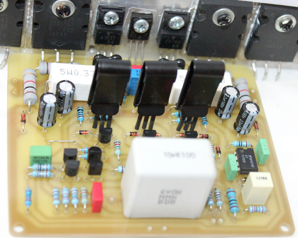

Ok, it tested OK
Dear sir Mile,
thanks for your SR100 🙂
this PCB already tested...
PCB size is : 95 * 80 mm
I need to make another channel
the MJE's need small heatsink & only a little warm 🙂
Warm Regards
