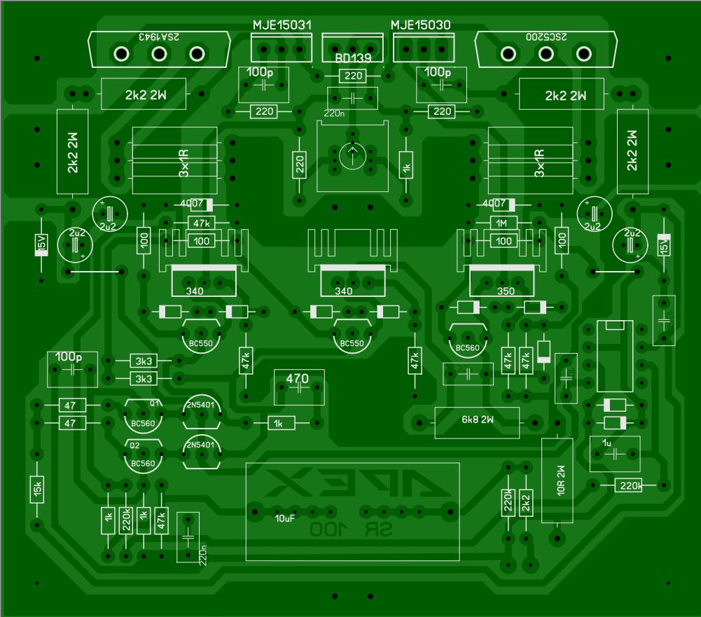

Hi vostro,
i used LF411 too,my sr200 working with deep bass,very clear and it's good,the trouble i can't set bias only.i meassure bias across resistor 0R33/5watt..
if there is another way to measure the bias please Tell me how..
Hello to all,regarding bais setting there are a few ways to do this..1 via mv setting across emitter resistors,2 reading the volts over the tracking transistor,3 current idle draw with no signal or load..remove one of the supply fuses and place your meter
in current mode and adjust the bais pre-set to 100ma..

Amptech,
thanks ,i will try 2 & 3 way of measurement.because I've done the first way but have not been successful
thanks a lot

my sr200 can't set bias,why????would you like to help me??
Use 1k5 instead 1k resistor in bias circuit (Vbe multiplayer around BD139)
Mr.Mile
thanks,i will try to change 1k with 1k5 resistor around BD139
Mr.Mile
Vce on BD139 must be about 2V...

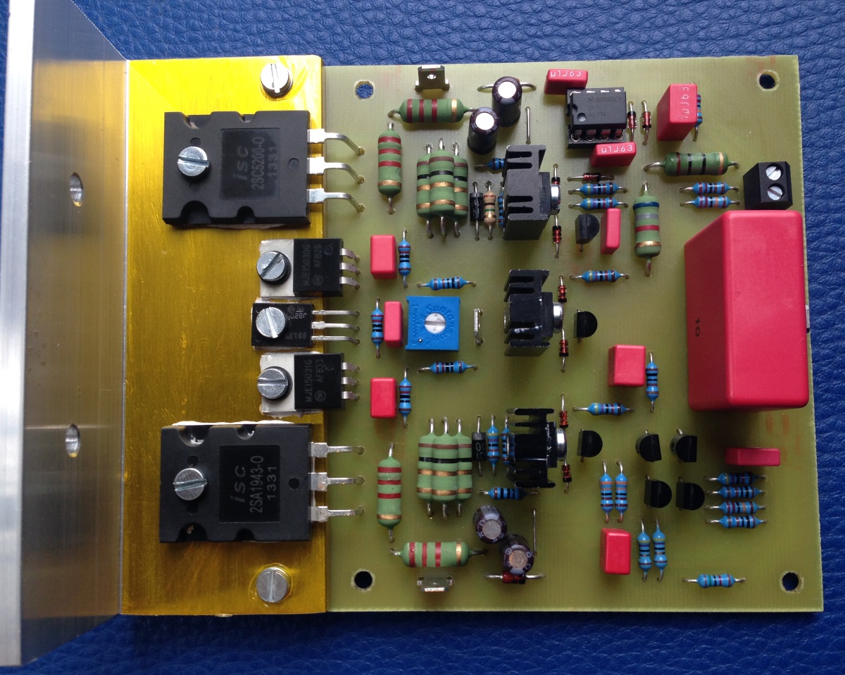

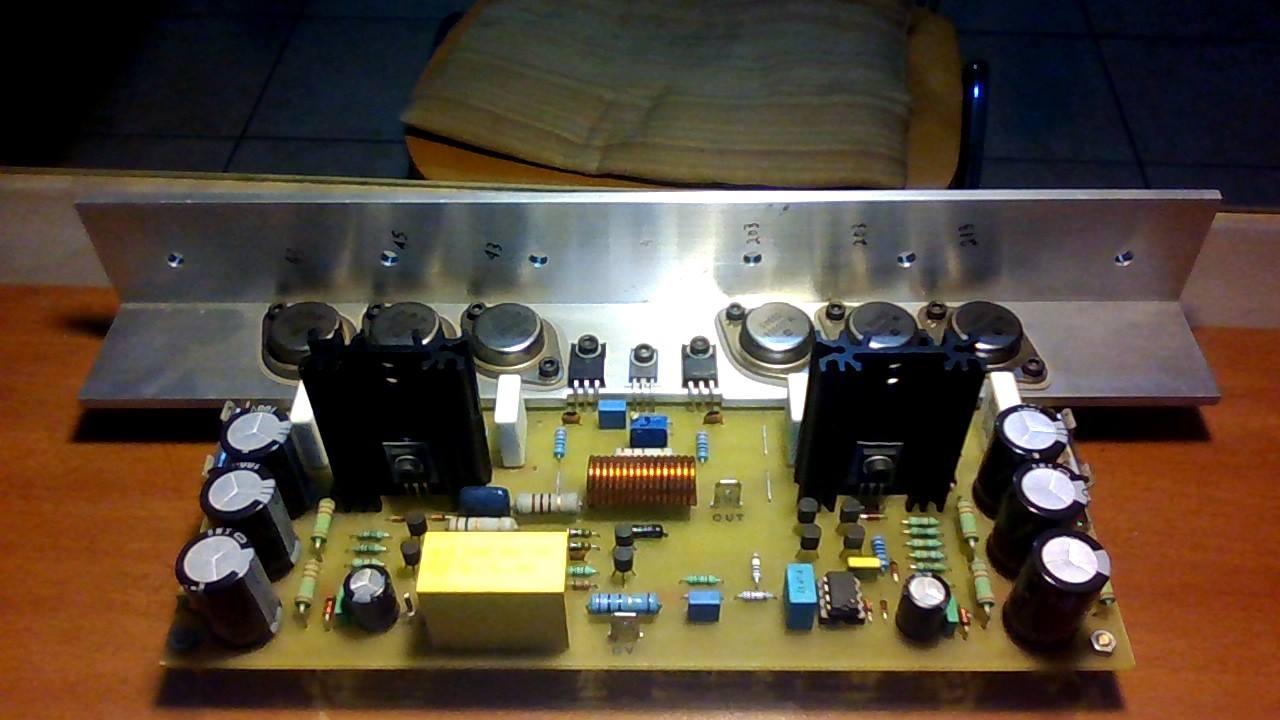

A super layout by John Bali
Here is my version with only a few small changes to Johns layout. For the second channel, I will adjust the position of the MJE yet, then it will be perfect.
Sound is good at bass and very clear in the middle and treble. But I have checked only at old car speakers for test. Amp comes immediately after the AX14 in the favorites list.
regards Olaf
Hi,Mr.Mile
thanks alot,,now i can set bias at 12mV after changed 1k with 1k5 around BD139..but the 5200 & 1943 geting hot,,is this normal,or how??
Hi,Mr.Mile
Outputs must be on heatsink
the heatsink can only achieve specified cooling when standing up with clear air gap all around.
thank Andrew T,
ok,i'll put 2 fan to aid cooling

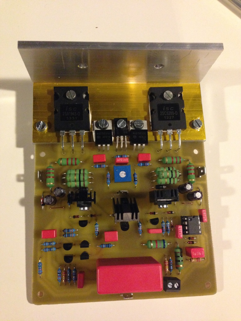

Just a few photos. Sound is excellent.
regards Olaf
