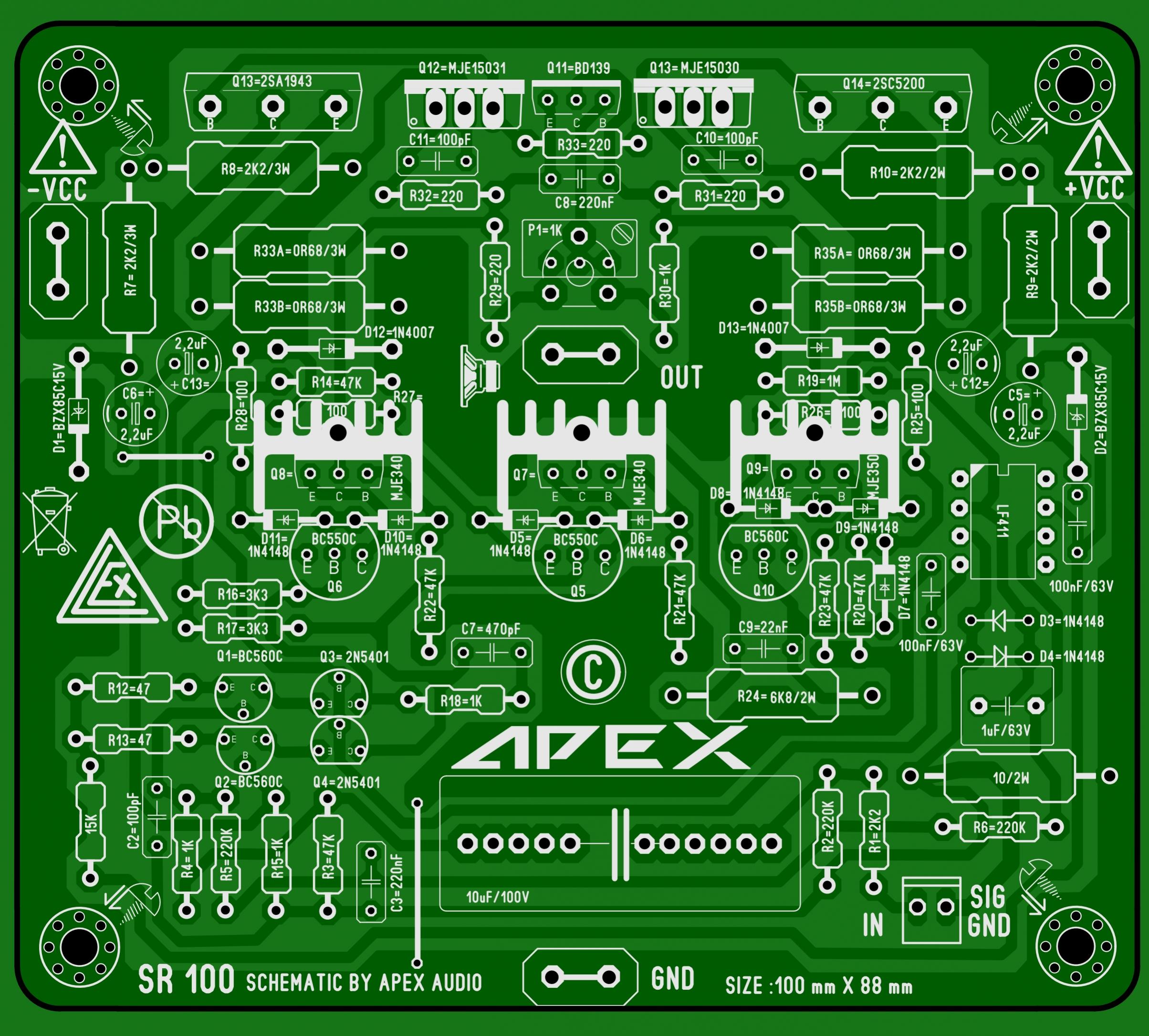

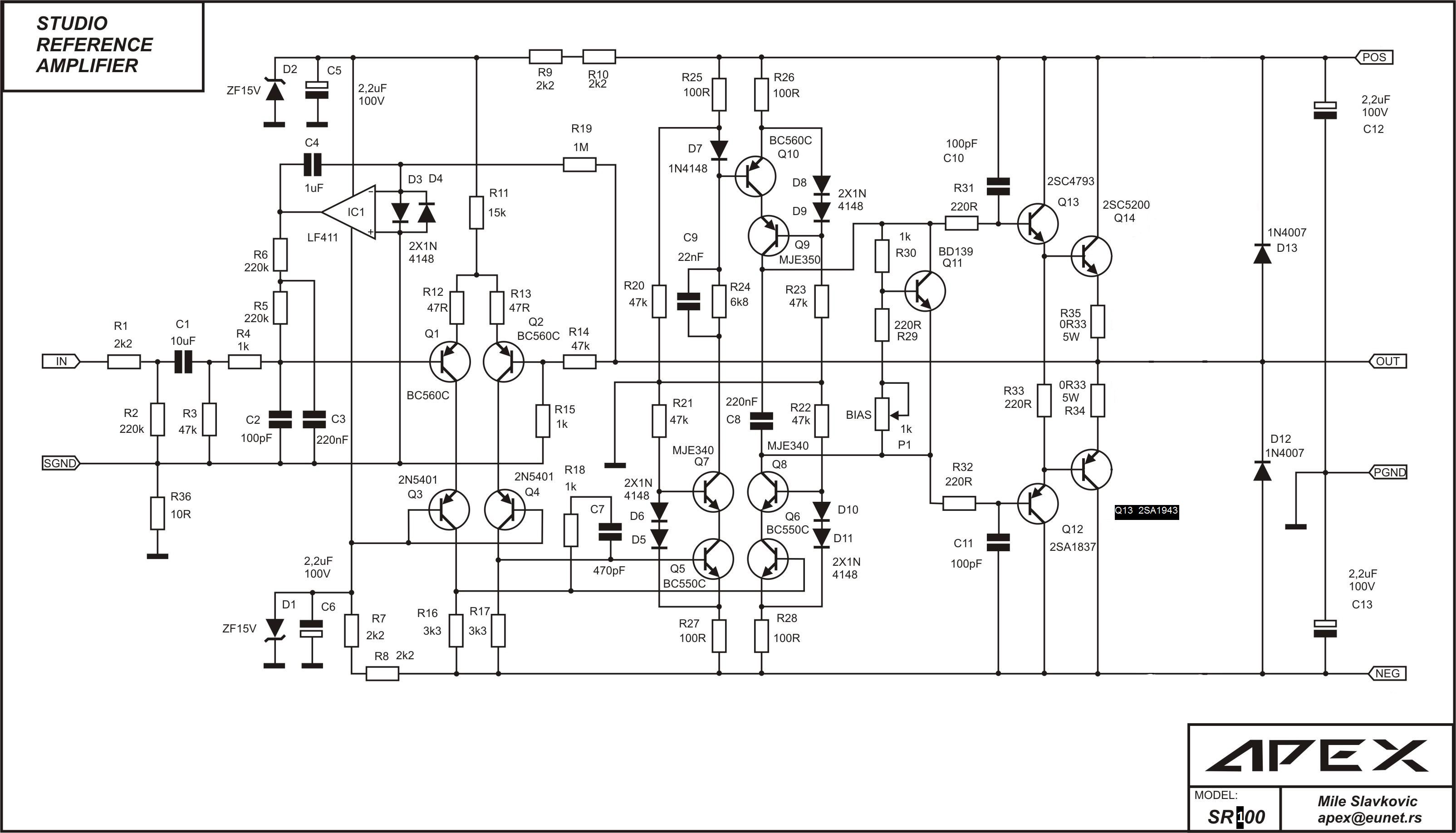

I am building this right now. How critical is the 4K4 at R7/8, R9/10? Can I use 4k7 there instead? Also, what other IC chips can be used for the servo?

Use any value from 2k2/2W to 4k7/2W... for +/-50V rails I sugest 3k3/2W.
For DC servo many IC chips can be used: TL071, TL081, LF356...

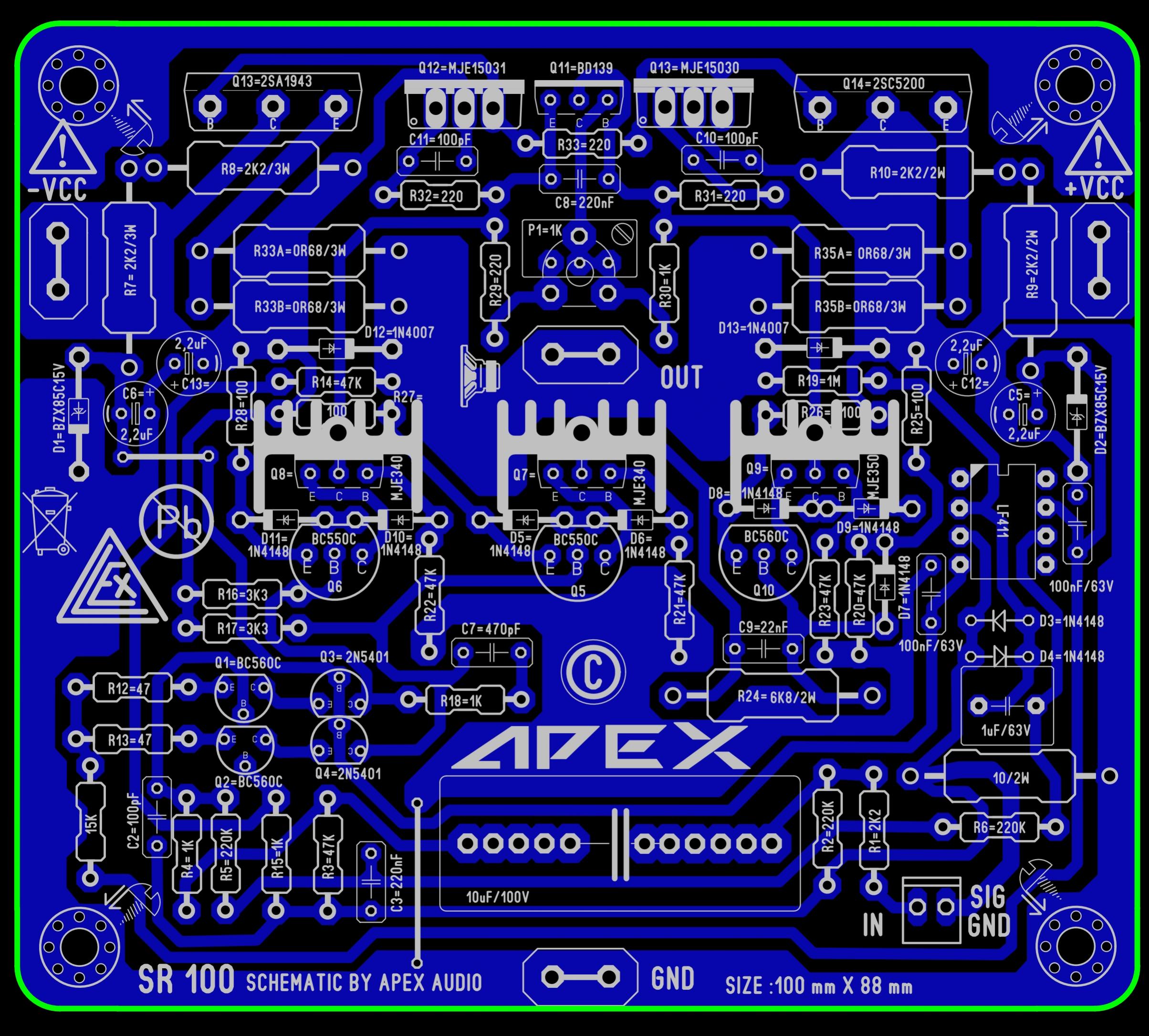

What you have gerber file for my sr200 apply to Sanken v3.2.....yes of course , why not , here in attachment are all files for toner transfer metod 🙂

....sorry the gerbers files for SR200 v3.2 are not available .... I have send you private message ! I have a bug in program and generate gerbers with errors , this is the problem .

Can we see this in pdf or jpeg? Is this posted somewhere in this thread?....sorry the gerbers files for SR200 v3.2 are not available .... I have send you private message ! I have a bug in program and generate gerbers with errors , this is the problem .

...... sorry , was modified so many times ..... forget to make connection 😉 but the silk screen it's the same . In the post#707 it's correct ......
