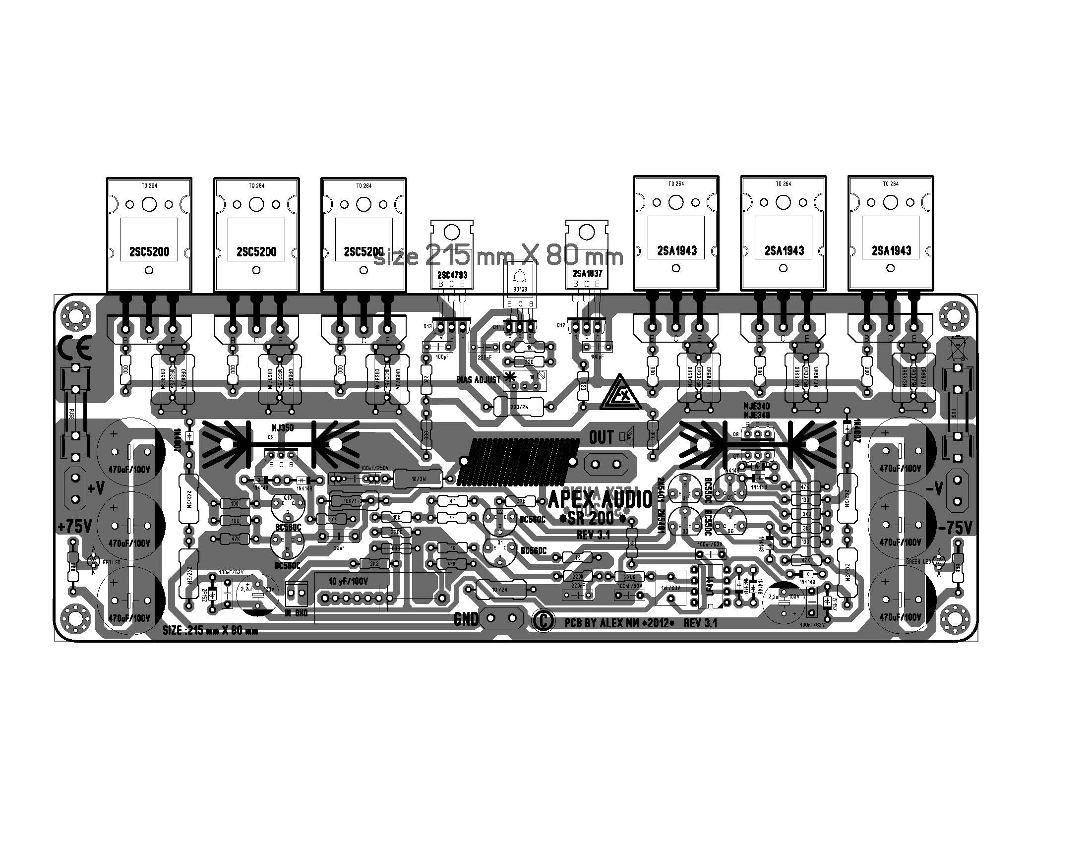

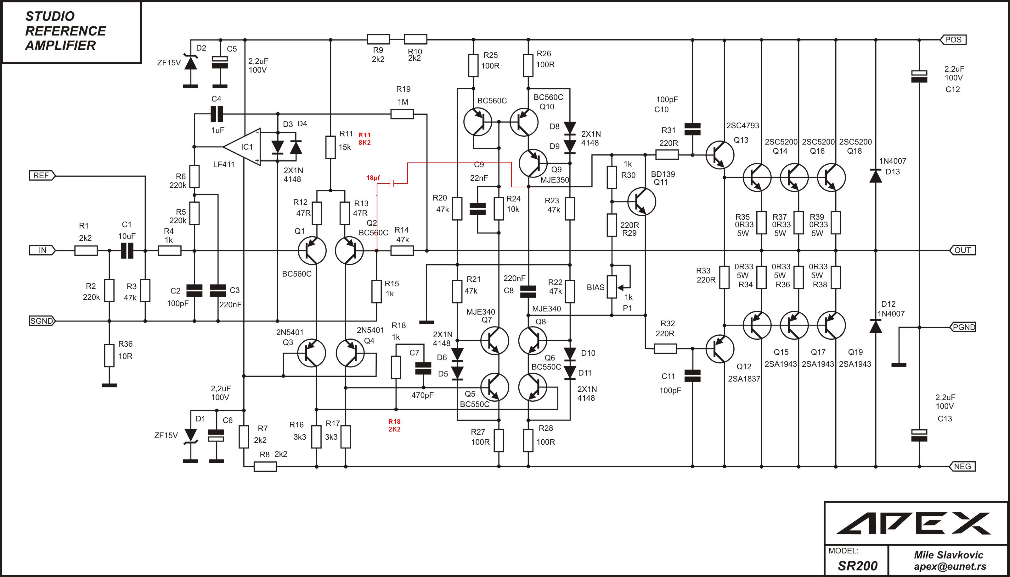

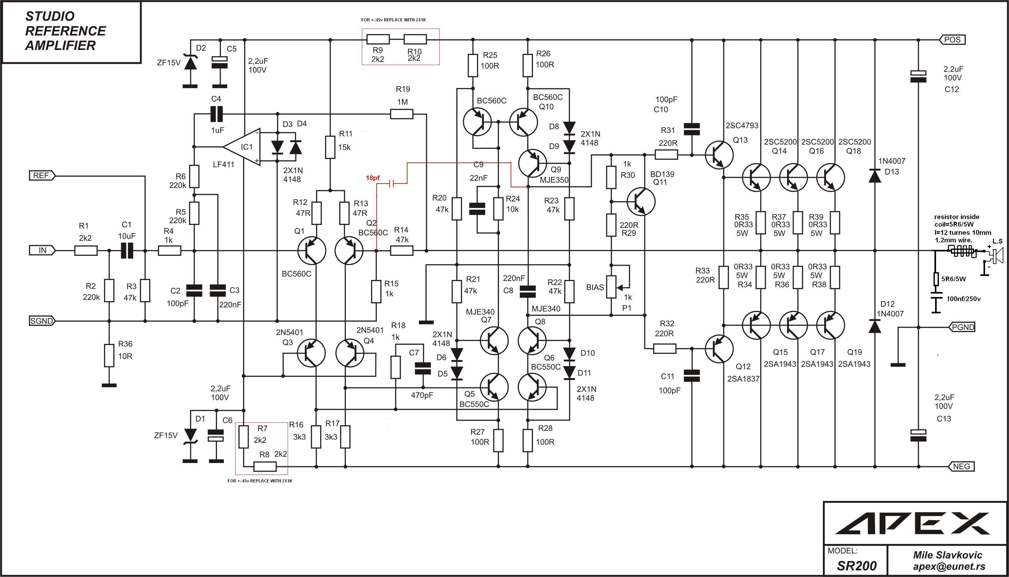

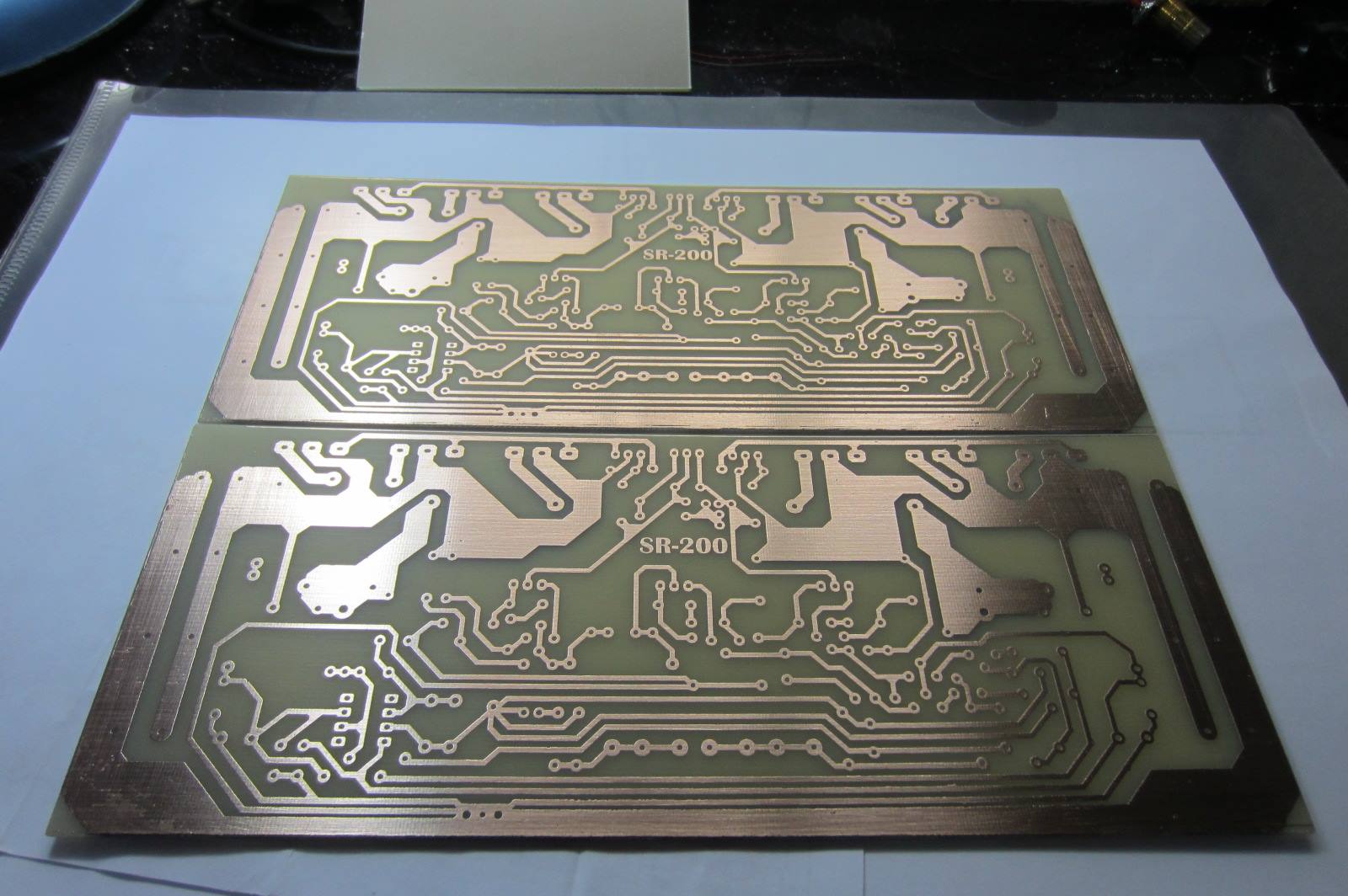

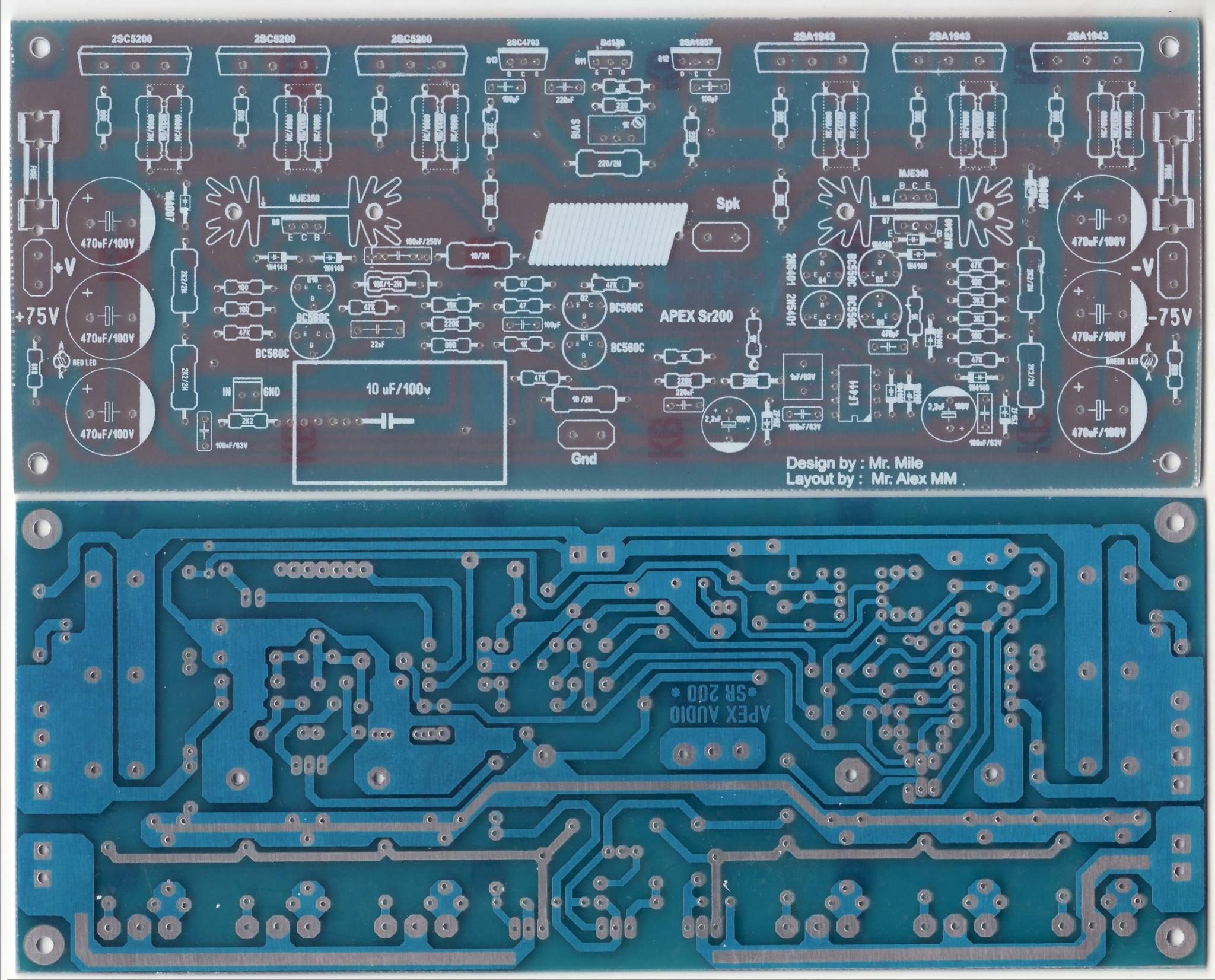

Yes that a nice one, but when I ask for it & he is out of stock of that PCB... :p
So I decide to make a new one, please check this one out :eek:
this one already tested, DC offset is 1.1mV with TL071, I have LF411 but I thought TL071 is good enough :)
If anyone want to convert it to pdf please PM me :)
I have the big jpg file :D

Nice work, thanks for this pcb design.
Regards
PDF SR200

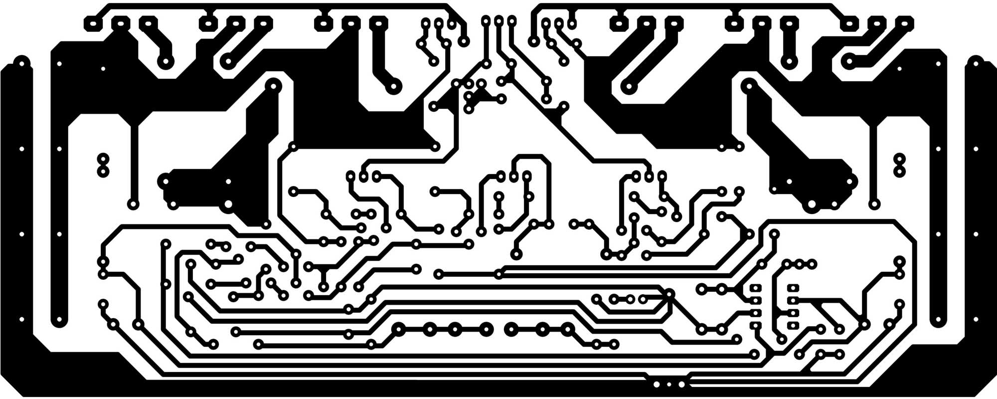

Here the SR200 in pdf format for easier toner transfer :)
PCB size is 80 x 200 mm
the good news that this one don't need any aditional compensation :cool:
