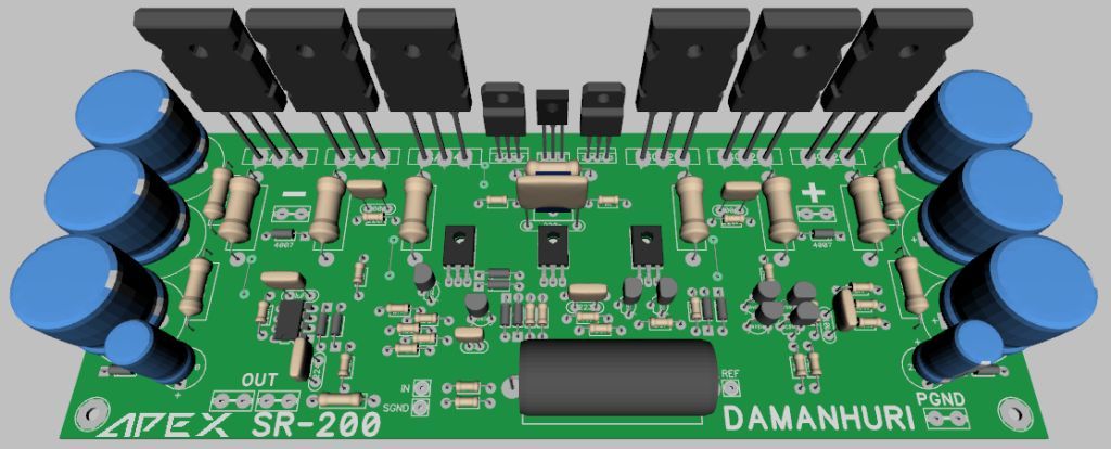

Plans for the layout of components APEX By my SR200 3D version. Thanks Mile, you are good people who want to share this schematic.
I use like Alex who uses the 3 left and right 3 Cap with a value 470uF/100V.
I think he mean
is it better to put big 10.000uF than just a tiny 470uF 😀 ???
Anyway nice 3D @DAMANHURI
I hope you can realize it soon.

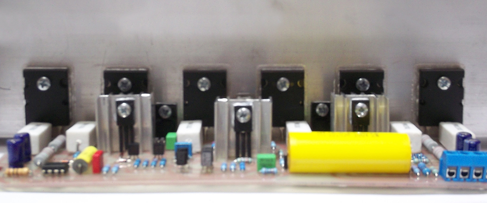

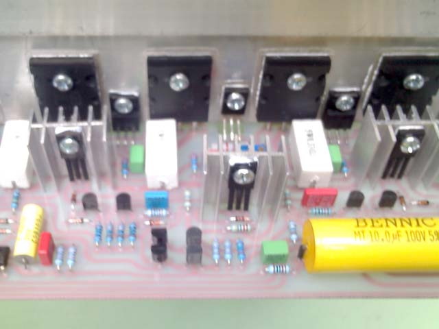

Hi all, thanks to apexaudio for great schematic...
Finally I made SR200 with same value with schematic, here some pictures
(but sorry picture is not good quality)
I use 220nF/63V on VBE & 100pF/100V on colector of the driver transistor
because that what I get here, so what is the maximum voltage that I can use?
Regards

Hello,
OK, I have not paralleled the resistor to inductor, Will do it.
Alex I mounted the transistors, and connected to psu.
Fired up and connected to mobile phone---- No sound.
Mobile disconnected Touch input pin with hand it make lots of noise and 22e resistor on psu gets extremely hot.
Checked all the connections.
Checked for shorts- No shorts.
Checked transistors for short to heat Sink- No short.
Disconnected speaker gnd from psu gnd- Psu resistor does not get hot, Connect again gets hot.
what Could be the problem.
And how do I Measure and adjust the Bias, Please Show exact procedure, I have never done it before.

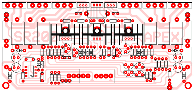

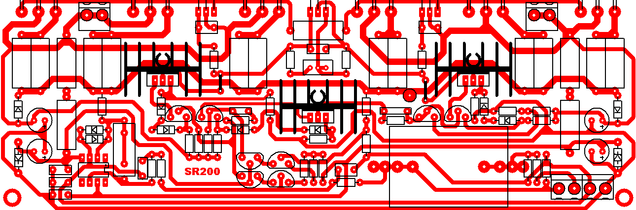

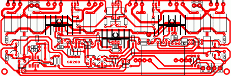

Hi Mas John bali... your pcb design is very nice... I like every your design... there's alot of space to put the componen and the heatsink .. I plan to build the stereo SR 200 using your pcb layout... can you send me the pdf file sir.. couse I make the pcb using the iron .. sorry for my english..🙂🙂
Here pdf & .pcb
Ok, mas Jofual.
this is the pdf for toner transfer.
PCB size is 68mm x 200mm (saya kecilkan sedikit)
& you must set "mirror" setting on the printer.
Do have a laser jet printer?
I don't have & tried photocopier but not good, I end up with "spidol" permanent again 😀 . I will try another way to make PCB.
No component value!
You must find by your shelf where is component value,
because I usually not make it.
I like PCB without silkscreen 🙂
There also .pcb file, but I rename it to .txt
you can try open it with ExpressPCB after rename it again
Enjoy ...
