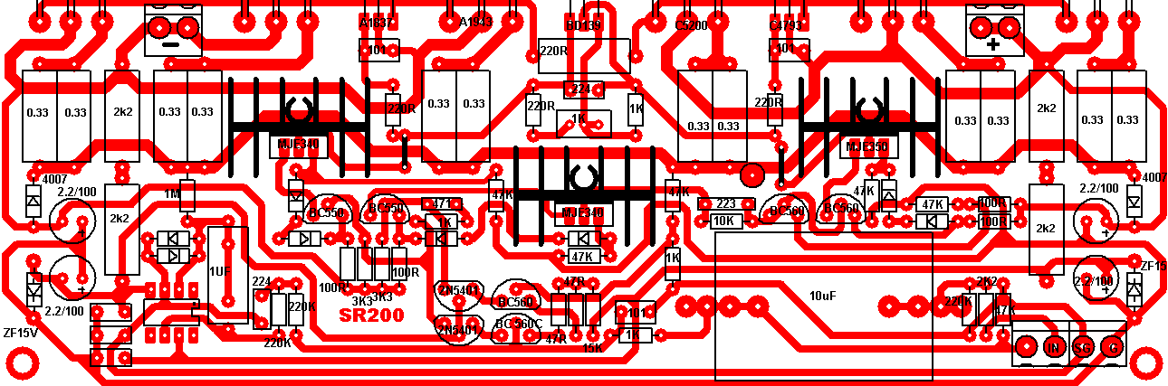

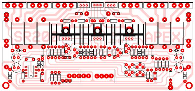

Hi mr John... now I already put all component value.... please you check are all the component value write corectly..?

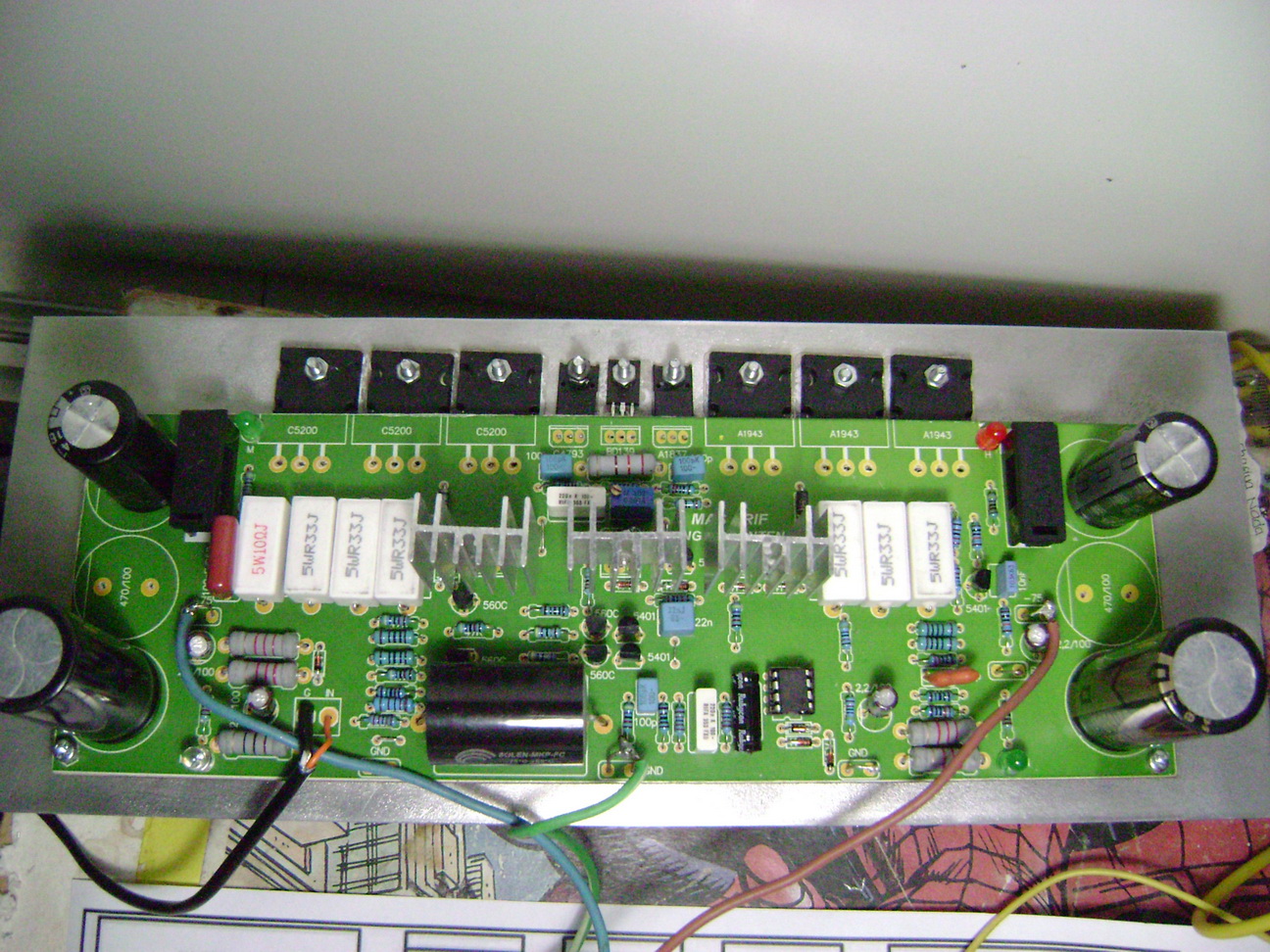

Hi all, thanks to apexaudio for great schematic...
Finally I made SR200 with same value with schematic, here some pictures
(but sorry picture is not good quality)
I use 220nF/63V on VBE & 100pF/100V on colector of the driver transistor
because that what I get here, so what is the maximum voltage that I can use?

Quick action... 🙂Hi mr John... now I already put all component value.... please you check are all the component value write corectly..?

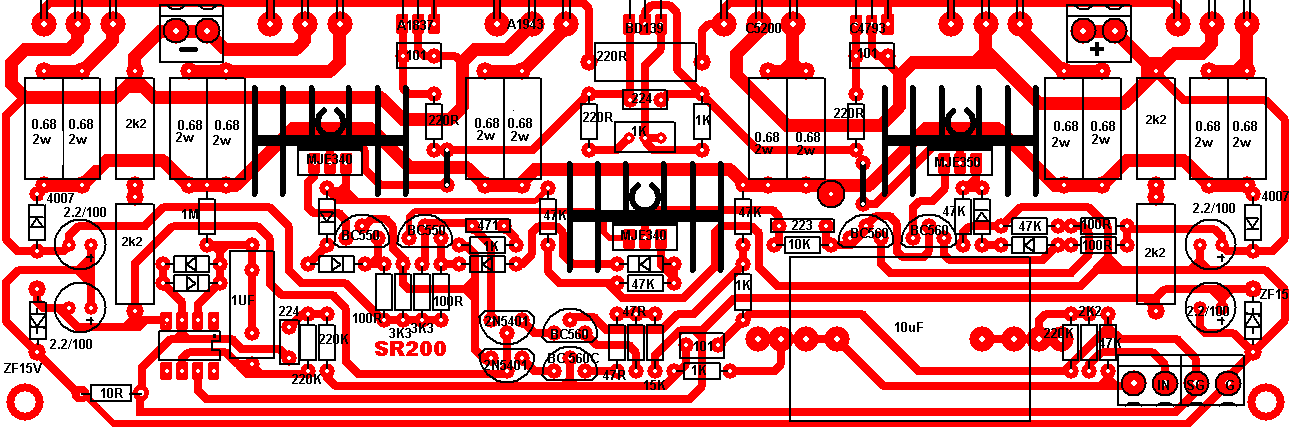

Use 2 x 0.68R/2w not 2 x 0.33R/2w.
I use 1 x 0.33R/5w on my build.
Next I will try 2 x 0.68R/2w & the position is in reverse each other to minimize the inductance, maybe...
thats what I'm thinking.

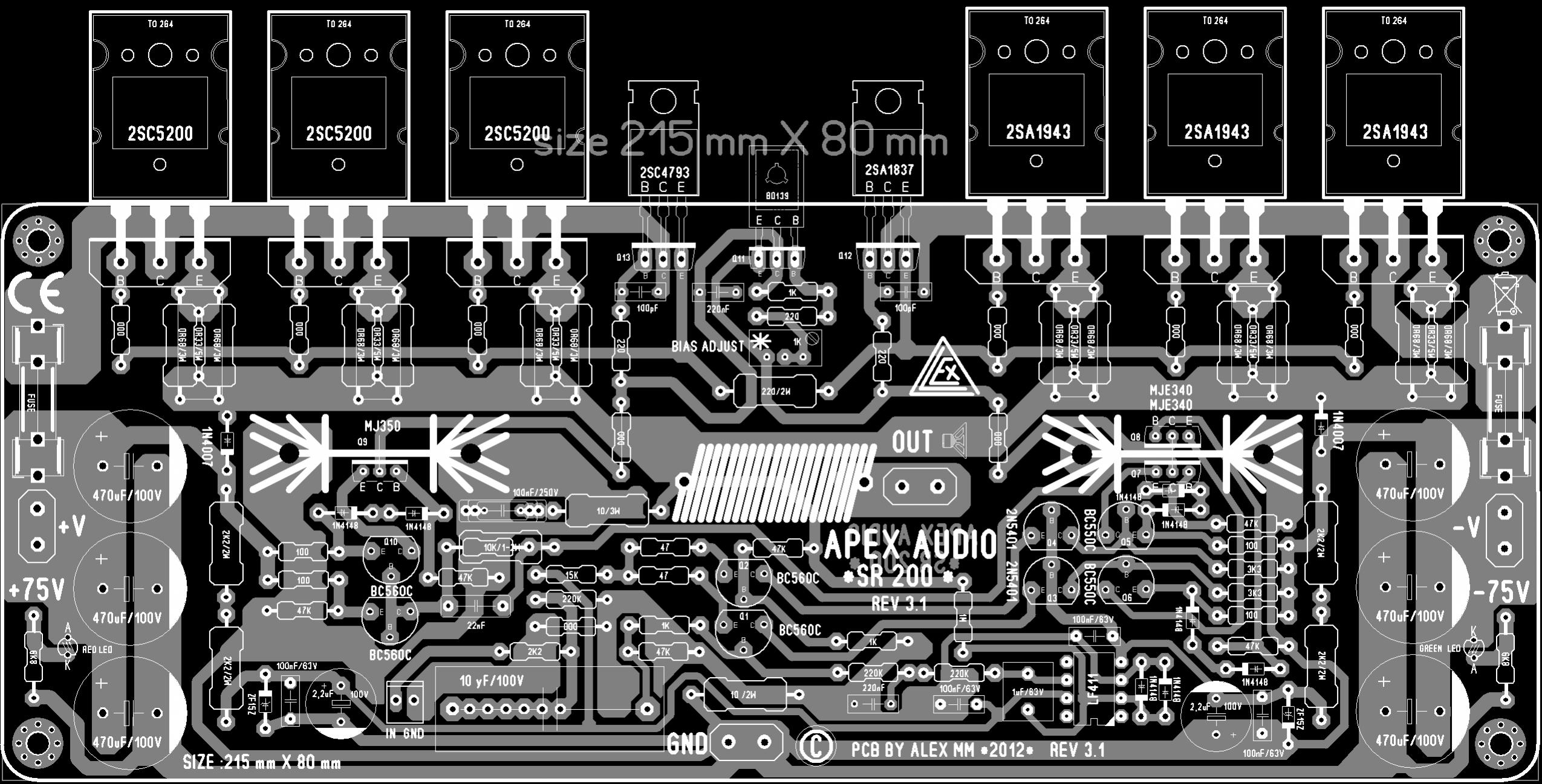

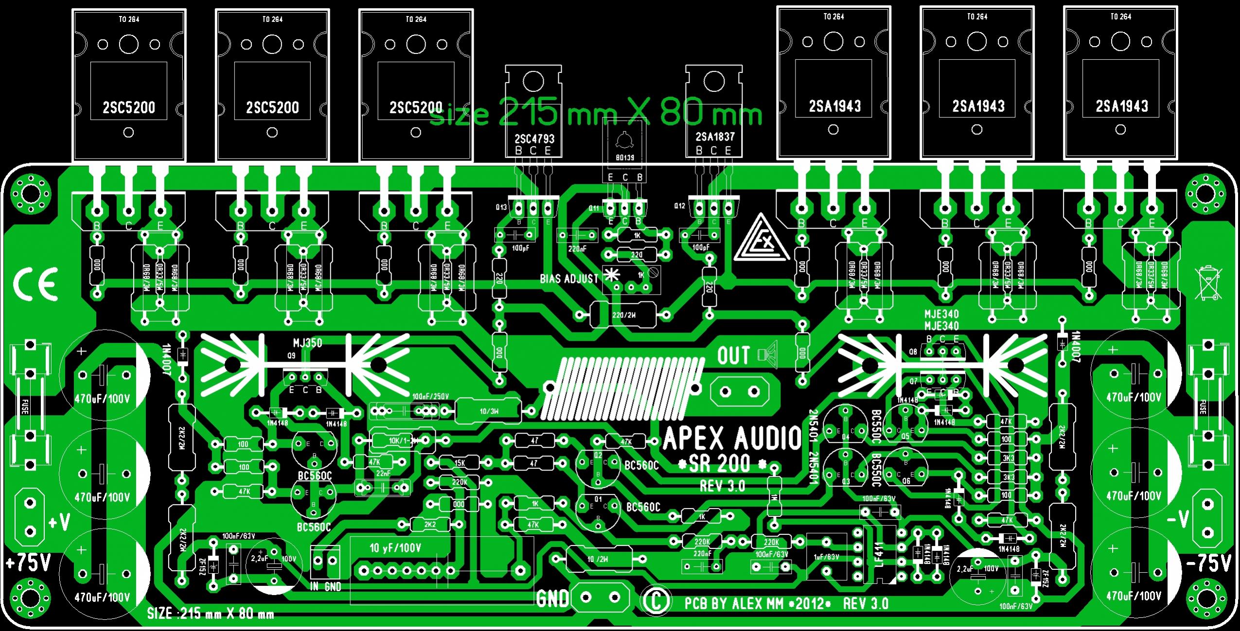

Ok Sir John .. this the new corect one.. and I also corection the resistor 10R from pin 3 IC to ground... thanks for share sir..😀🙂
Thanks for Sharing MR Alex mm.... why the positif and negatif capasitor 470uF not conect to main current sir...?🙄Thanks you Mathez . Files attached .🙂
regards Alex.
I think, they are, connected to main positiv and main negativ rail 🙂 whats wrong in your opinion ?
Alex.
...... sorry , was modified so many times ..... forget to make connection 😉 but the silk screen it's the same . In the post#707 it's correct ......
Alex.
Alex.
Alex.
Yes Bravo to Mr Alex.... thanks Sir..I like it..very nice pcb layout..

Hi Alex, I have most of the parts for this amp. Can you please make the pads of Q9, Q7 and Q8 a bit bigger? really appreciated your endless efforts for making a PCB layout which beautifully executed.
BR,
Junie
Hi Junie ,
It's not possible becouse are two transistors on the same heat sink and layer ....
Thanks for kindnes . One question , how many times you intend to solder and desolder those transistors you mentioned ....😕. ?
Regards Alex.
Regards Alex.
