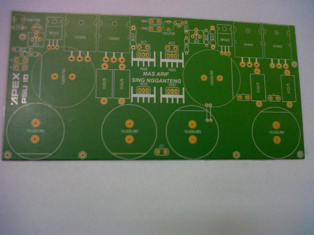

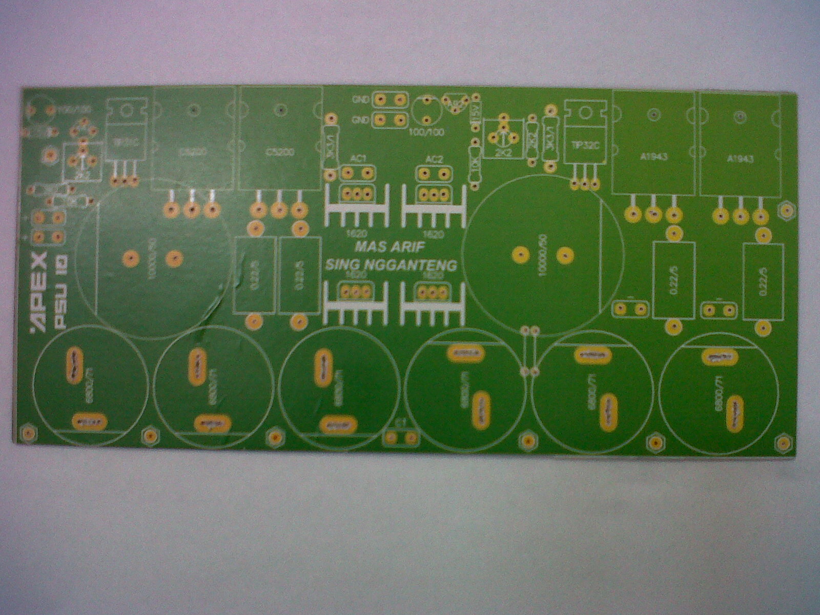

These are my new pcbs, some parts are available on my drawer.. I will try to install them soon. I hope I have spare time.
Nice PCB Mr. Arif Bravo
Nice PCBs, and dual TO220 diodes instead bridge rectifier...
Regards
Thank You mas Damanhuri...I am sorry, I went to bed early last night (OOT)...please send me an email..Nice PCB Mr. Arif Bravo

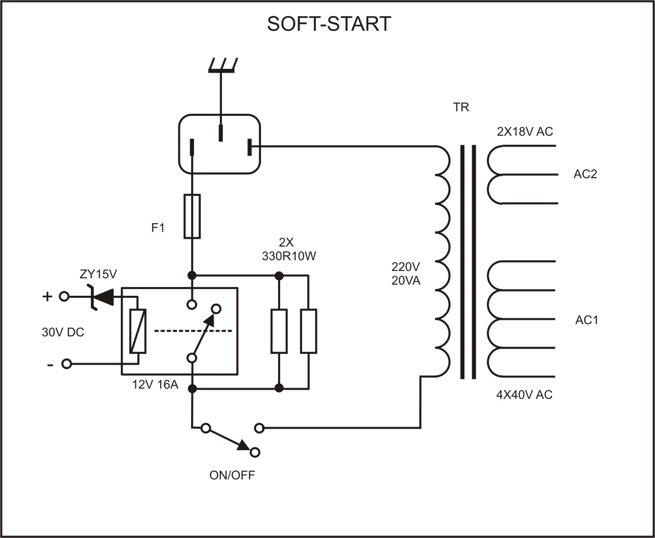

This design by Alex MM SR200 is still in the wiring. I hope there is no problem.
Nice work, use 150R/10W instead primary fuse for test.
Just use 2,2uF/100V.
Regards
I use a 50 VDC voltage. whether it is appropriate to the value of this resistance? where should I put this position to try detainees?
Maybe you can put safety resistor instead of the fuse, I put safety resistor parallel with the fuse (I install the resistor under the pcb). It is easier for me whenever I want to change my amp's bias setting, just need to uninstall the fuse, set bias as I wanted, and install the fuse back on board. CMIIW...
It is better to follow Mr. Apexaudio's advice, use 150R/10W safety resistor
Best Regards
