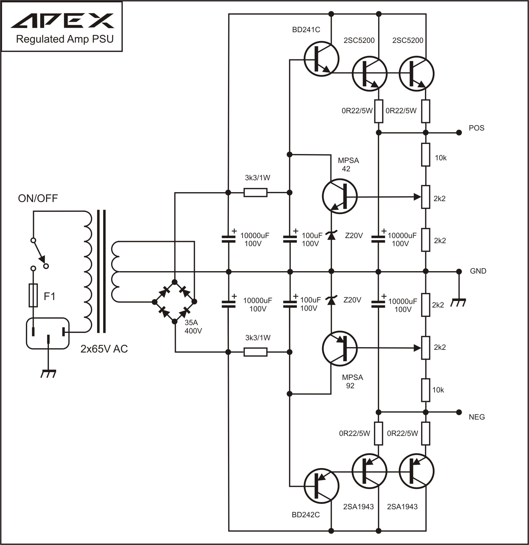

Dear Mr. Mile,
- Is Sr200 required to wear a special regulator (adjustment regulator) as post # earlier.
- For the B500 I just use a simple diode bridge power supply with 4 pairs of Elco, transformer 47.5Vac or + / - 67Vdc supply.
- Can be used the above power supply for kit SR200? because it is too complicated for me to make a special relgulator. sorry my bad english
Best regards,
Yassud
Dear Mr. Mile,
Best regards,
Yassud
Simple unregulated PSU can be use for SR200.
Regards

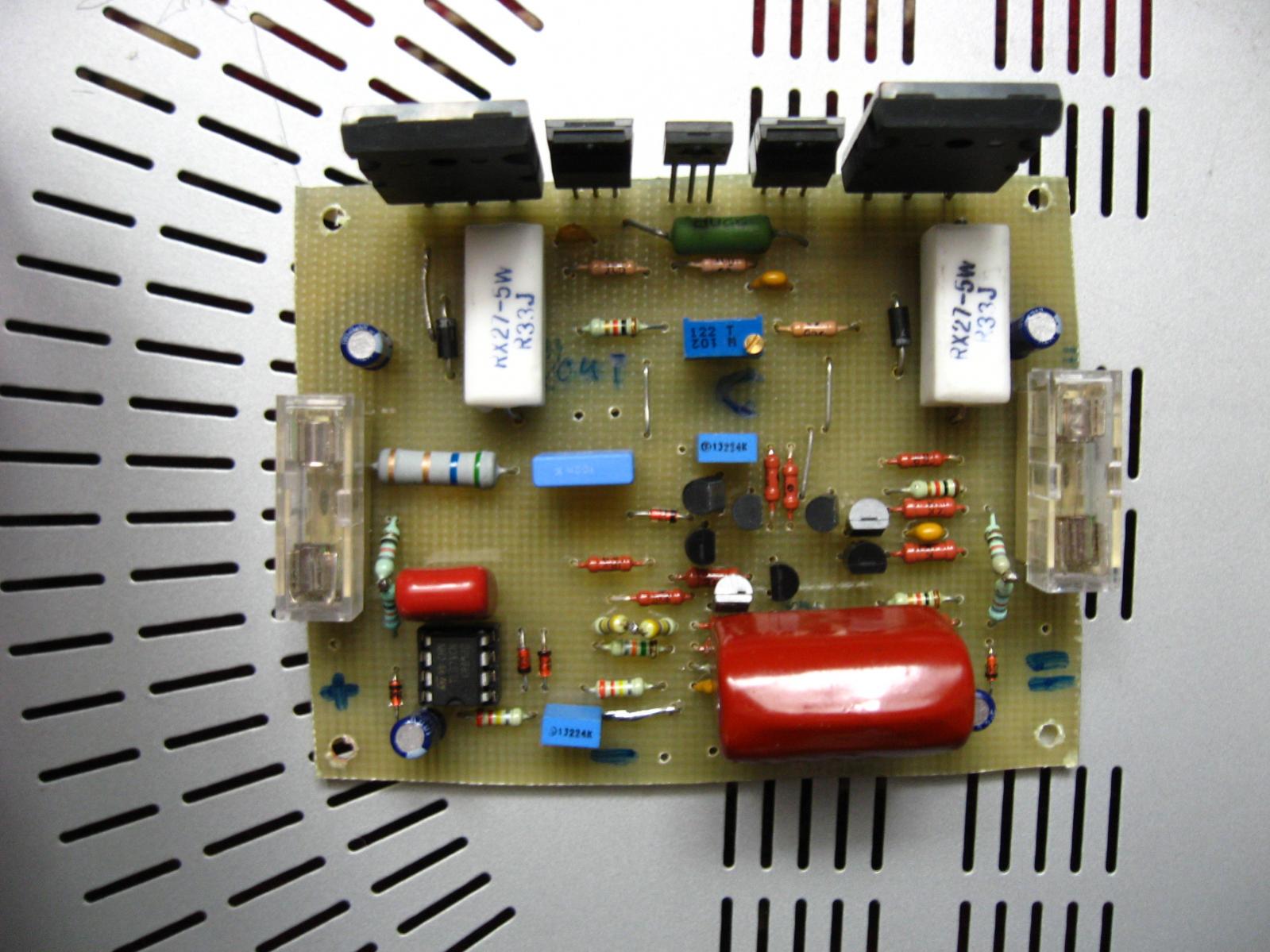

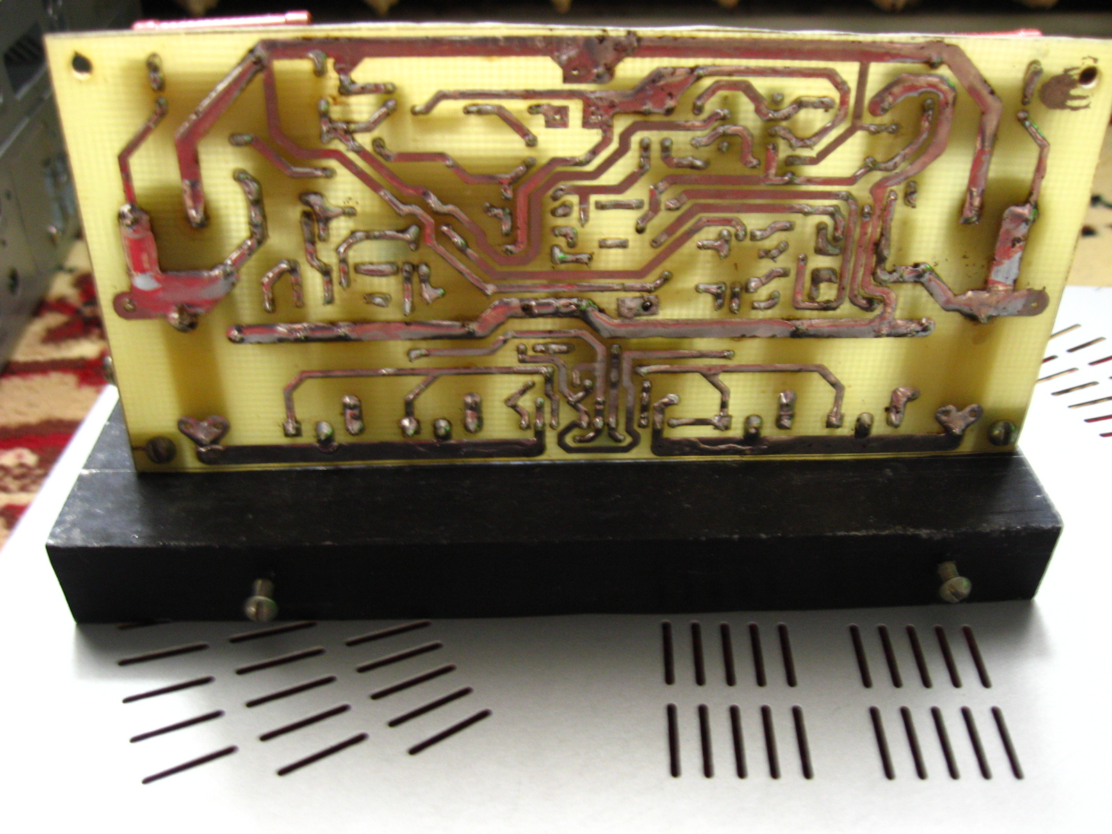

You are right, of course. I'm currently building an SR200 PSU and reacted on impulse just before thinking
PSU10 for SR200 use 100V caps.
