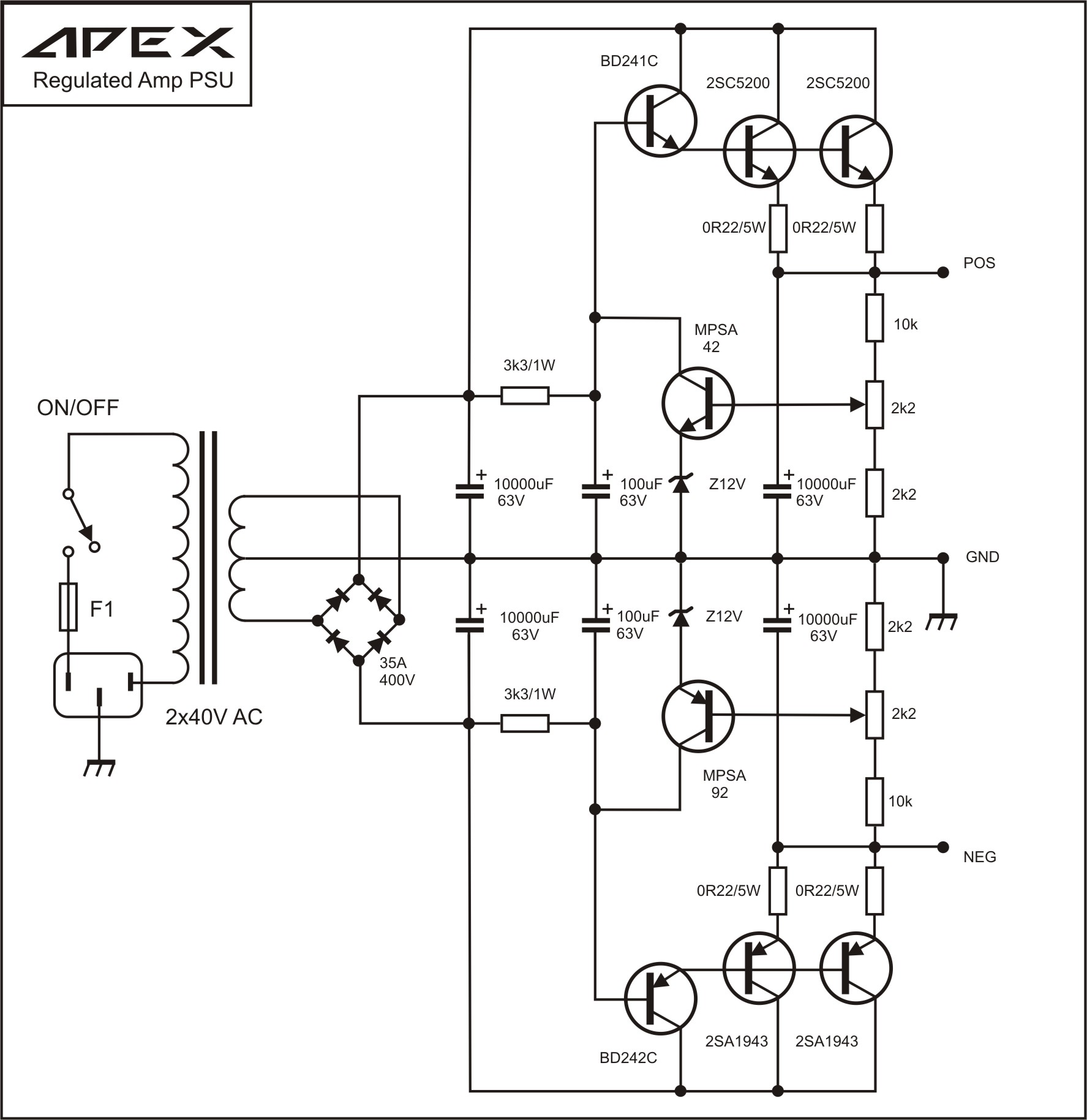

r 21?

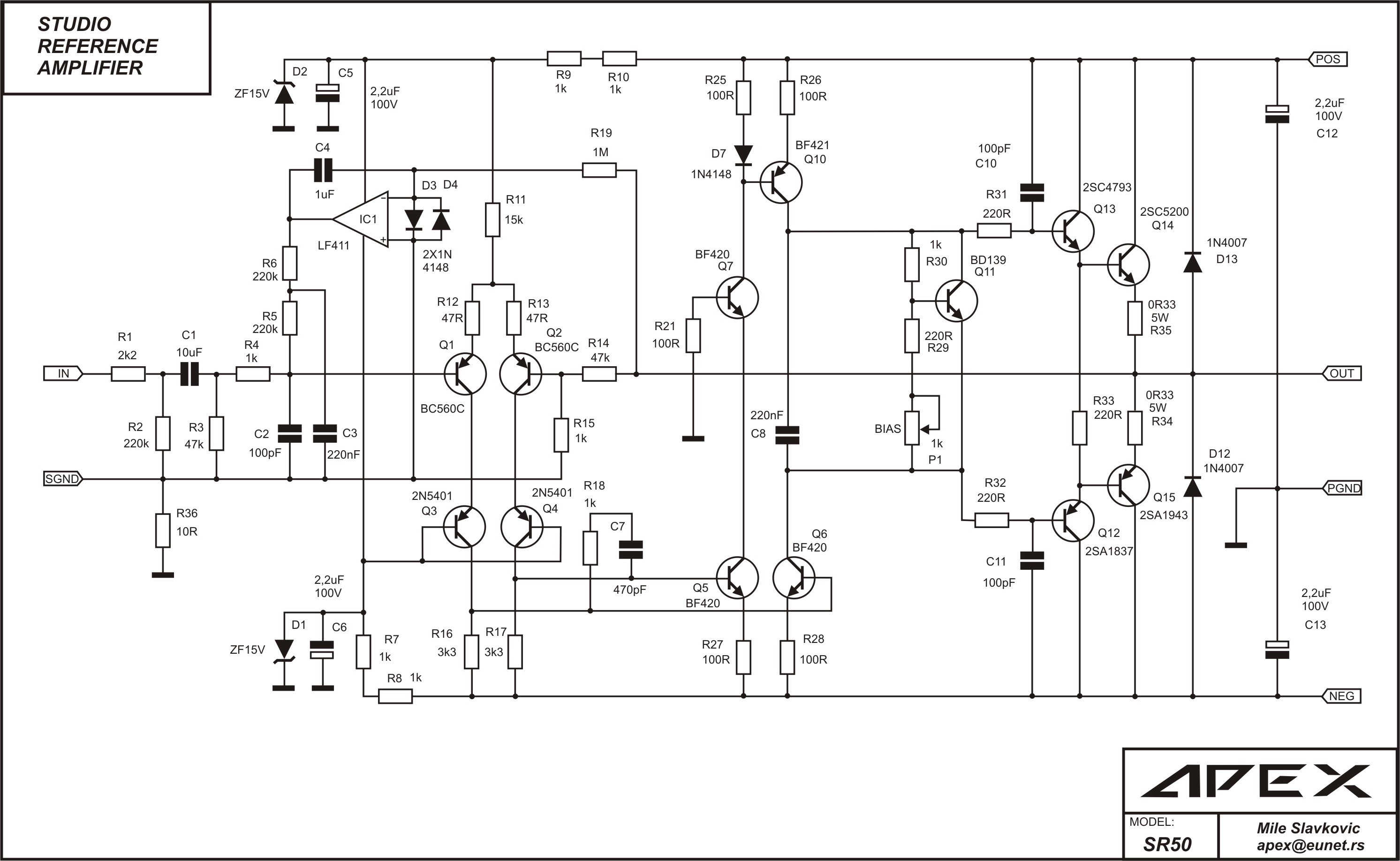

i have made mistake when i post the old schematic and here is the corrected schematic. r21 is connected to power gnd same as apex schematic.input gnd can be connected to power gnd.but in apex schematic he used r36 as an option if hum is present.i have connected pin 3 of ic1 to input gnd same also in apex schematic.
foil pattern had been corrected in last post.

What kind of noise? Deep bass or a sound of a wind through the trees? They are caused by a different things. First one could be from magnetic field of a transformer (if it is too close to an amplifier pcb-s),not enough filtering in a PSU(too small or old capacitors),damaged bridge rectifier...those are all reasons for a deep bass noise. I once had a noise ("wind in a tree"kind) in one other amplifier and it was caused by leaking capacitor 68nF,when I replaced it the noise was gone.
