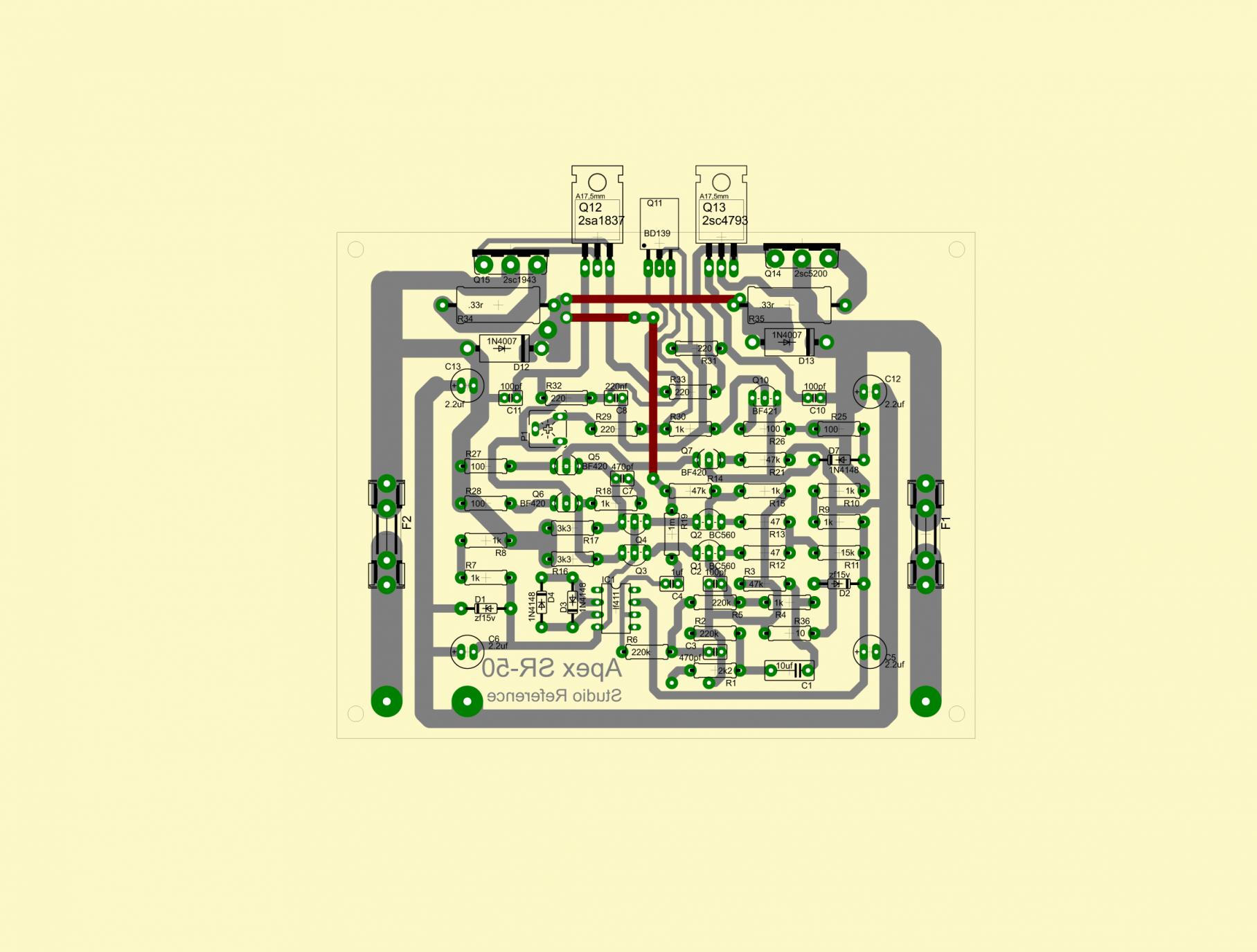

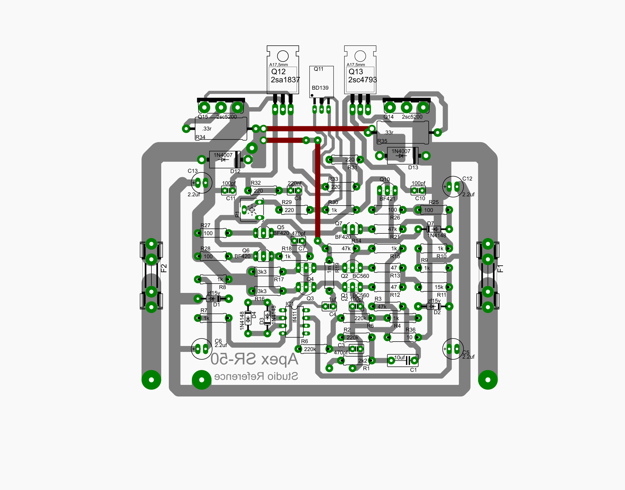

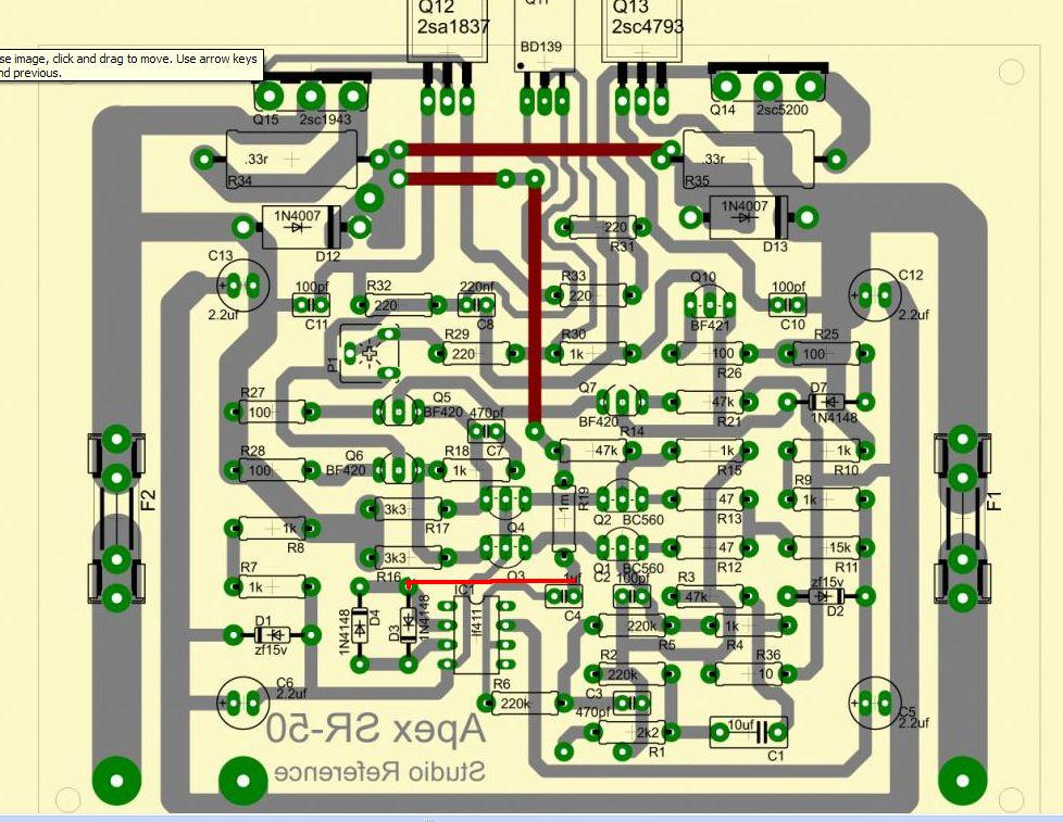

CORRECTION ON SR 50 PCB-my deepest apology...
Correction made:
1. wrong supply of ic (copper wire of pin 7 should be in 4 and vice versa-see pdf)
2. wrong value of r25 should be 100 not 1k
3. wrong value of r26 should be 100 not 1k
4. wrong value of r27 should be 100 not 3k3
5. wrong value of r28 should be 100 not 3k3
Hope this may help(based on the original schematics of SR50).
ENJOY!!!
Correction made:

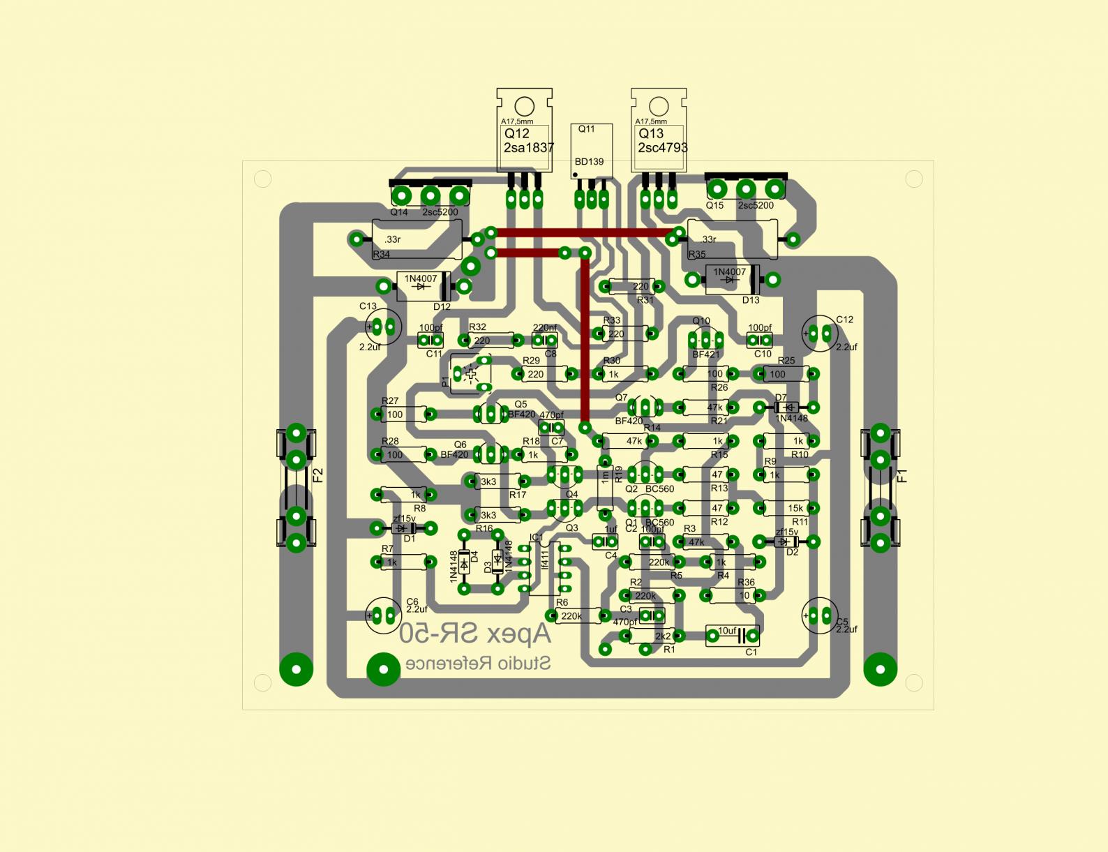

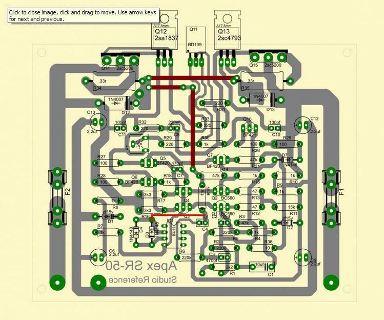

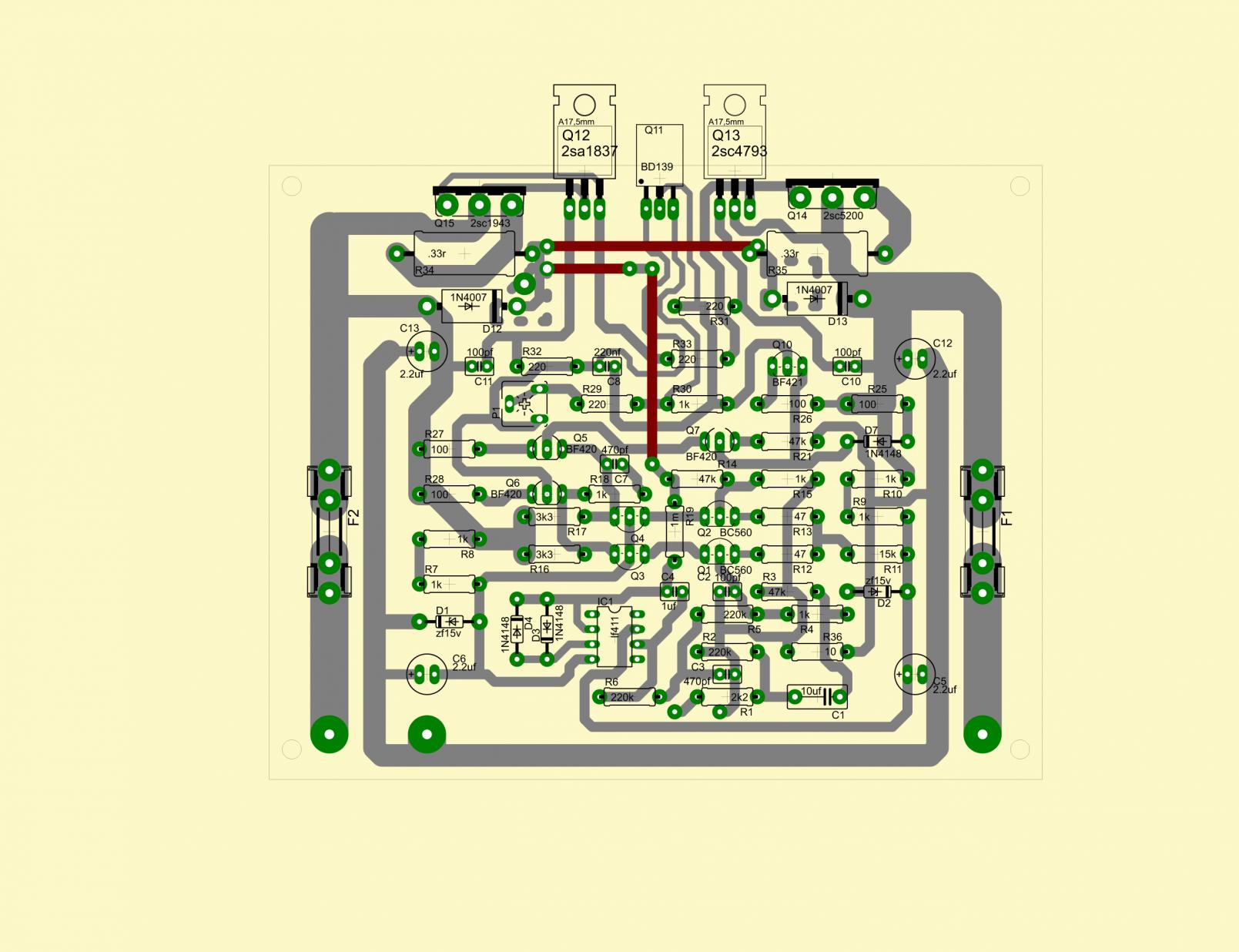

sr-50
SR50 is Studio Ref Amp for small studio monitors without cascode in VAS.
...... you have another smal mistake , se .......😉
ok tell me. I will correct it.🙂
.......and so on ....
..... D1 zenner diode must be reversed , R7=1k resistor in wrog position not to pin 4 IC (not this way )..... , output transistors are the same 2SC5200 ? and so on ........ 🙂
thanks for the correction
hope this is fine...
again, again...
thanks,alex...your the man!
and also change the schematic
....... forget to link , like in pic . 😉
scematic

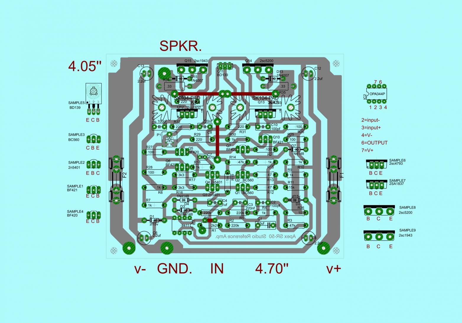

IC1 PIN3 ?
If the unconnected PIN3 floats with PIN2 then the 411 output voltage will always be zerovolts +-output offset +-common mode error.
you are right
IC1 PIN3 ?
If the unconnected PIN3 floats with PIN2 then the 411 output voltage will always be zerovolts +-output offset.
