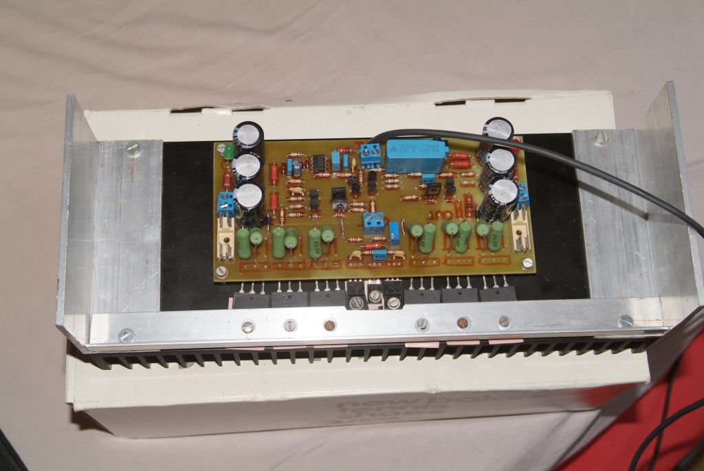

I have built one SR200 and have it running on +/- 70V.
I can set bias for it to be at 100mA (10Ohm resistors do not go up in flames).
However, the MJE 340/350 all get very hot. During short up-times I did some measuring and it seems that each of these MJE's has approx 67V between E-C and runs some 10mA. Should these T's get warm with these numbers? Should I heatsink them (I see heatsinks on them in some builds.
Or does this mean that there is an error in my build?

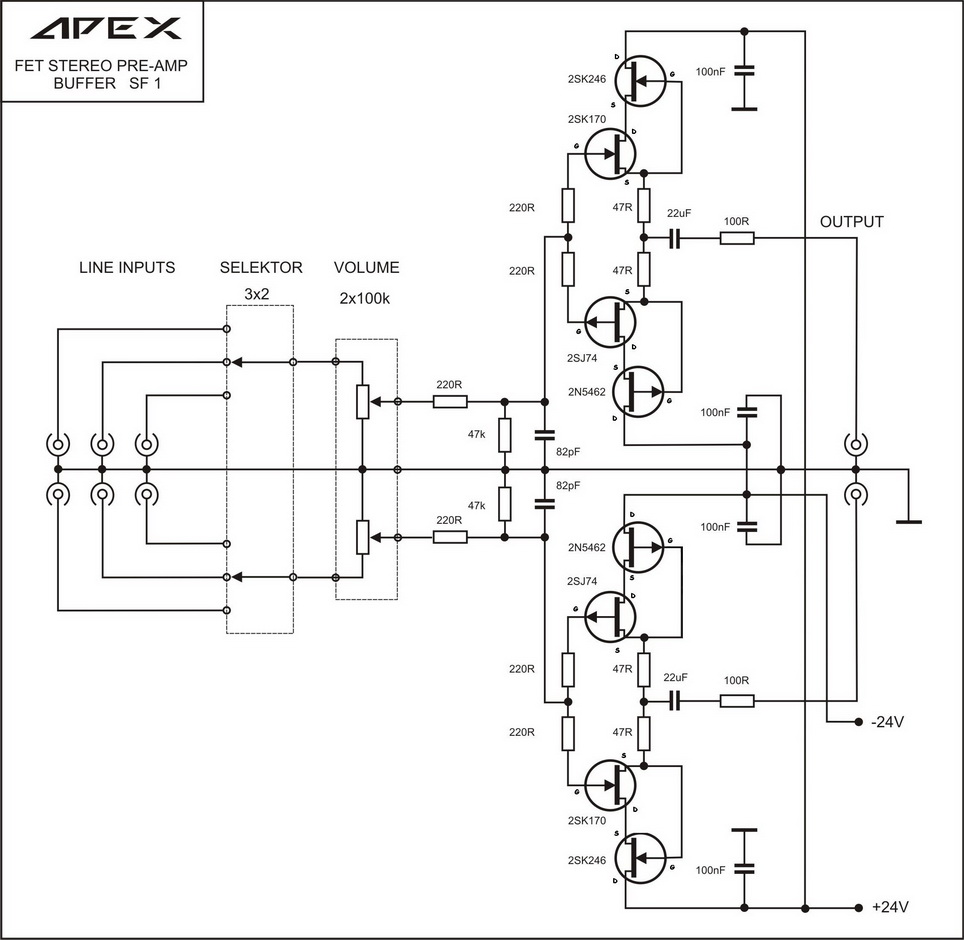

This buffer can be use instead preamp.
sir apex i want to make a pcb for your buffer but it seems that 2n5462 symbol is not meant for transistor and also symbol for fet i dont know which one is source and which one is drain.symbol for fet is not clear.please can you give us the correct schematic.thank you..🙂
For more outputs you must use triple darlington topology. Maximum power can be 750W/4R, and +/-110V rail voltage.

it would be best if you fitted heat sink tab's for the mje340/50's to aid there cooling...

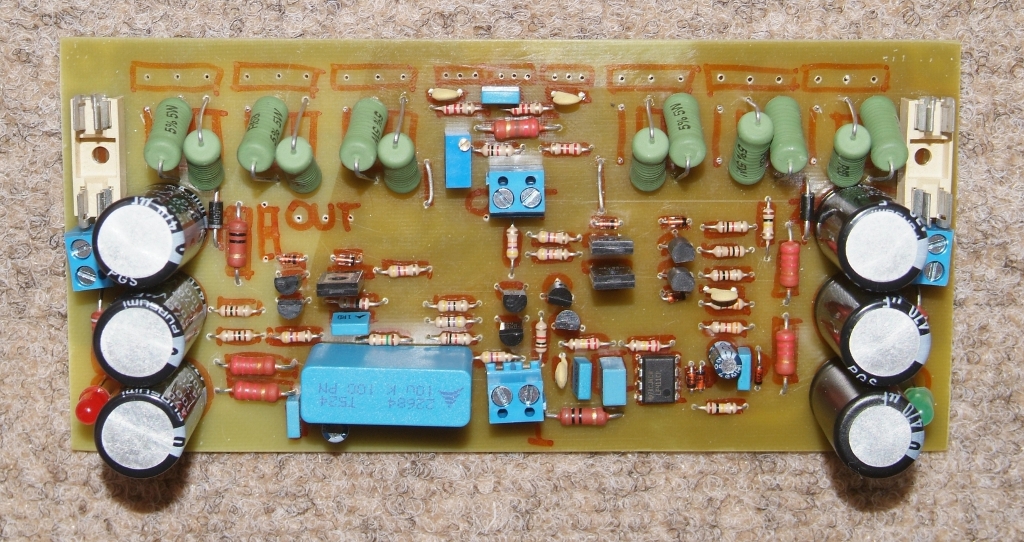

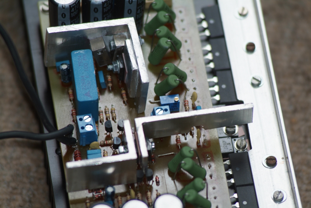

I run SR200 on +/- 70V and found that 5 transistors get pretty hot. It all works just fine, however, I made some cooling on the MJE transistors and the 2 BC550's that connect to the + via the 100ohm resistors (see picture).
Isn't it strange that the 2 BC550's on the '-' side do not get as hot as the ones on the + side?

It's strange that the 2 BC550 get hot. MJEs must be hot and BCs must be cold in cascode VAS...

Yes, MJE's need cooling, there is no error,
