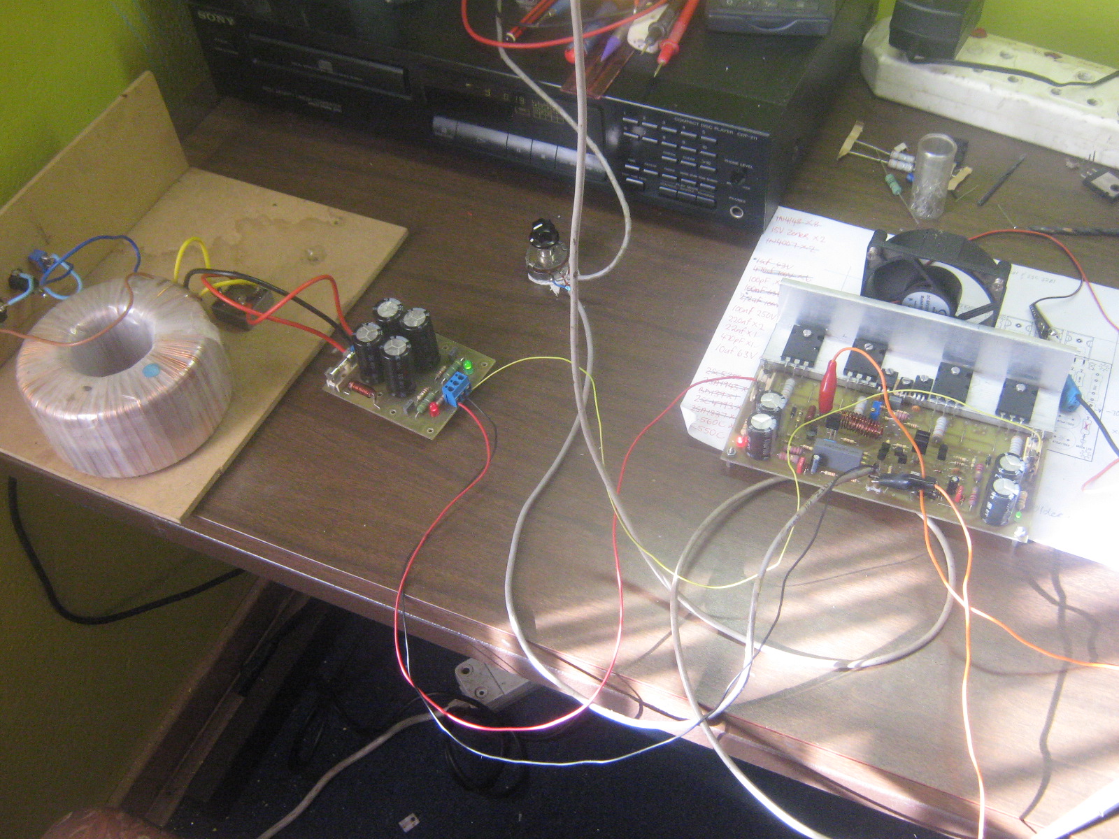

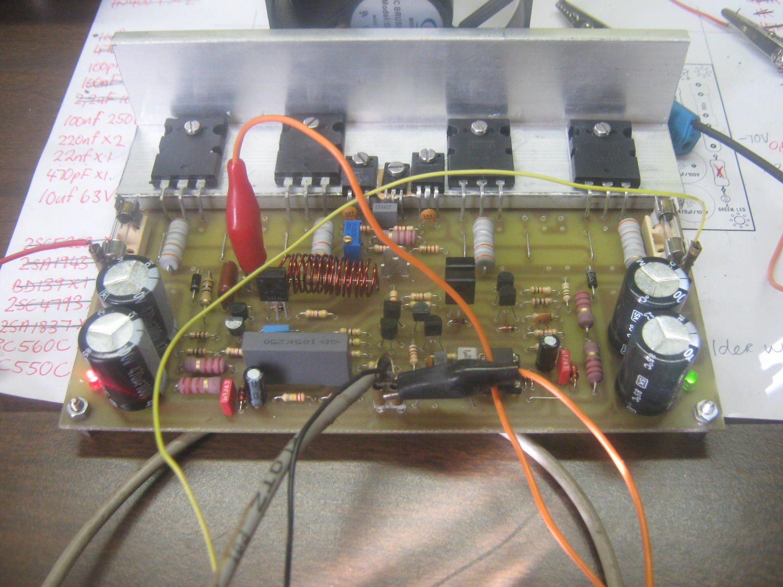

Hello Sir Apex,
I have just completed my first channel of your SR200 design. I must admit, this is one good amplifier.....the sound is one of the best that I have heard in a long time. Bass is good, mids and high very clear. I connected input straight from CD player, no preamp, and I must say, this is one excellent amp. Here is some pictures of my first channel. Planning to build second channel today. 😀😀😀
Thank you Alexx mm for a wonderful PCB design. It is easy to build and work first time. Thank you very much. 😀😀😀 Just one small request, as you can see from my pictures I only have two power transistors populated. I cannot fit a third one in this PCB. Space is a bit to small for 3 outputs. Can you modify this PCB by increasing the spacing between the power transistors, as I would like to populate 3 power transistors. 😉😉😉
One Question Sir Apex. What is the maximum voltage for 2 power transistors in output?
Once again, thank you very much Apex and Alex mm for a wonderful design.😀😀😀
Regards
MACD🙂🙂🙂

Hello,
Nice to see another SR200 Completed, We share same feelings about the sound.
Regarding pcb I too faced the same problem, So I increased the print size by 3.5 mm on all the four sides. this will allow three transistors to be mounted easily.
Happy diy.

Hello Viki_V2
How did you do this? If you increase the print size, thus the other components still fit? what about the IC pins, are they still ok?
