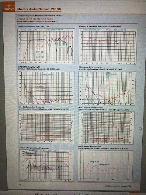

Then I got an idea . . . Why not measure the non-negative feedback amplifiers when they were connected to a real loudspeaker.
Soon, I was measuring the amplifier into an 8 Ohm load, then comparing it to the amplifier driving a loudspeaker.
Of course, I decided to measure the loudspeaker impedance and phase angle versus frequency by itself without the amplifier, and try to relate the loudspeaker measurements to the amplifier plus loudspeaker combination.
I must be sure that everyone understands, these were all electrical measurements.
The graphics were very good and very powerful, to teach about loudspeakers electrical characteristics, and output transformers characteristics by themselves, and as they were driven by various rp of various DHTs with an 8 Ohm load, and then with a loudspeaker load.
One factor that allowed me to measure loudspeakers, and amplifier loudspeaker combinations was the very wide dynamic range, and very low noise floor of the Rhode & Schwarz VNA.
I could use very low amplitudes to drive the loudspeakers, to keep the tweeters safe from burnout.
I did not use high power when I had the loudspeaker connected to the amplifier, so the measurements did not include the effects of woofers whose voice coils moved partway out of the magnetic pole pieces; nor did it include the effects when the woofer cone's outer suspension's excursion, and voice coil spider's excursion were at a point where Hooke's Law for springs was violated (beyond the maximum linear range of the suspension).
loudspeaker impedance changes at high electrical drive levels.
So that is another set of measurements that I never did.
There was No microphone, No anechoic chamber, And No acoustic measurements of any kind.
The measurements of loudspeakers Acoustic response is a completely different thing.
I think that doing microphone measurements requires some different equipment.

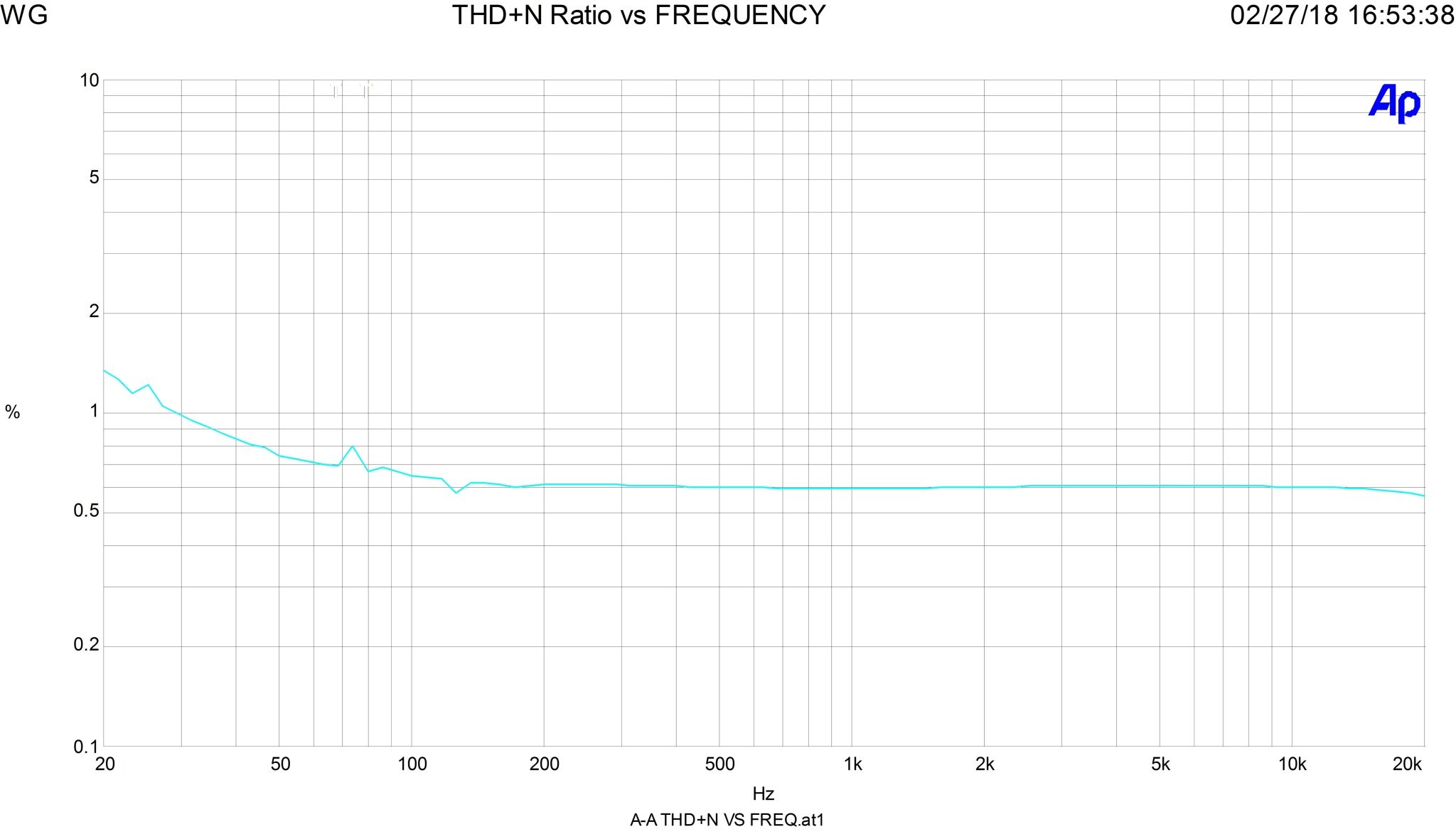

It would be nice to be able to adjust the feedback ratio while the amp is running
In post 11 a simple example of FB, 6 dB
In attach the results ( with a decent OT) , it ws built for headphone ( three different value, 10, 30 and 150 ohm) but also for a little efficent speaker
This is a response freq.
And Thd vs freq

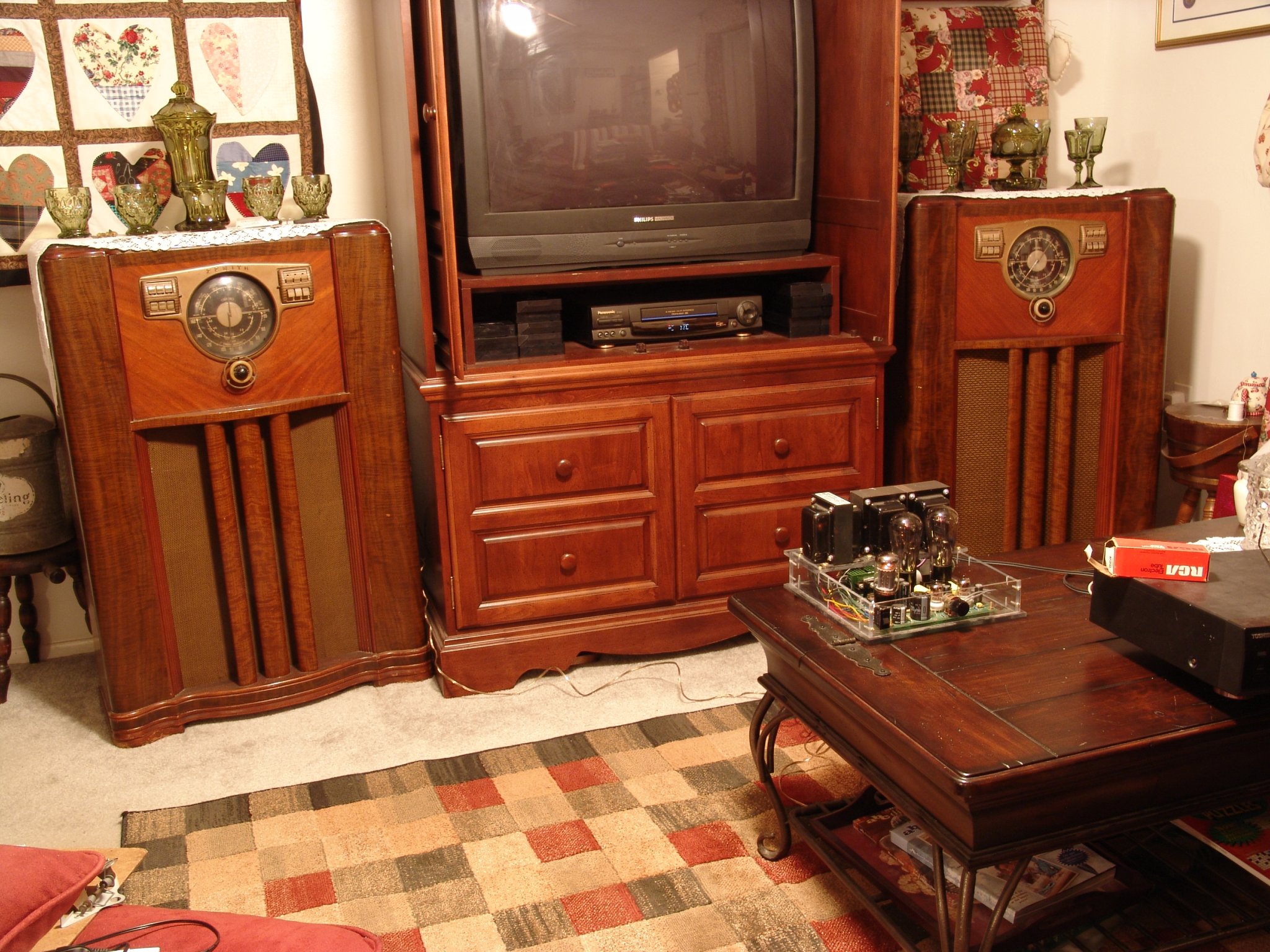

Back in the late 80's my audio flowed through silicon based life forms. I bought a pair of Yamaha NS-10M Studio monitors for my home recording efforts which I still have. The first Tubelab amp was a 45 based SET that evolved into the TSE and TSE-II. Granted 2 WPC will not rock the world through the Yamaha NS-10's but they didn't sound bad. As time passed I built a pair of DIY speakers by stuffing a pair of Hawthorne Silver Iris two way coaxial drivers into a matching pair of 1941 vintage Zenith console radios. Here 2 WPC was quite loud and the bass actually shook the (cheap sheetrock) walls.
By this time, I had developed the SSE, which is a SE amp that could run 6L6GC's, EL34's, 6550's, or KT88's in triode or UL. A pair of KT88's on 450 volts could make about 15 WPC. Connect that to the old radios and crank up some DSOTM ant you can hear the bass inside the house across the street!
I still prefer the sound of a single ended amp that makes 20+ WPC over most push pull amps. My current amp is UNSET based running a 26HU5 TV sweep tube. It makes the Yamaha's move around on the bench. None of these amps use any GNFB, but UNSET does apply local feedback around the output tube.
