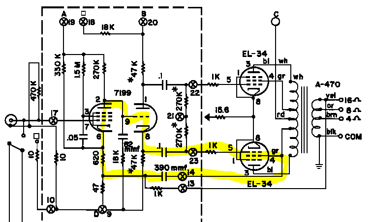

We should keep gnfb strong, the local feed back is just an option to lower the global open loop gain at high frequency to obtain stability. Not the other way around. Unless you want to build a tone(distortion) generator.
Here is a good example. Dynaco ST-70. The highlighted portion is the local negative feedback that doesn't include the output transformer. The component count is so small that the local loop is almost unconditional stable. The local nfb is through the 390pf cap. It engages only at high frequency to lower the gain before the global negative feedback.the local feed back is just an option to lower the global open loop gain at high frequency to obtain stability

I have found frustration in getting low distortion at high frequencies, clean 10khz square waves and good stability in designs where all or almost all feedback is through the output transformer. Maybe I am just too picky, but is low distortion and good square waves asking too much?@jxdking If you read through the thread you can find alot of examples where local feedback is not only what you wrote here, but can be used alone without being a tone generator.

As late my thinking is heading toward linearaszing the amplifier outside the transformer as much as possible by careful design and a strong local feedback loop (not cathode degeneration) and then providing only a light touch of global feedback through the transformer.
The jury is still out with me however if this can deliver low distortion, snappy square waves and good stability all at the same time.

My fomula is to get >20dB NFB, and let it roll off (1st order) so that the open loop gain drops below 1 at 100KHz.
Low distortion with a good square wave is hard, because output transformers over 100KHz bandwidth are rare and expensive. There will be overshoot or ringing. To get a clean square wave, you have to either drop the NFB ratio or let it roll off from a lower frequency. Both of them will harm your distortion figure. If let me pick, I will pick low distortion over the sqare wave.
