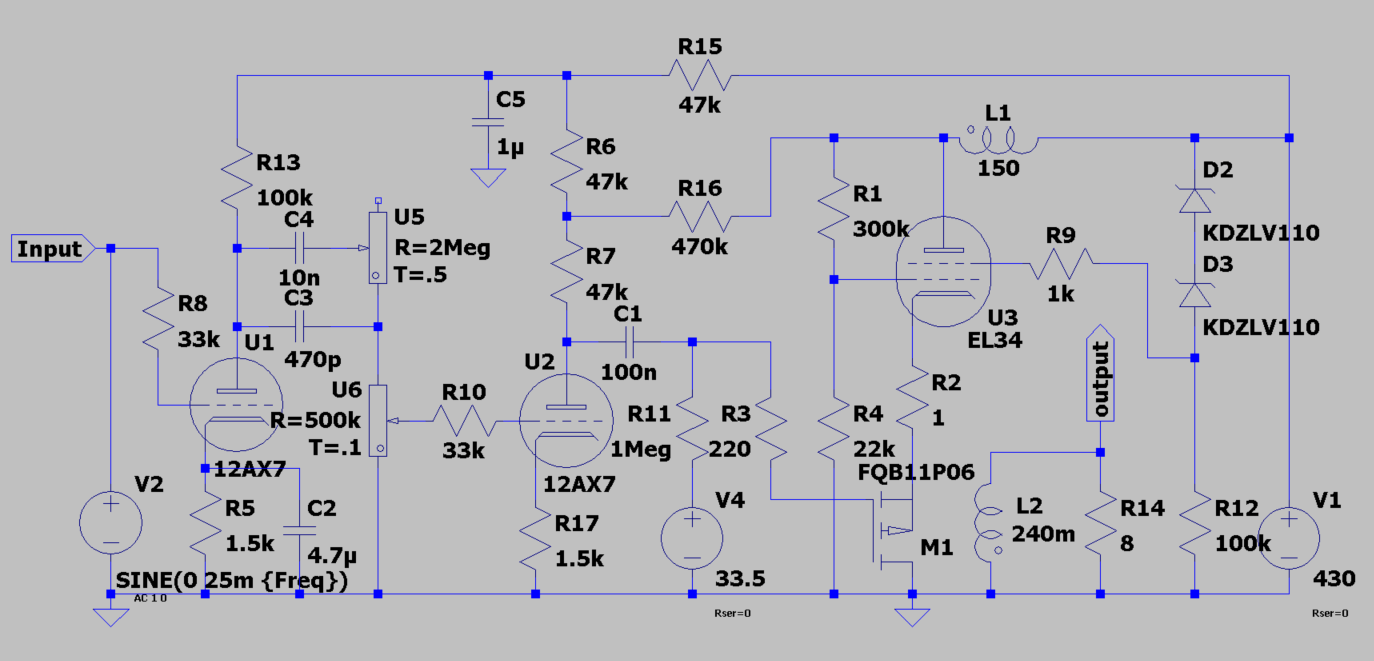

indeed the SE version of the guitar amp is your UNSET local feedback to linearize the output tube, then apply positive feedback to the driver to make it work on a CCS, plus bring back the high Zout of pentodes:

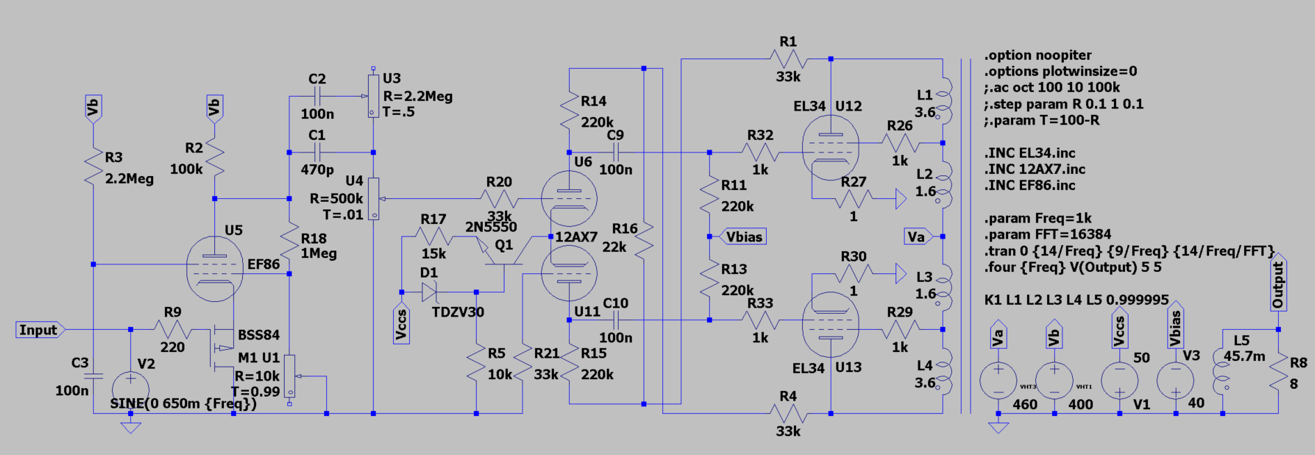

The push-pull version of the guitar amp uses 40%UL to linearize the output tubes, the applies the same positive feedback to make the LTP see a CCS load.
The preamp stage uses your UNSET to control preamp curves from pentode to triode, changing the amp character:

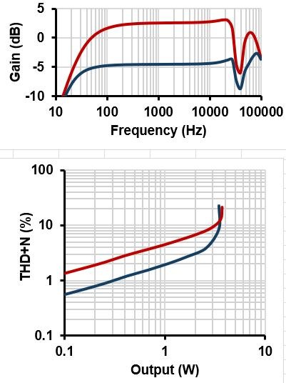

I did the same thing recently on a simple SE EL84 amp using a very cheap Chinese 5k output transformer. It resulted in about 6dB of feedback and these measured results (test signal directly to the grid of the EL84, measuring across an 8R dummy load, with and without the feedback):The Tubelab SSE board (a two stage stereo SE HiFi amp) has provisions to apply feedback from the secondary of the OPT to the cathode of the output tube. This raises the DF and lowers the THD a bit, but also seems to help squeeze a bit more bass out of a cheap OPT. No global feedback is used.
Worthwhile results and nice improvement. Thanks for the measurements.

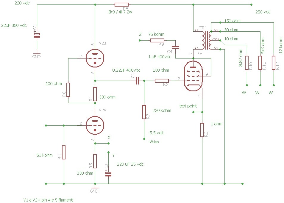

Could you show exactly how you did the connection, preferably in a schematic?
