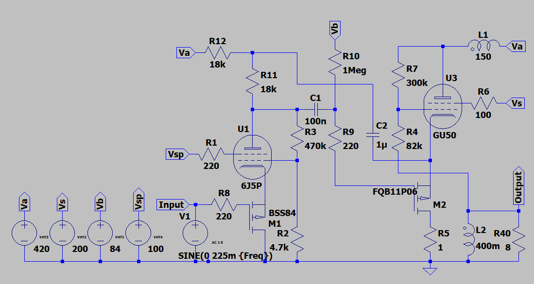

To sketch-up the idea, this is your UNSET amp with few modifications:
On LTSpice it gives 1 Wrms at 0,15% THD (20dB from 2nd to 3rd harmonic, 2nd harmonic with negative phase) and 16 Wrms at 1% THD (2nd and 3rd harmonics at same amplitude) with a Zout of 1.6 Ohm (considering 95 Ohm on primary and 0.2 Ohm on secondary).
Seems promising!
I have an Hammond 125ESE (that now is very expensive for what it is!) where I will try it with a EL34, 5k load on around 400V B+.
- Still cheap, but different tubes;
- Bootstrapped from low impedance pmos source-follower to the load of the driver make it see a CCS load;
- Increased local feedback of the output tube from 10 to 20% because of the behaviour of the GU50;
- Pmos source follower still stays below 10 W of dissipation;
- Local direct feedback dc coupled to the anode of the output tube and the secondary of the OPT instead of ground.
Seems promising!

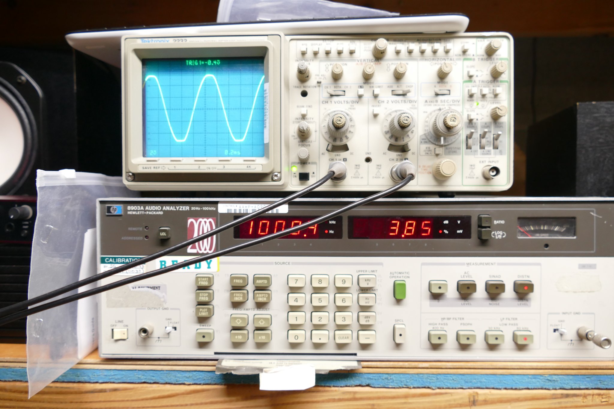

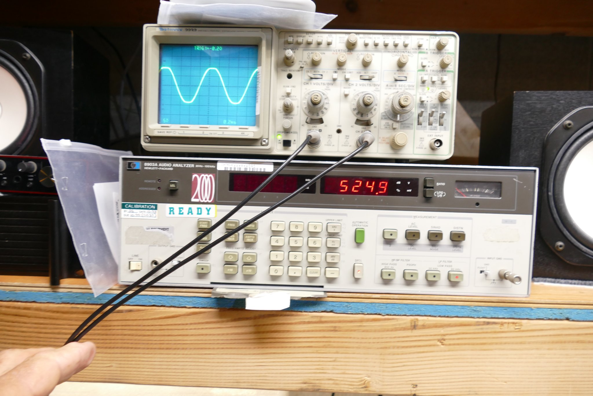

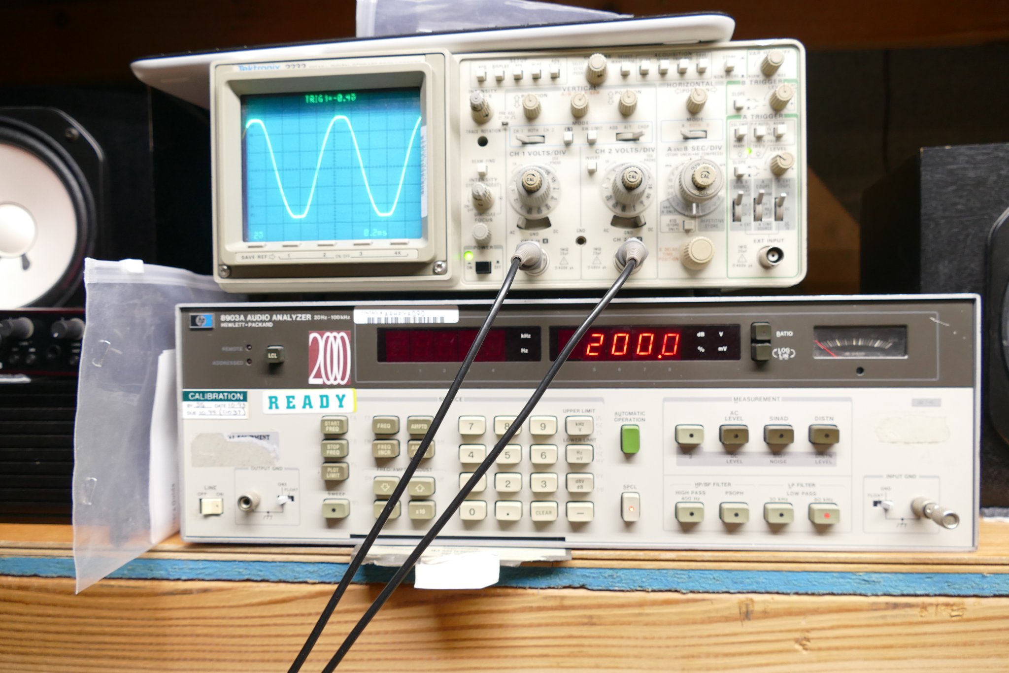

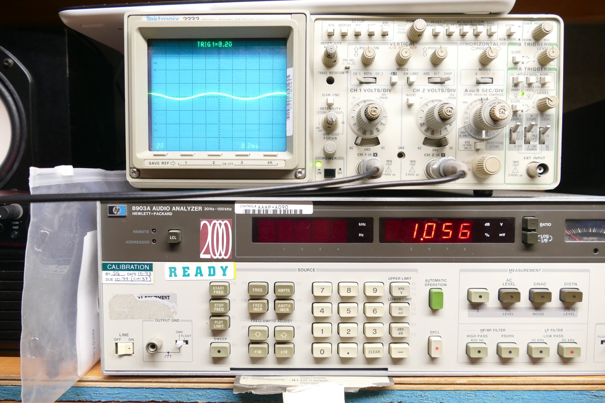

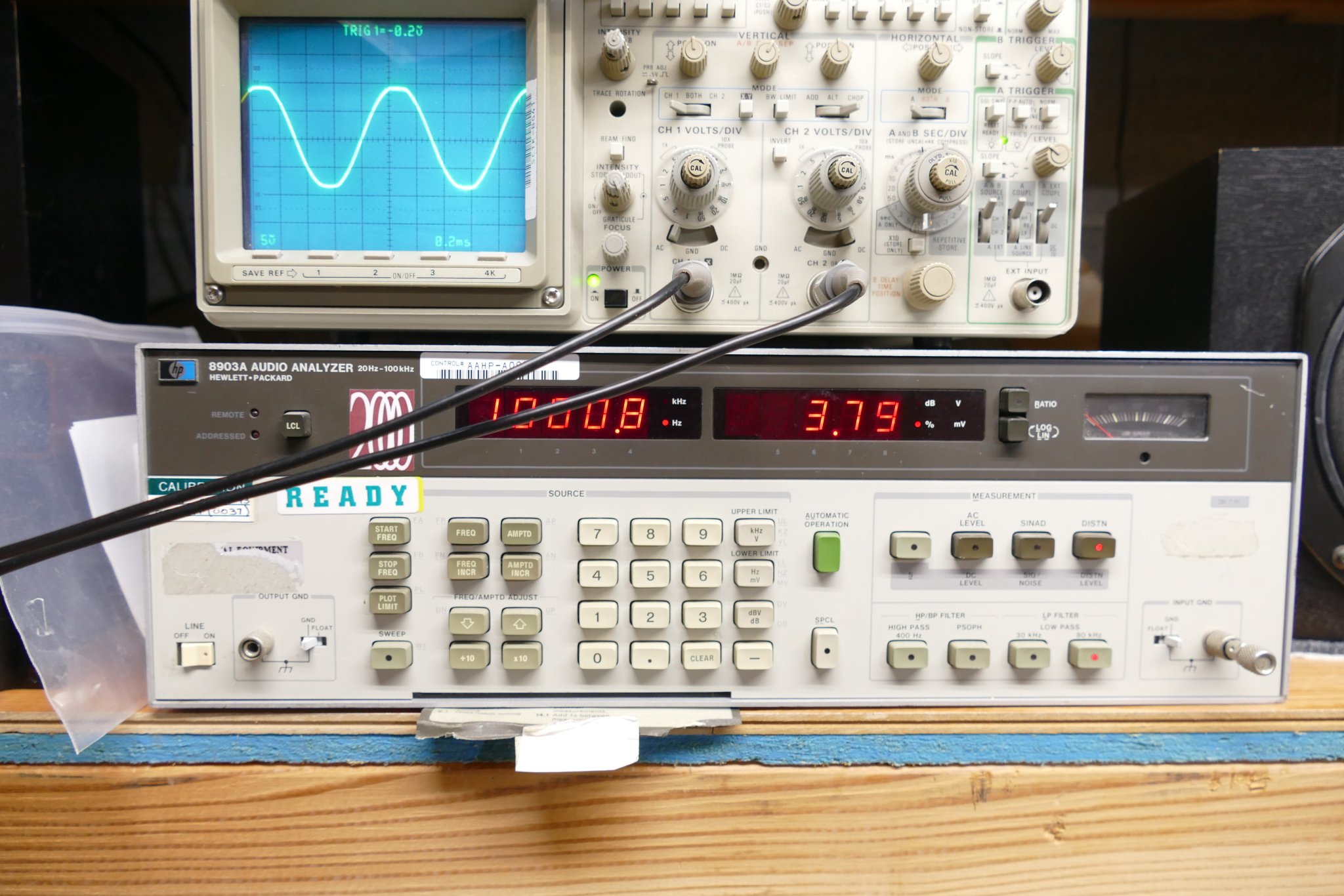

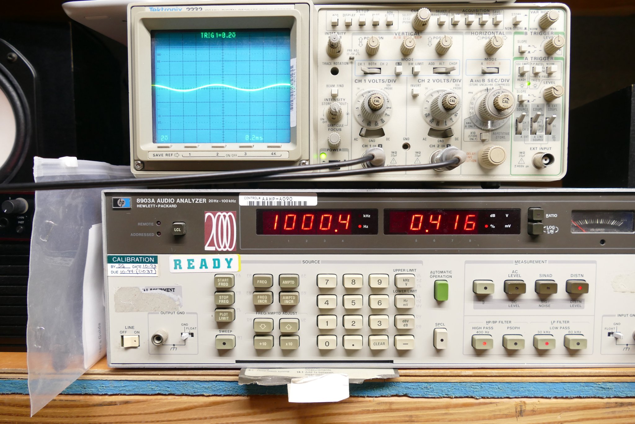

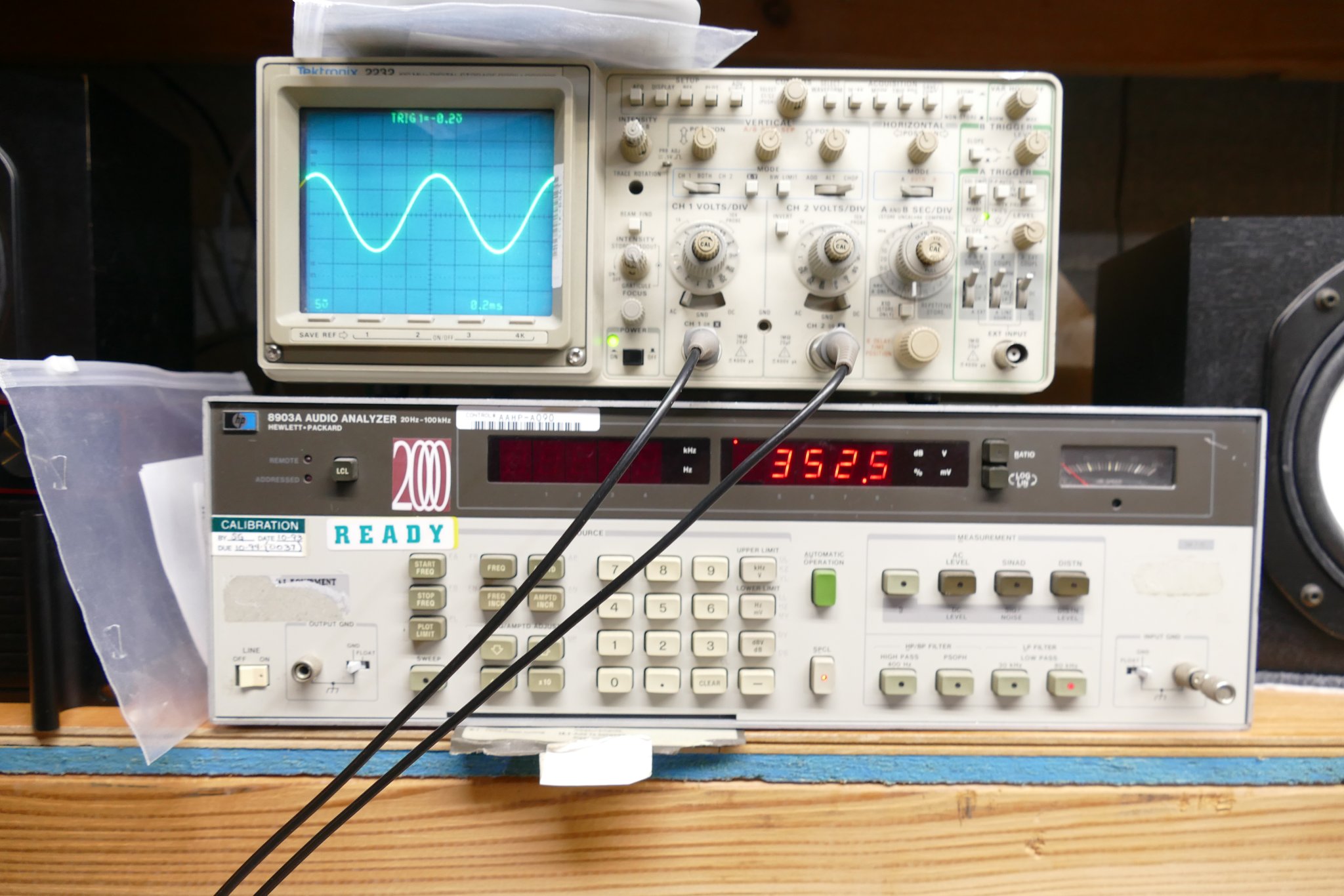

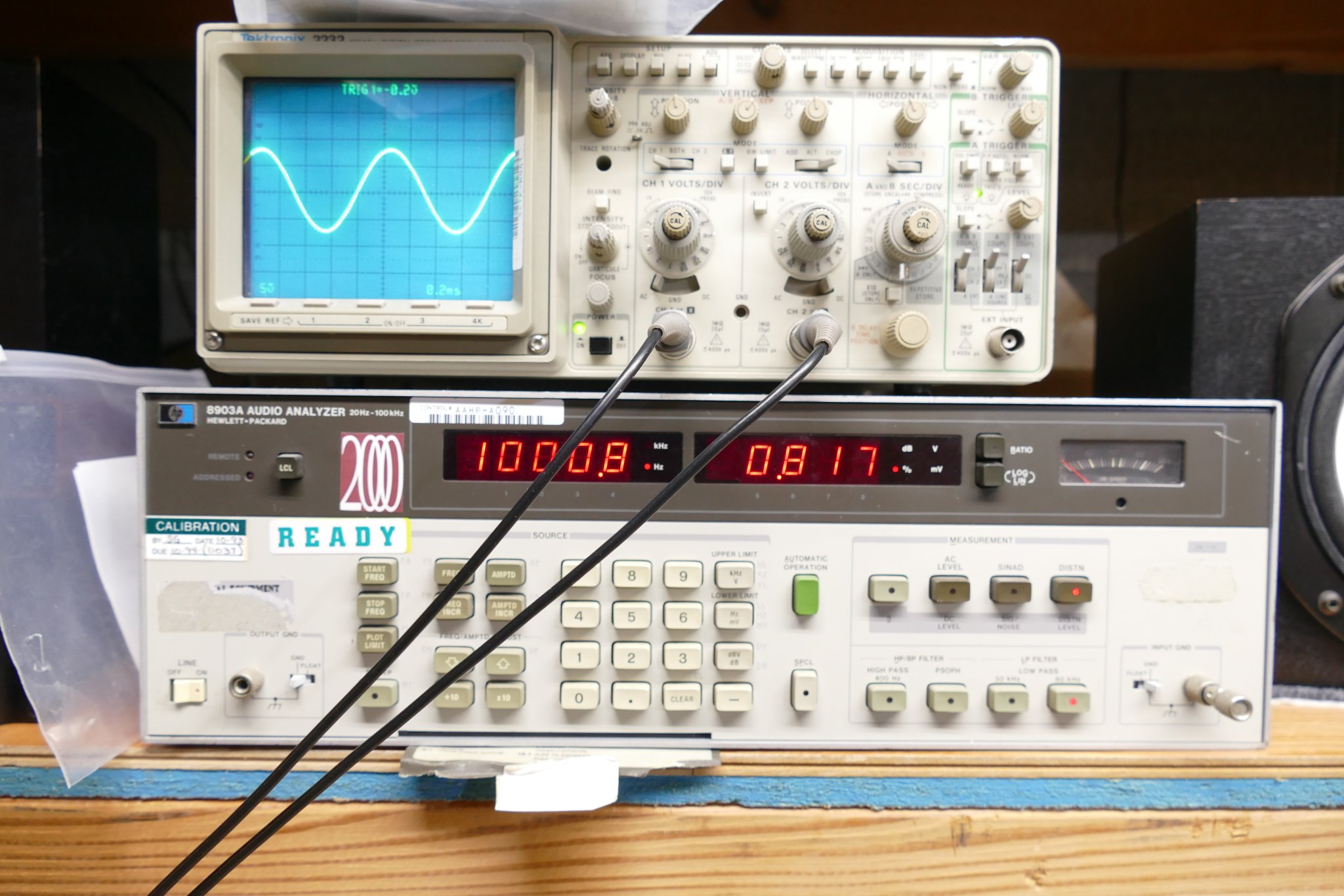

Here is the "simplified schematic" of the two stage amp board. It is the schematic of the useful stuff without all of the confusing jumpers needed to accommodate lots of different tubes. It has a stereo pair of two stage amps and a simple 5AR4 based power supply. The 5AR4 can not support a pair of 25+ watt channels, so fast recovery diodes must be used for a single board amp.

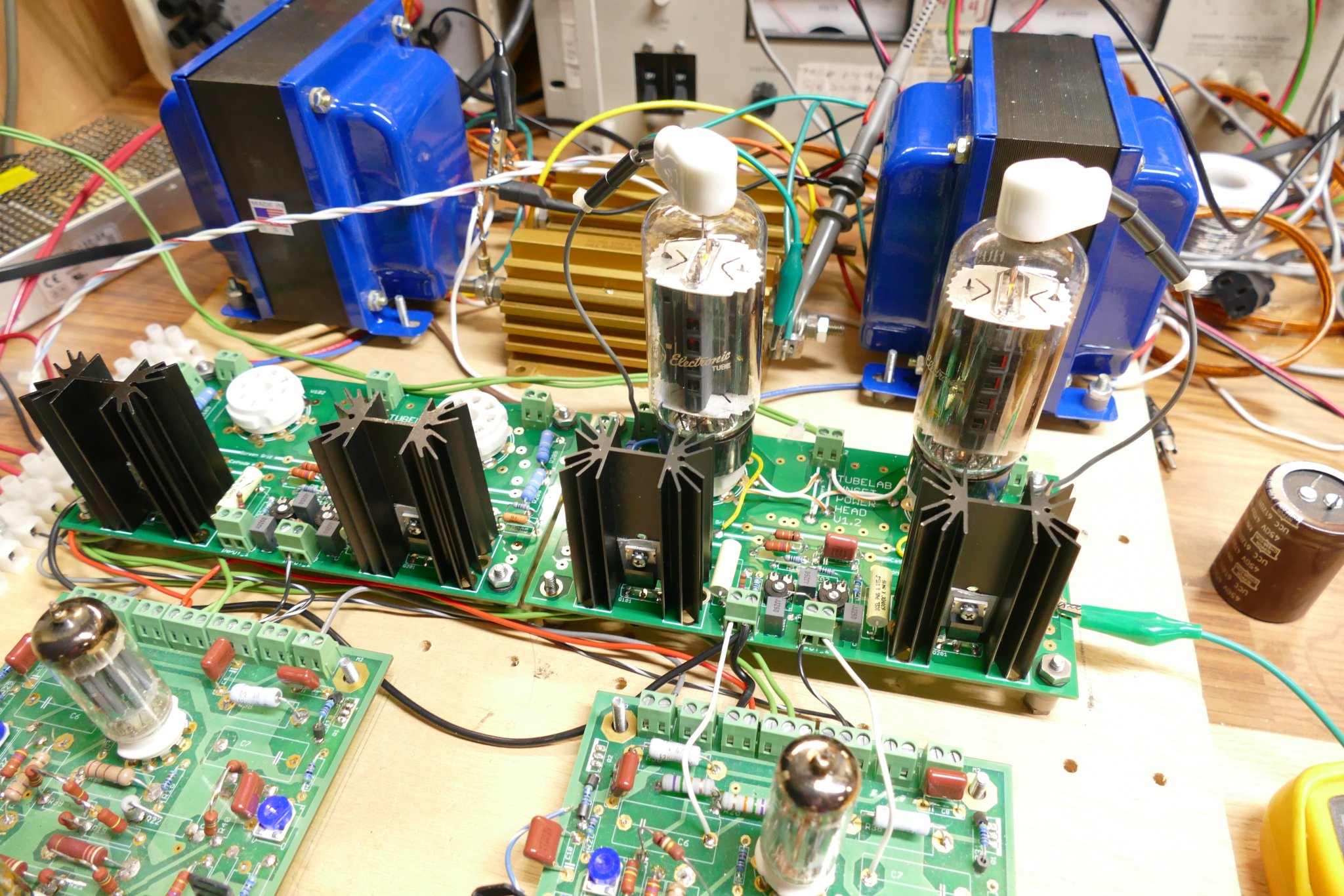

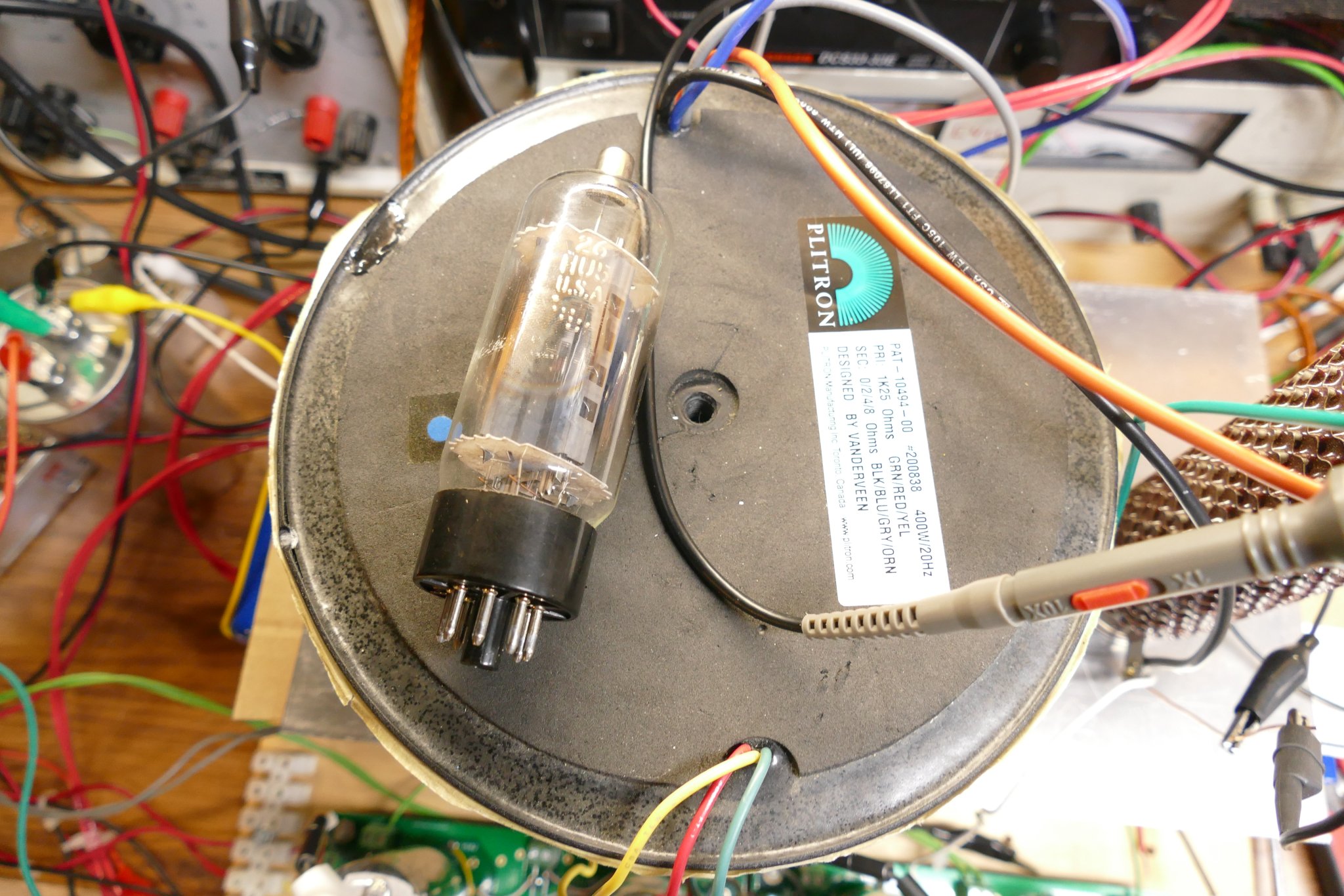

Need LOTS of power. I laid out a board with a pair of UNSET output stages, no driver, no power supply. One board can be used for an SE stereo output pair with external drivers and a suitable power supply. The fat TV sweep tubes that I like make 20 to 25 watts in SE depending on how far you bend the specs. Where these things ROCK is in push pull. I used two of the UNSET octal output boards, each with their stages wired in parallel. I then drove them with one of my Universal Driver Boards and fed it with an adjustable power supply capable of up to 650 volts at 1.7 amps. I set it at 625 volts, current knob up full.
I got the MOAT (mother of all transformers) off the shelf for OPT duty. With about 5 minutes of knob twisting, I was touching the point of clipping at 525 watts with 3.8% THD. Dialing the drive back to a mere 350 watts results in 0.82% THD. Current consumed on the 625 volt supply was about 1.25 amps. My current DUMM BLONDE idea is to wire 13 of these cheap 48 volt supplies in series. You need to remove the cap from the negative output to safety ground before trying this! I have not tried 13 in series yet, but 5 in series have successfully fed a solid state FETSET SE board 240 volts at 250 mA.
https://www.mpja.com/48-Volt-Power-Supply-3A-Cosel-LDA150W-48/productinfo/34713+PS/
A stereo amp was tested with one UD board feeding each UNSET octal output board with some Edcor 3300 ohm 100 watt OPT's. Cranking the drive to get 200 watts out gets 3.85% THD. Dialing it back to 100 watts gets 1.08% THD with 0.74% at 10 watts, and 0.416% at 1 watt. No negative feedback was used other than the UNSET configuration in the output stage. The driver tubes are 6FQ7's with one LTP driving a second LTP. Output tubes are 26HU5's. 6LW6's will make a bit more power, but 525 watts are way overkill for me, and I have more 26HU5's than any 'LW6s.
