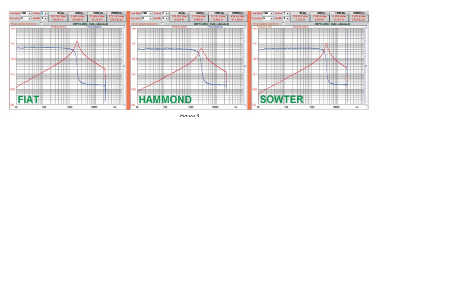

I post sometime these graph whre is displayed one test of primary coil (secondary open) for different OT
Is possible to see the resonance at mid frequency where there is the switch of the impedance module from inductive to capacitive ( also the phase)
Of course with the complete circuit the things are different but this test tell us something also how them works at low and high frequency

All of the output transformers I tested on the Rohde & Schwarz vector network analyzer . . .
The phase reversal was between 500Hz and 2kHz.
If I remember, the phase reversal was mostly caused by the primary inductance and the primary distributed capacitance.
Tubelab_com talked about the inductive effect at low frequencies, and capacitance effects at high frequencies.
And the resonances from those.
In addition, there is often a resonance at very high frequencies, due to the leakage inductance between the primary and secondary, as it interacts with all of the capacitances.

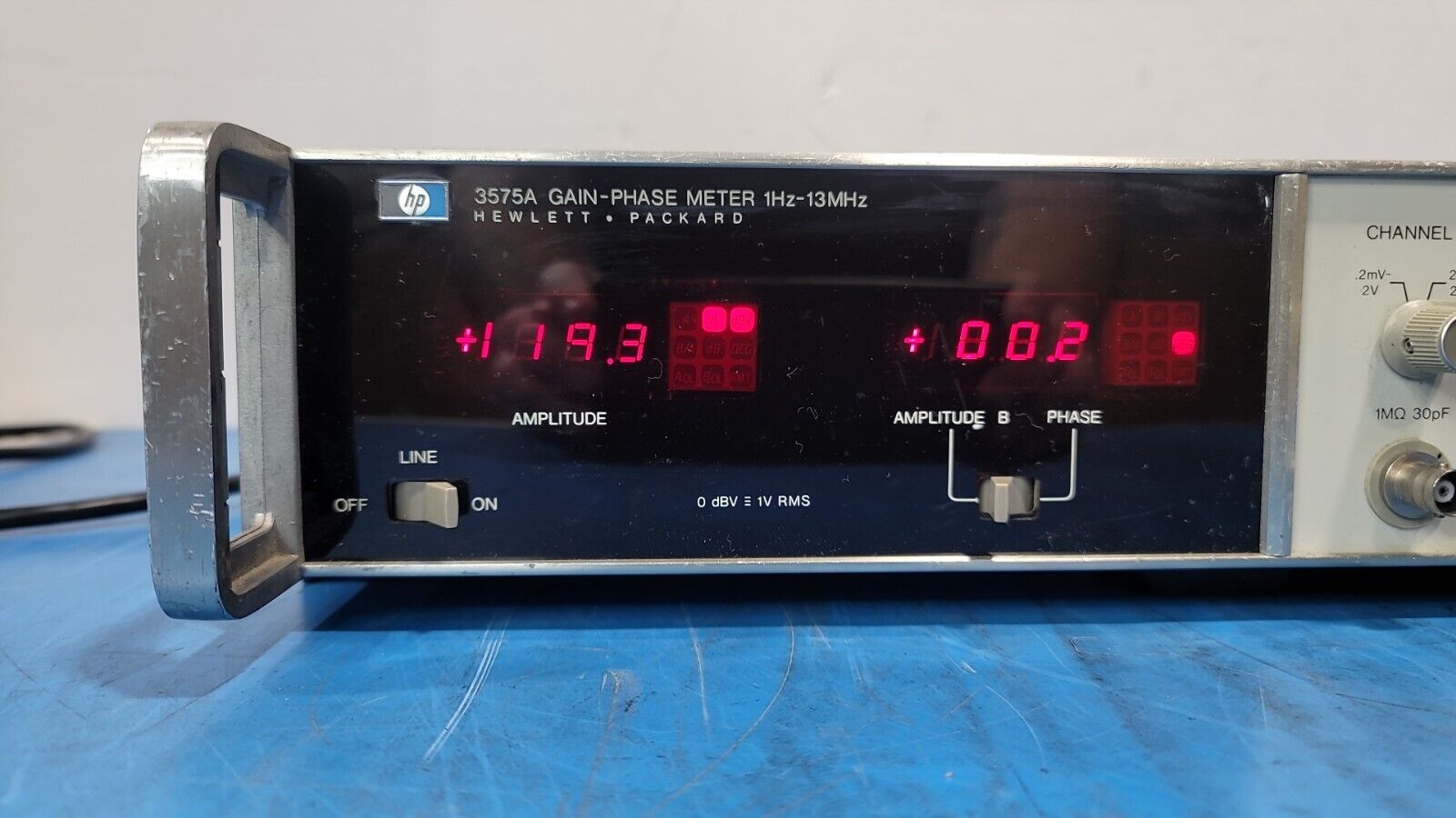

10 years ago you could get an HP3575A Gain - Phase Meter for $50, more like $175 now for a working one.
You'll need an XY capable scope for a display and a sweep-able signal generator. A Heathkit IG-1275 Lin/Log Sweep Generator works well. All things a designer/builder should have anyway.

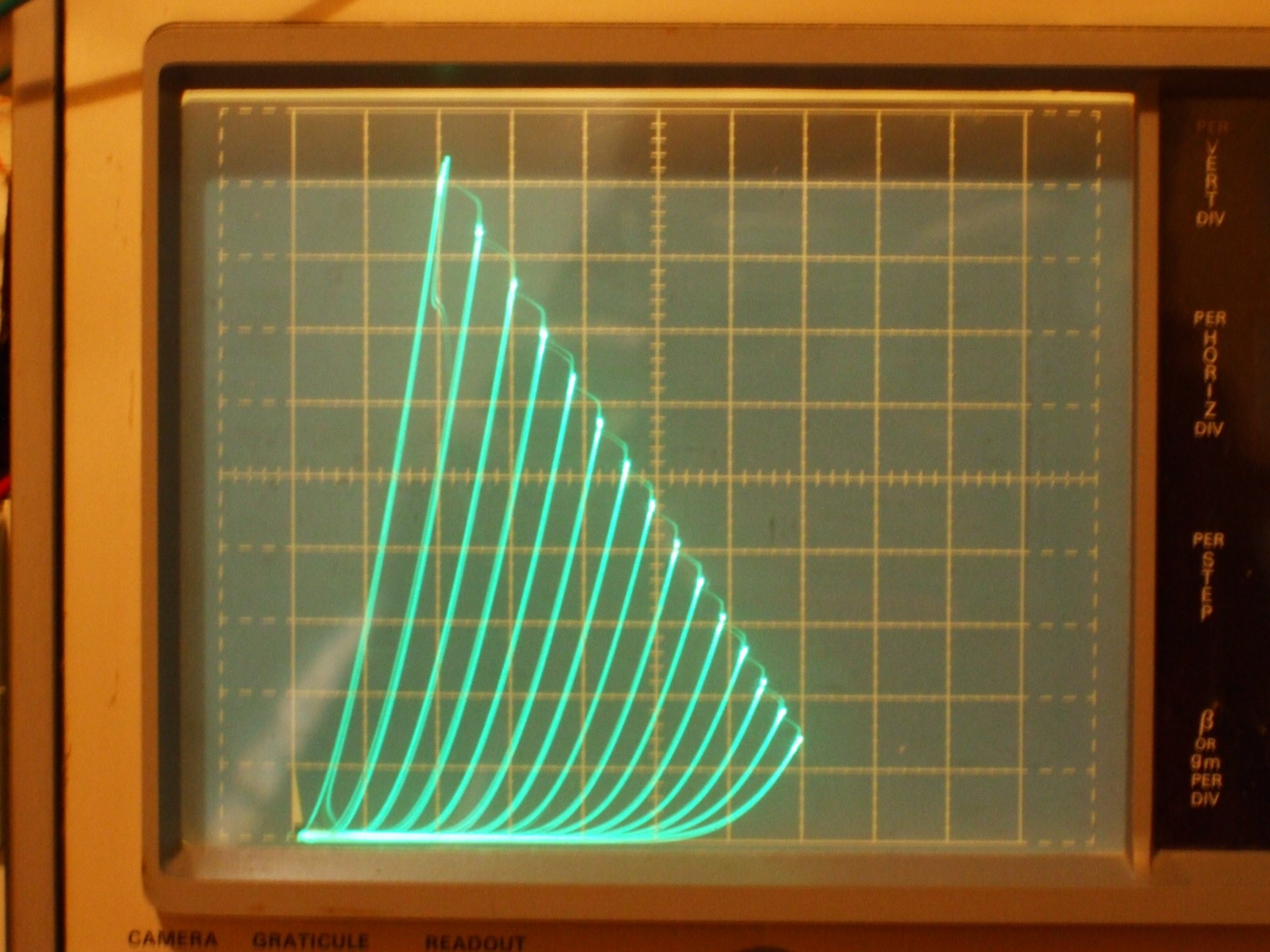

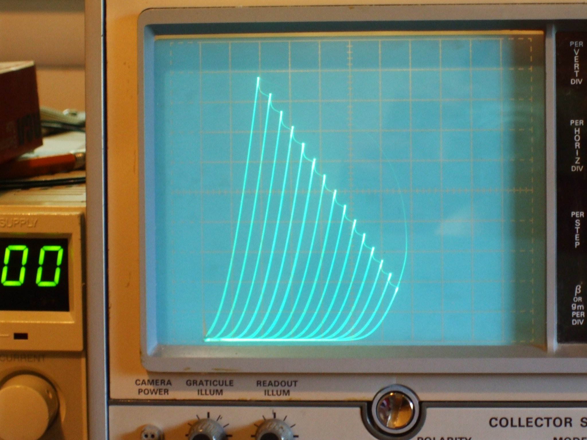

Unset 6HJ5:
standard triode configured, 6HJ5:
Unset 6HJ5:

Have you ever tested the utracer? It will for sure be needed to be modded in order to work with positive voltages.
I only have the Tek 576 curve tracer here, no uTracer or eTracer. The positive step voltages would be useful for grid2 or Crazy drive modes. You will need some current drive for them, maybe 100 mA. You only need the usual negative voltage stepping for doing UnSet curves (and usual grid1 curves). (but would need some current capability if driving the cathode directly )

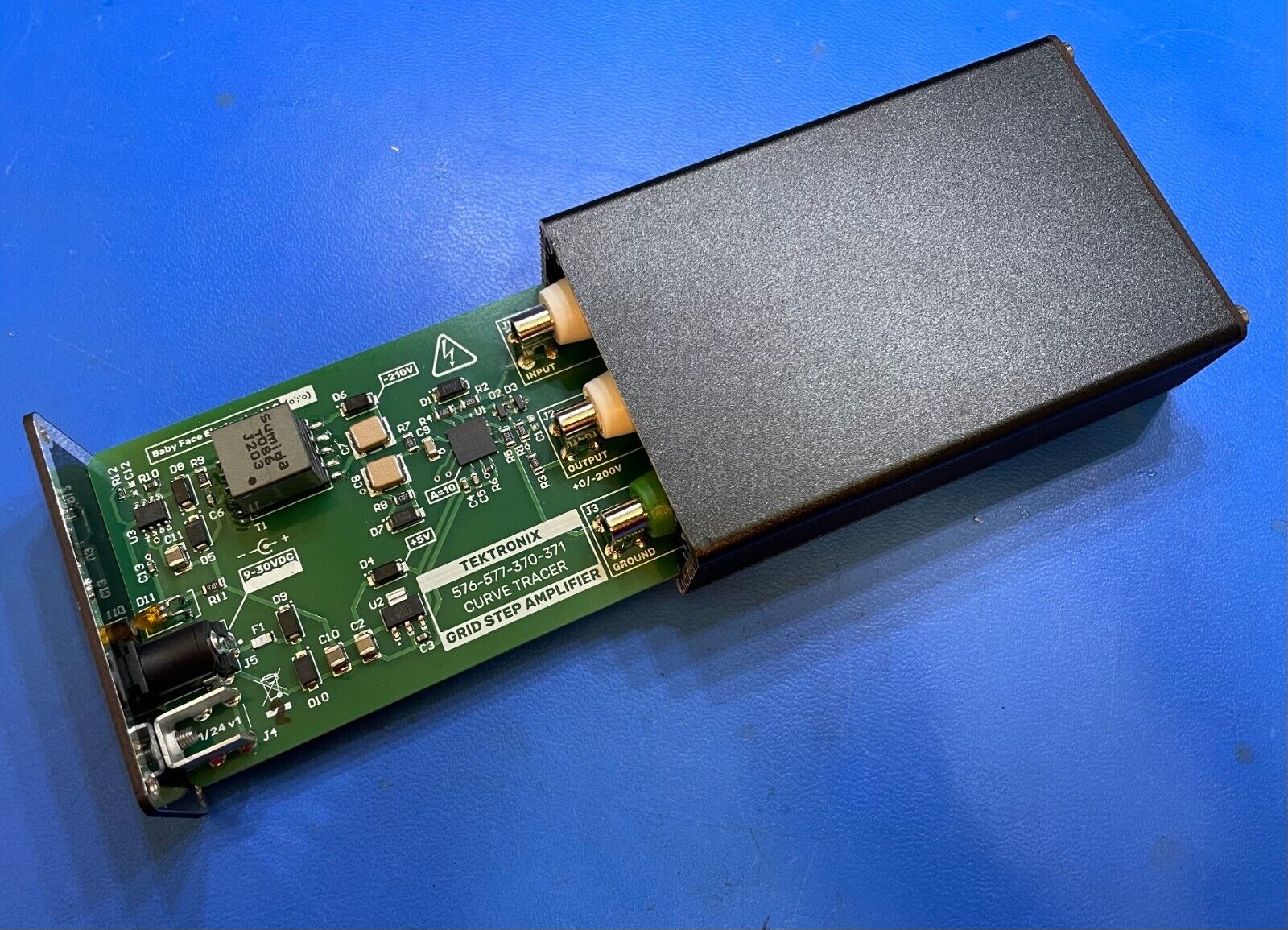

I conversed with the maker of this 10X (non inverting) grid step amplifier below:
https://www.ebay.com/itm/266781451716
and he said he would be doing a new version with + an - V capability with significant current capability too. Maybe a while though. And no doubt more expensive.
The present model uses an Analog Devices HV Op Amp chip, good for 0V to -200V and 20 mA with pretty good bandwidth. (Might work fast enough with pulsed curve tracers.)

Thanks @smoking-amp , being the p-mosfet voltage always positive (Vk=0 is the maximum current point of the loadline), how the negative voltage stepping can be used? By adding a positive reference and then step down?You only need the usual negative voltage stepping for doing UnSet curves (and usual grid1 curves). (but would need some current capability if driving the cathode directly )
Depends on where the grid1 voltage is nominally biased. (the Plate Fdbk resistor is varying that around positively too) The cathode only needs to come up to the max pos. grid1 voltage. You can run the grid1 bottom bias resistor down to a neg. bias V, adjusted so the max excursion is up to 0V when tracing. Then the cathode works between some neg. voltage and 0V. The grid1 is not drawing any current.
One -could- also arrange grid1 max +V to be positive and step the cathode from below that (maybe 0V ) up to the max +grid1 V. The stepping would then be operating in the positive range. But the cathode current is always into (electrons here) the cathode. (either way)
On the 576 you get a V offset control for the stepping range, as well as a stepping polarity (direction) push-button. And maybe an external adjustable power supply for the Vbias resistor source. I just push buttons and turn knobs until I get a good display! Can usually get it to "home-in" pretty quick.
(the external Vbias and the Offset control can be mutually adjusted to get a good curve trace set at different grid1 Vbias settings, if you want the effective avg. B+ at some specific setting -- too much bother most of the time, not much effect on the curve set )
The stepper output amplifier is totem-pole with N Fdbk. If it wants some voltage +/- X, that's where it will be, regardless of current direction. This makes for some "slop" allowance in setting things up for UnSet on the 576, but it works correctly wherever you finally end up Vbias-wise.
