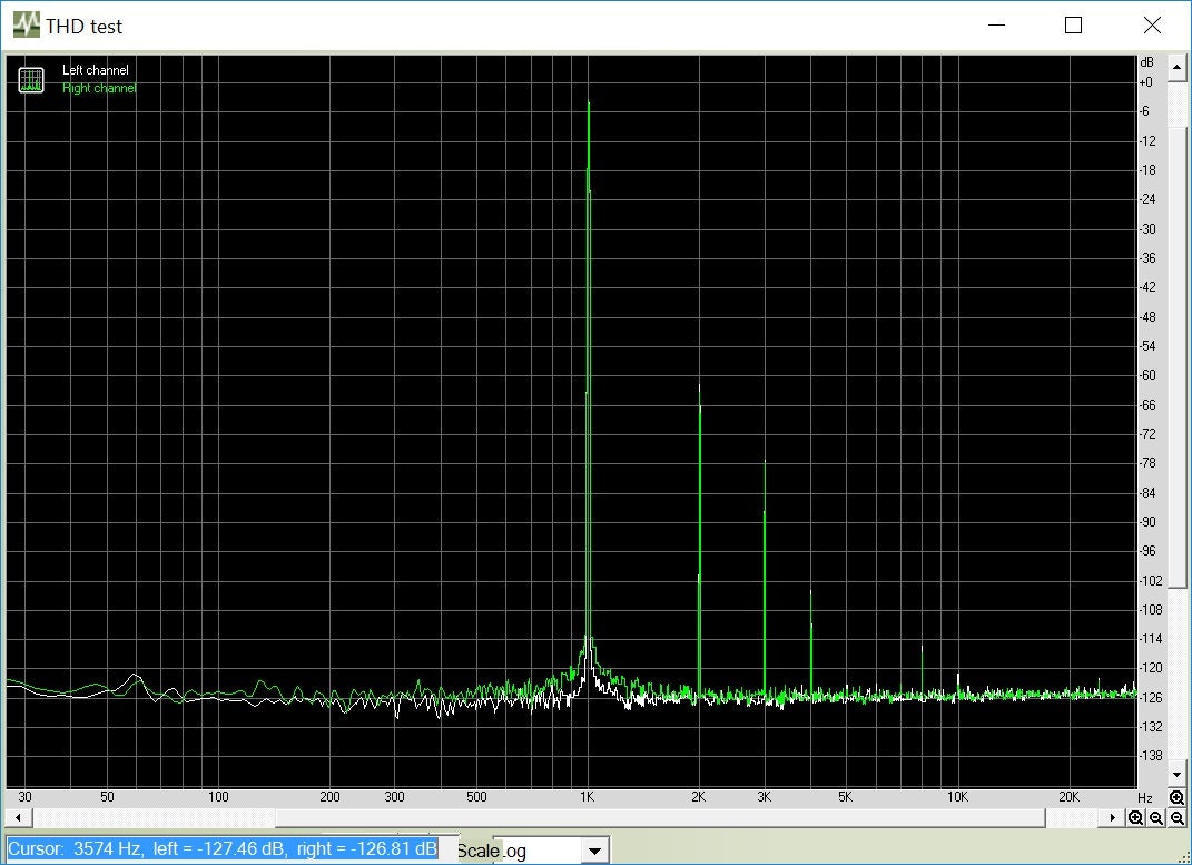

Strange Forest of Noise with Linear PSU
When a transformer saturates the magnetic flux is no longer contained in the core. This will induce voltage in surrounding parts. So adding filter capacitance really doesn't reduce this radiated noise.
If the noise comes from other transformers on the same AC power line then capacitors will filter it as the stray magnetic field is only local to the saturated core.
If you use a buck transformer to reduce the mains voltage it will not significantly lower the rail voltage.
So odd order harmonics come from saturation and are inserted into the surrounding leads by magnetic flux. Rectifier distortion comes from turn on and turn off surges and has even order harmonics. These can be treated by inductors and or capacitors.
If you don't want to use a buck transformer then you need to isolate the power transformer so the flux leakage doesn't make it to the circuitry.

Why don't you listen to Simon?
First check if your transformer does not saturate; Simon suggested how to do this.
When toroidal power supply transformers saturate, they do it quite agressively; that's their main drawback.
Often manufacturers design for high core excitation in order to maximize economics; then you have trouble in case of high line voltage.
Long time ago I had toroidals wound with 1 T of core excitation, also supplied with electrostatic screens.
Never problems with those (even lower strayfields this way).
So check your transformer first; everything else comes next.

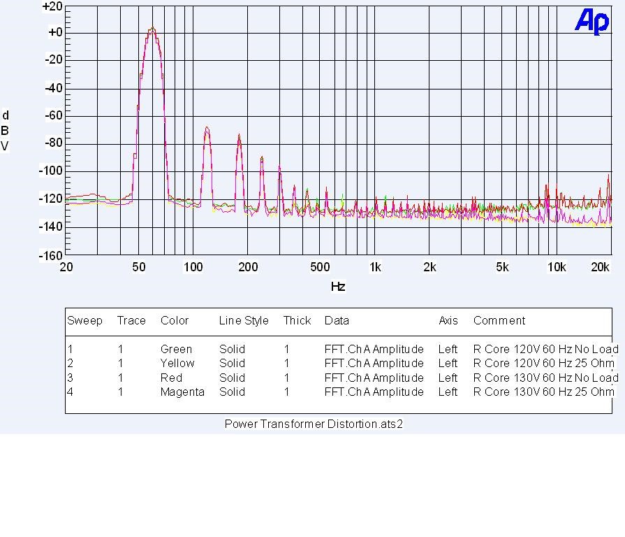

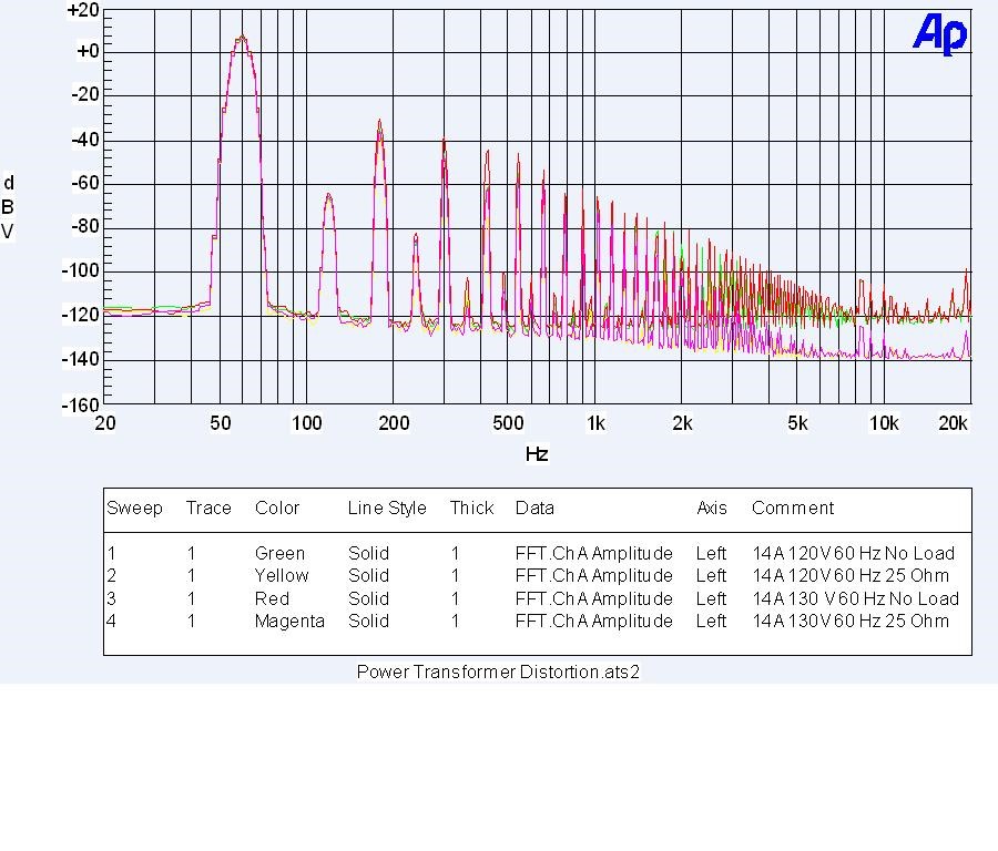

Virtually all transformers are designed to just run into saturation. It improves their regulation. The particular transformer is a cheap design and rated for 115 volts and is being used above that. Attached is what transformer saturation looks like using the cleanest transformer in my tests. It has a 220 volt primary and is fed from an amplifier producing less than .05% distortion. All odd order harmonics. The rectifiers would cause even order harmonics.
The second plot is a more typical transformer. compare that to the first post's plot.
