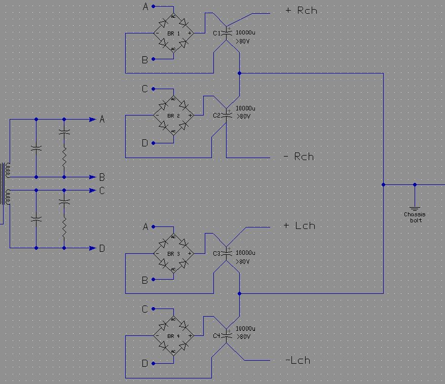

I was trying to get some isolation between the amps via the caps and diode bridges for more of a monoblock psuThanks, I was just thinking the same thing - why can't two CRC blocks be paralleled from two secondaries? This should improve stereo separation and soundstage.

No. As Mark Whitney says, you lose control of where the return currents go. The likely result is buzz and reduced stereo separation. Maybe this ought to be in a sticky thread?
You can run two channels from two separate PSUs fed from two separate sets of secondaries. Or you can run two channels from one PSU fed from one set of secondaries. Attempts to form a hybrid of these two options are frequently attempted but almost always fail, for the simple reason that two things cannot be both separate and joined and if you intend joining things you need to do it in the right way.

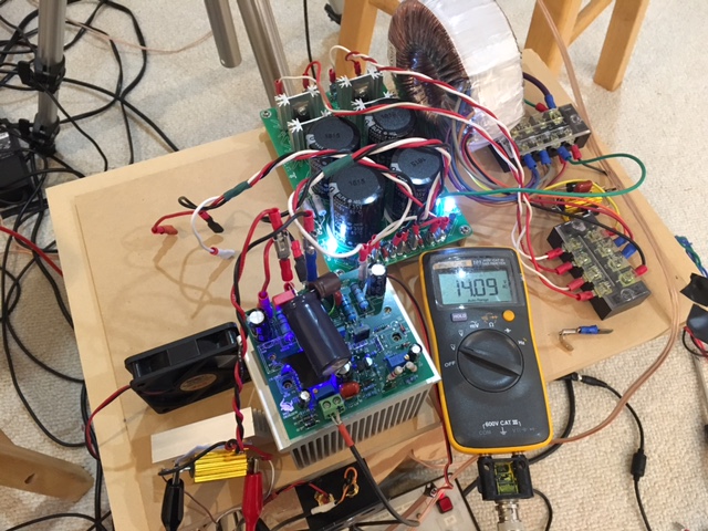

I just built a nicely laid out CRC board from this GB thread and used quality diodes resistors and caps from Mouser. The thing is beautiful but hooked it up to this setup and still getting the forest of noise. It must be trafo saturation?

iam planning on using single 600 va center tapped , dual bridge rectifier 35 A ,and two power supply pcb for stereo amp class ab(250 watts @ 4 ohm) as exactly in rod elliots diagram attached below with ground loop breaker , i just added couple of more caps for each amp , going by the discussion here is it not advisable
http://sound.whsites.net/p04_fig1.gif
another option i have is with ,single 50 amps diode bridge and connect pcb one after another totalling 4 caps each rail ( single psu), avoiding loop as in post 23 by mark
which wound be better
thank you

Nice board, i don't see any problems comming from there.
Your amp has a transformer at the input, are you shure it isn't influenced by the magnetic field of the power transformer? Could explain the big 60Hz component in the noise.
Mona
I hope you didn't use the central mounting bolt, as it looks like that will ground the dirty end of the PSU.
No, the board is only connected via a ground from clean end to the GLB on the terminal block, and of course +/- rails to each amp, and clean GND to each amp. Each amp is verified to not be in contact with chassis GND. Other end of GLB on terminal block connects to earth GND and chassis GND.
You still have parallel diodes and paths. If the return diodes, BR3/4 switch faster than the return diodes BR1/2 then the current will flow back via that pathway.

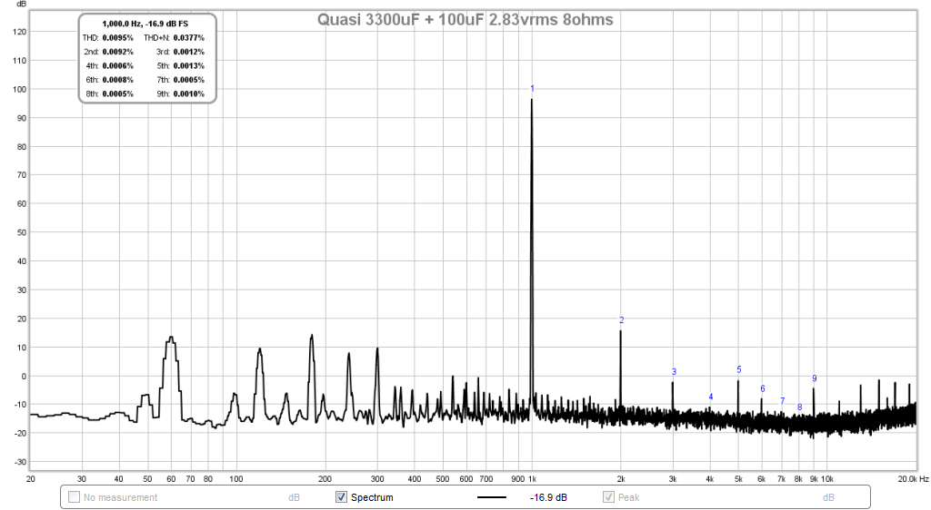

Btw, I tried my new CRC with a different brand of transformer (avel Lindberg 250VA 25vac) and different amp (Ranchu/Aksa Quasi) but using same PSU topology as shown in above post with clean ground from CRC gnd to GLB etc. and got a clean FFT no noise hash. Still has 60Hz adn 120Hz etc but its about -80dB so not audible.
Here is 2.83vac into 8ohm load driven through a 3300uF Panasonic FC and Elna Silmic II 100uF and Wima 1uF MKS in parallel (why? I was using as a headphone amp):
