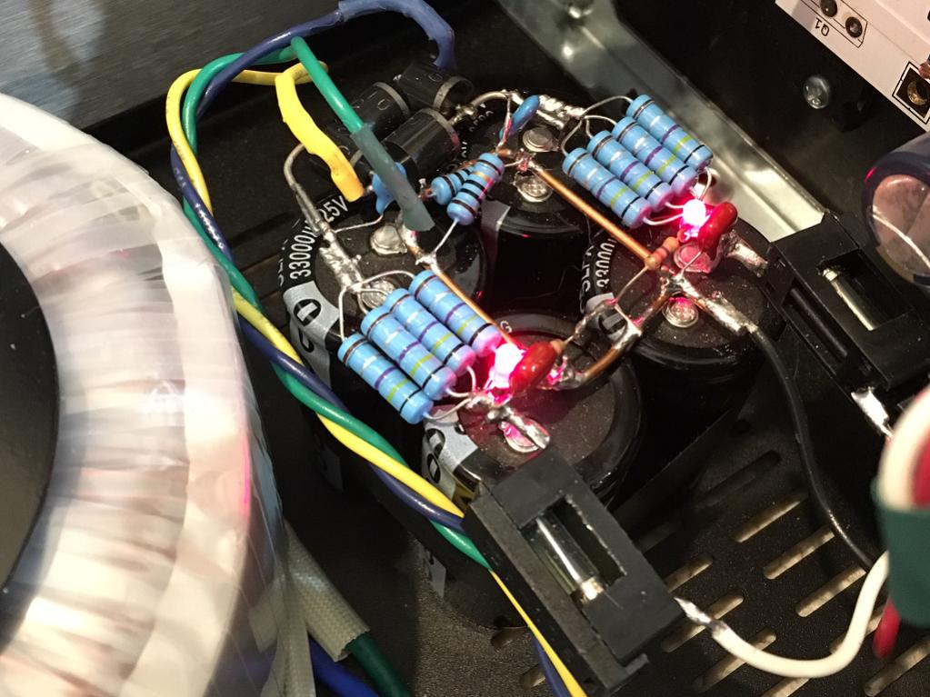

In the photo, you can see the connections from mains to trafo and then trafo secondaries to bridges and CRC (from top terminal: secondary 1, secondary 2, secondary 1 and 2 common connected to system GND and earth GND (terminals 3 and 4 linked to form system STAR GND point here),..., lower two terminals are mains supply (black) and return (brown)).
Here is a closeup photo of the diode bridge and CRC filter:

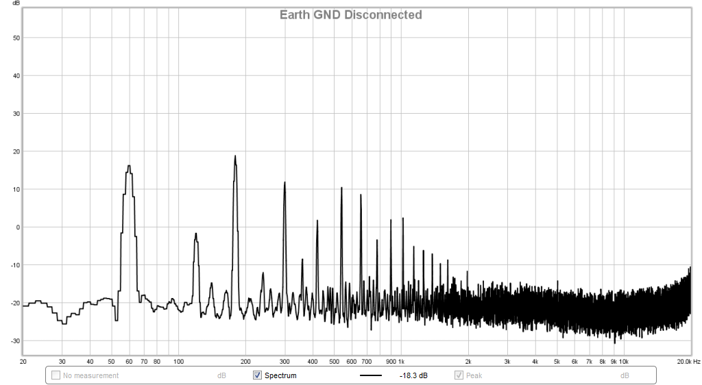

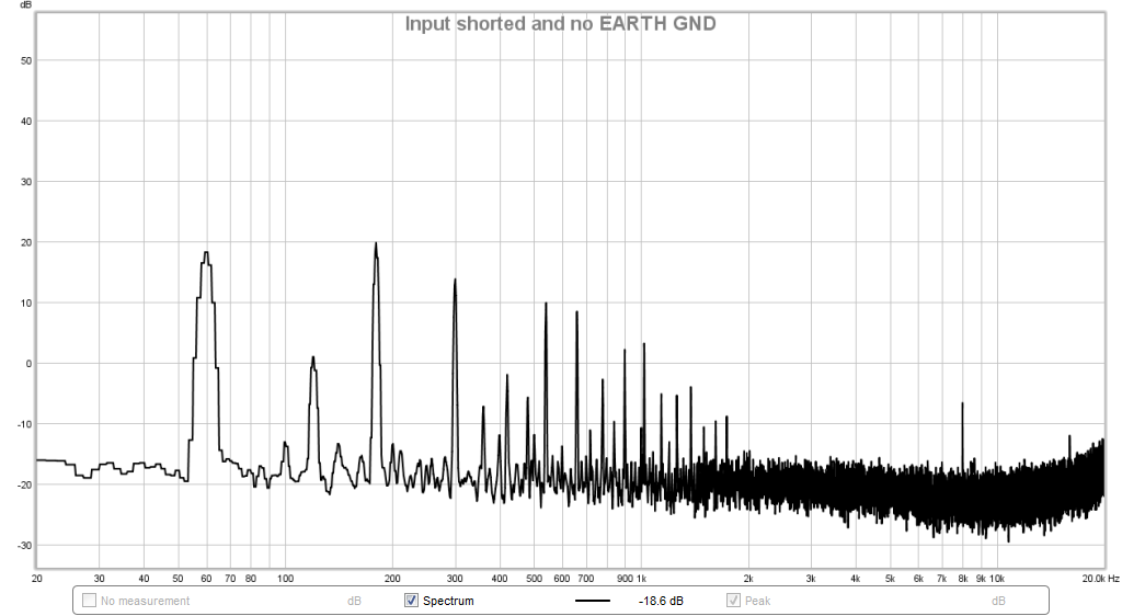

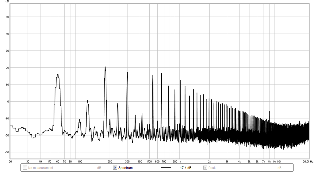

Here is the FFT of the noise at the amp output into an 8R resistive load with the amp audio input grounded. So I see this hash when I run FTT's with an input 1kHz sine. Grounding input did not help so this eliminates input noise pickup.
Here is the FFT of the noise with the earth GND disconnected from the amp - less forest of trees hash:

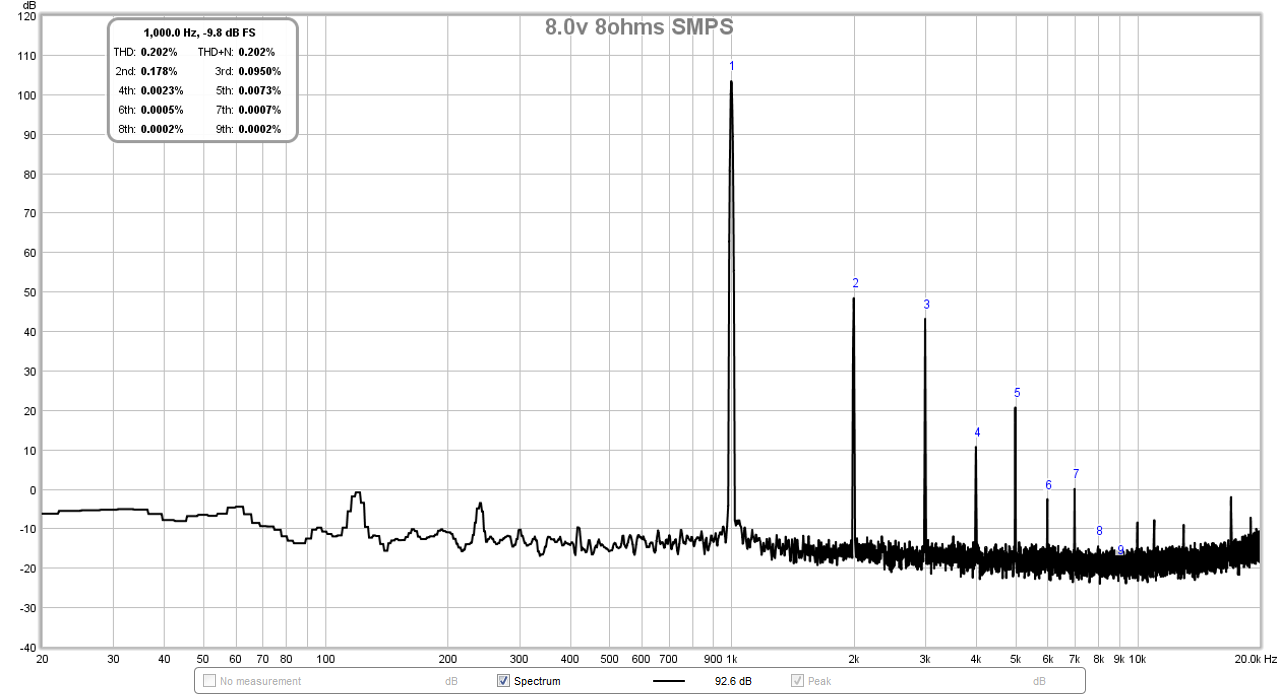

Substituting the linear PSU for a pair of 24v 5amp SMPS in series (LED light driver bricks), I get a much cleaner FFT with no forest of trees hash:
I am thinking that this is some common fundamental setup problem I am missing here. Linear unregulated PSU's cannot be this noisy, can they? Is this a trafo-cap LC ringing thing? Any suggestions/helpful suggestions to try are welcome.
Listening to it, the hash is audible as a slight hum with ear close to speaker - mostly the large 60Hz peak - which is about -60dB the audio signal at 1w. With the SMPS, there is no audible hum.

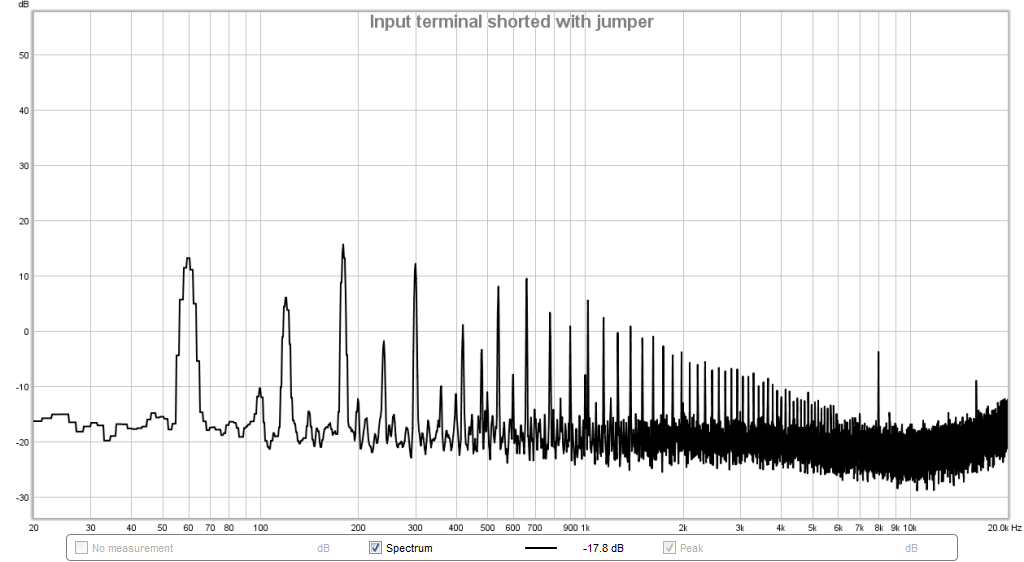

Does the noise disappear if you remove the wires connected to the amplifier inputs, and then short the input directly at the plugs/sockets on the board ?
Thanks for the suggestion, and I just tried it...
Unfortunately, no. Just tried shorting it with short 20mm piece of wire.
Connection to EARTH GND disconnected reduces hash in HF's - this is very strange - does it mean my earth GND is noisy?:

I'm wondering then if the problem is physical inducement of the 60Hz caused by the proximity of the transformer to the boards/wiring/circuitry.
Pure ripple on the rails would I think consist of just 120Hz plus harmonics. You would not see that massive 60Hz component. That's one aspect. Maybe you could look at an FFT of the rail and confirm that.
Its possible you have more than one issue as well. Something like the above and a grounding problem.
Also you need to have some idea of how good the basic amplifier design is at rejecting ripple on the rails. If this is a Class A amp then the rail ripple could be large.

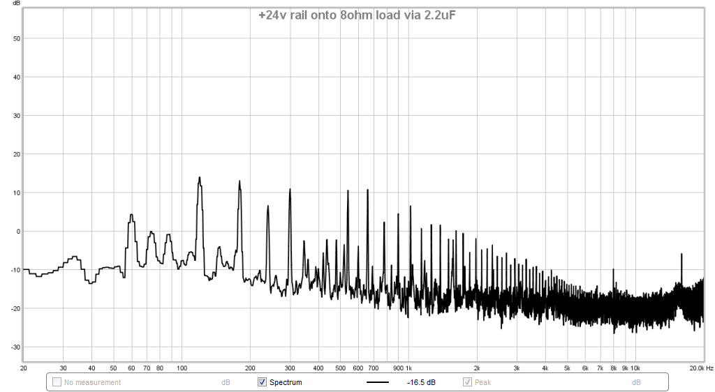

Ok, here is the FFT of the +24v rail via a 2.2uF film cap to 8ohm load. Looks like the hash is in the rail.

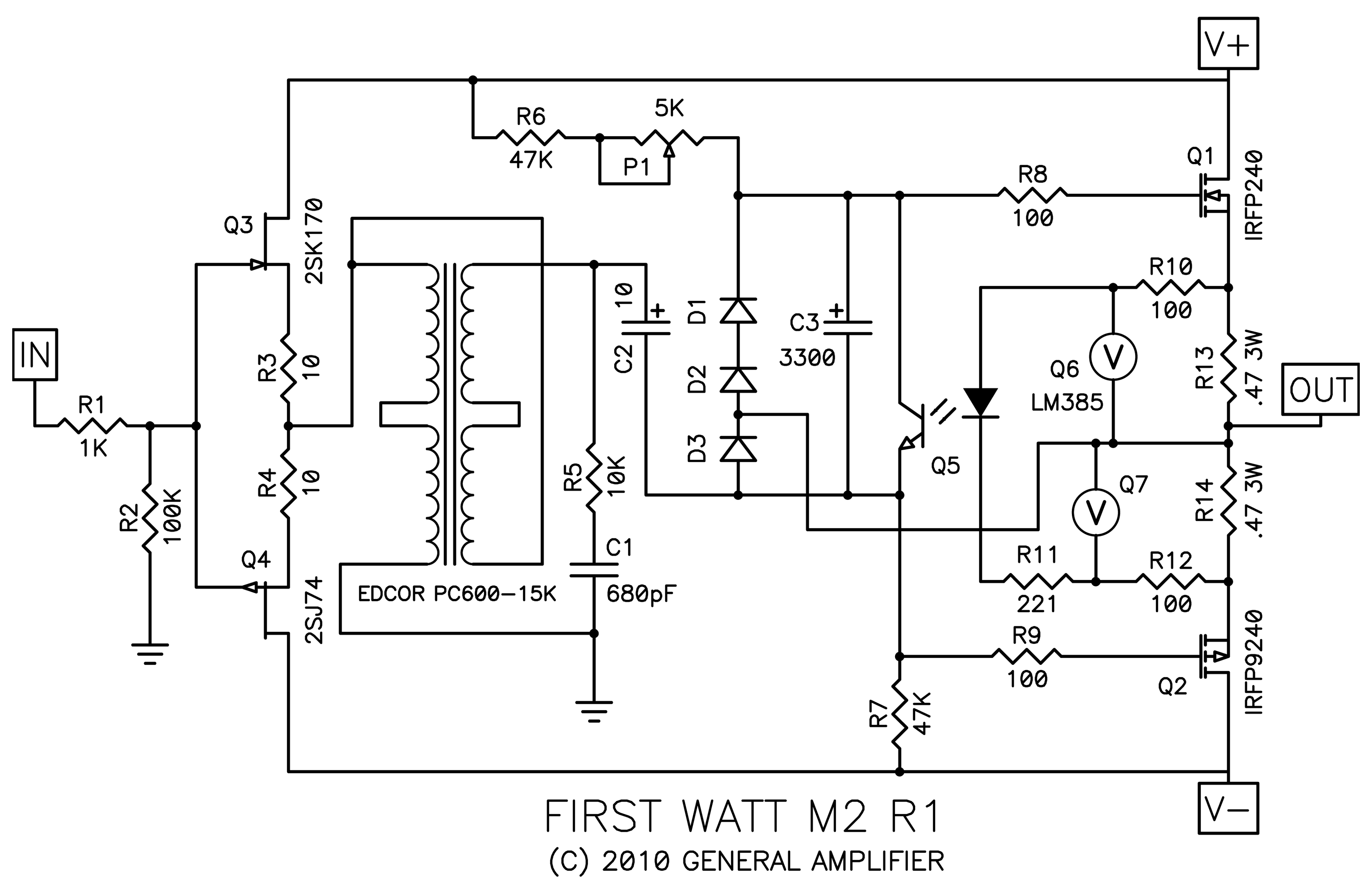

It's a Pass M2 design - pretty well praised, and I have not heard of any complaints from others about amp noise or hum. I did try to position the signal transformer at the other end of the amp away from the toroidal trafo. But then it is closer to the terminal strip with 60Hz mains. Although I did not see any FFT's posted by anyone else - mains hum is not that loud and could just be normal? Although typical noise figures quoted by Pass for outputs are in hundreds of microV range with the typical Pass F5 PSU (very similar to my CRC in values).
http://www.diyaudio.com/forums/pass-labs/281520-official-m2-schematic.html

There will always be lots of ripple on an unregulated rail, the question is how well the amplifier is able to reject that (its PSRR or power supply ripple rejection ratio). Some of very good (such as opamps and chip amps) and others less so.
Also, a 2.2uf cap and 8 ohm resistor across the rail to measure the ripple (if I'm understanding you correctly) will seriously reduce the true reading. Use a 470k or higher as a load.

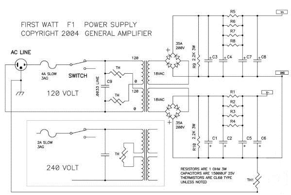

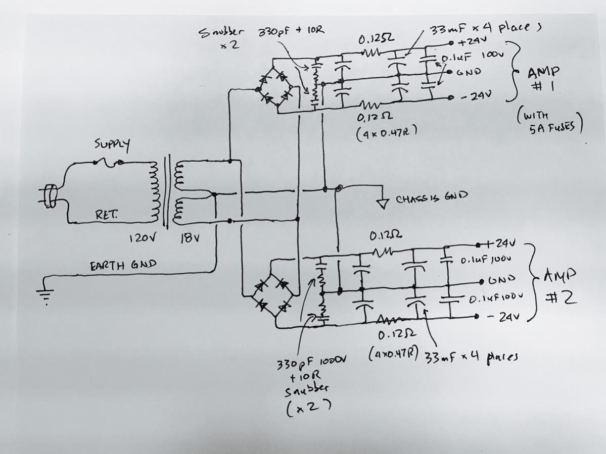

This sounds like you have tried to use two separate secondaries with two bridges then joined in series to make a bipolar supply (OK) but then also joined the secondaries to form a CT (not OK). There are two options:xrk971 said:using the two secondaries tied with a common to make +/-24vdc rails with two separate rectifier bridges and CRC filters.
1. two separate secondaries each with their own bridge
2. single CT secondary feeding one bridge
Have you tried to combine them?
This seems to confirm the above, then also seems to suggest that the ground connection is at the dirty end of the PSU.In the photo, you can see the connections from mains to trafo and then trafo secondaries to bridges and CRC (from top terminal: secondary 1, secondary 2, secondary 1 and 2 common connected to system GND and earth GND (terminals 3 and 4 linked to form system STAR GND point here),...
An accurate circuit diagram would help us, but it seems to me that you have got your PSU grounds and charging current loops all mixed up and then injected the resultant buzz straight into your audio ground.
I was trying to make two separate 24v dual rail supplies from a single CT transformer. Is that not possible then?
So to do this supply as dual mono would require two CT transformed?
The key word is 'separate', and you can not do that from a common transformer winding/s.
I don't get this, those are separate single rail supplies not dual rail
Yes, now that you mension it ,more like thisI don't get this, those are separate single rail supplies not dual rail

PSU Schematic
Here is what I did - and it sounds like connecting the common tap to GND is a no-no according to comments above. I left off LED and 4.7k resistors as indicators on the output. I need to add 2.2k 2w bleed off resistors still.
I was trying to get some isolation between the amps via the caps and diode bridges for more of a monoblock psu to enhance imaging and soundstage. Imaging does sound better with this method than a common CRC for both channels. Maybe all I need to do is break the secondary CT connection to GND?

You don't need centre tap to Earth ground connection for a start. Sorry you've already been told that. Have you disconnected it, see if it helps?
Should I break CT connection to main GND connection as well? Basically only use the two ends of the secondaries.
