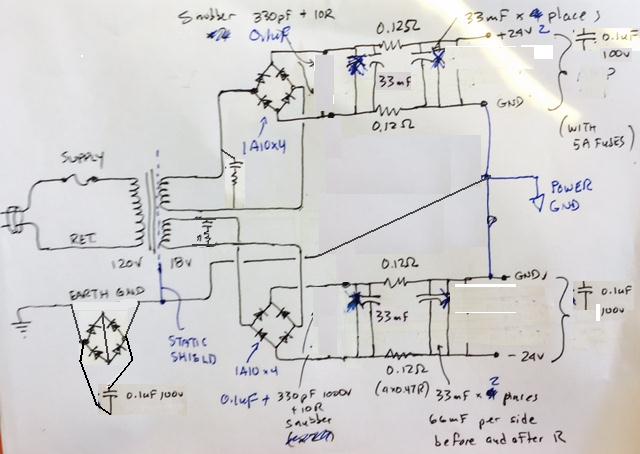

I rebuilt my PSU just like the diagram above except with just 33mF on each side of the R in the CRC and connected the clean GND together, dirty GND is connected to EARTH GND
Which dirty GND is connected to the chassis? If both you have connected the two halves at both ends (clean and dirty). If just one you have now ensured that your audio ground is dirty. Nothing whatsoever should be connected to the dirty end of a PSU. It is not surprising that the problem still remains.
Show us a circuit diagram of what you have done, not a photograph.
I was trying to make two separate 24v dual rail supplies from a single CT transformer. Is that not possible then?
So to do this supply as dual mono would require two CT transformed?
If you look closely at the transformer you will see that the CT is actually the joining of the two secondary windings.
With care, you can separate this common connection, add an extra wire and end up with two separate secondaries, which is what you want.
Now you can end up with supplies as per you diagram.
The two supplies can now be commoned at the load end of your circuit and you are good to go.

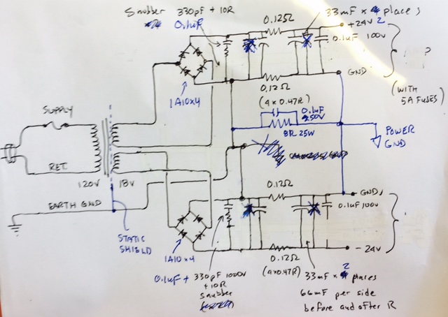

Here is the modified PSU schematic. I believe I incorporated all suggestions from folks:
1. Two separate full wave bridges (they are very compact P2P jobbies at the back of the CRC stacked on top of one another - two diode rings 8 pieces total. Hard to see without closeup, but yes there are two full wave bridges.)
2. Dirty ground to chassis isolated from clean power ground with 8R(25w) and 0.1uF 250v film GLB (I have 10R but it's kind of big white cement filled one that doesn't quite fit in that space so figured 8R is close enough). This GLB is similar to the one suggested on the ESP website.
3. Power ground tied together at clean end of CRC and uses star topology from that point out to each amp.
I wonder if the problem may be the brass standoffs and screws that mount PCB are connected to board's (clean) ground? Need to check to see if Teabag's layout does this. If so will have to switch to nylon standoffs.

You need to remove the two connections from the dirty ground end of the PSU. Any ground connection to anything else, via GLB or not, must come from the clean end only. We keep telling you this but you seem reluctant to take it seriously.
Be aware that the white cement filled resistors have poor overload capability. If shorted across the mains they could fail or explode before the breaker trips.
If the circuit boards have separate connections to chassis then these need to be removed as well. Grounding needs to be designed, by thinking about where the currents go. Once you understand it you will find that it is not difficult to get near-zero hum and buzz.
The schematic shows a completely different setup than the last photo you posted.
The photo has 4 diodes and the transformer is configured CT. The schematic has 8 diodes and transformer balanced.
Draw what you have built, add amp and source grounds as well.

I have said this before - there are 8 diodes forming two separate full wav bridges there - you must not believe what I say.
The schematic is drawn correctly except for inadvertent dirty to clean ground connection on CRC. Doesn't matter anyway until I remove the dirty ground connection to the CRC completely as DF96 suggests.

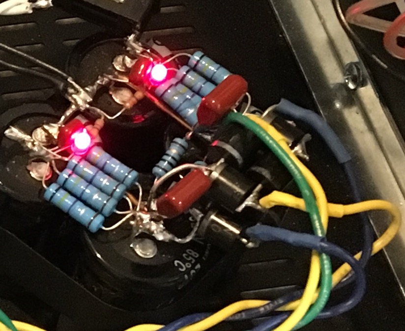

Here is closeup of the two bridges. You can see two bridges lying on top of one another.
Note that there are two sets of yellow and blue wires. Each goes to one independent secondary winding.
And I said I am not using white cement resistor. It's the 25w gold anodized heatsinked one in lower right corner of earlier photo.

You want ONE effective (busbar) common ground point, ie cabinet, PE, transformer shield, DC supply earth common and input grounds all low impedence connected to ONE low impedance conductor/plane.

I'm still concerned you haven't used a bridge in the GLB as shown in the ESP pages
Ah - sorry it was late last night. Missed that. Never saw a bridge all by itself between earth and ground. Can't I just use two diodes in opposite polarity connected ? We do this all the time at the PCB level with 10R ground lift resistors and two diodes.

Yes, a bridge is generally used because they are nicely packaged high current diodes
