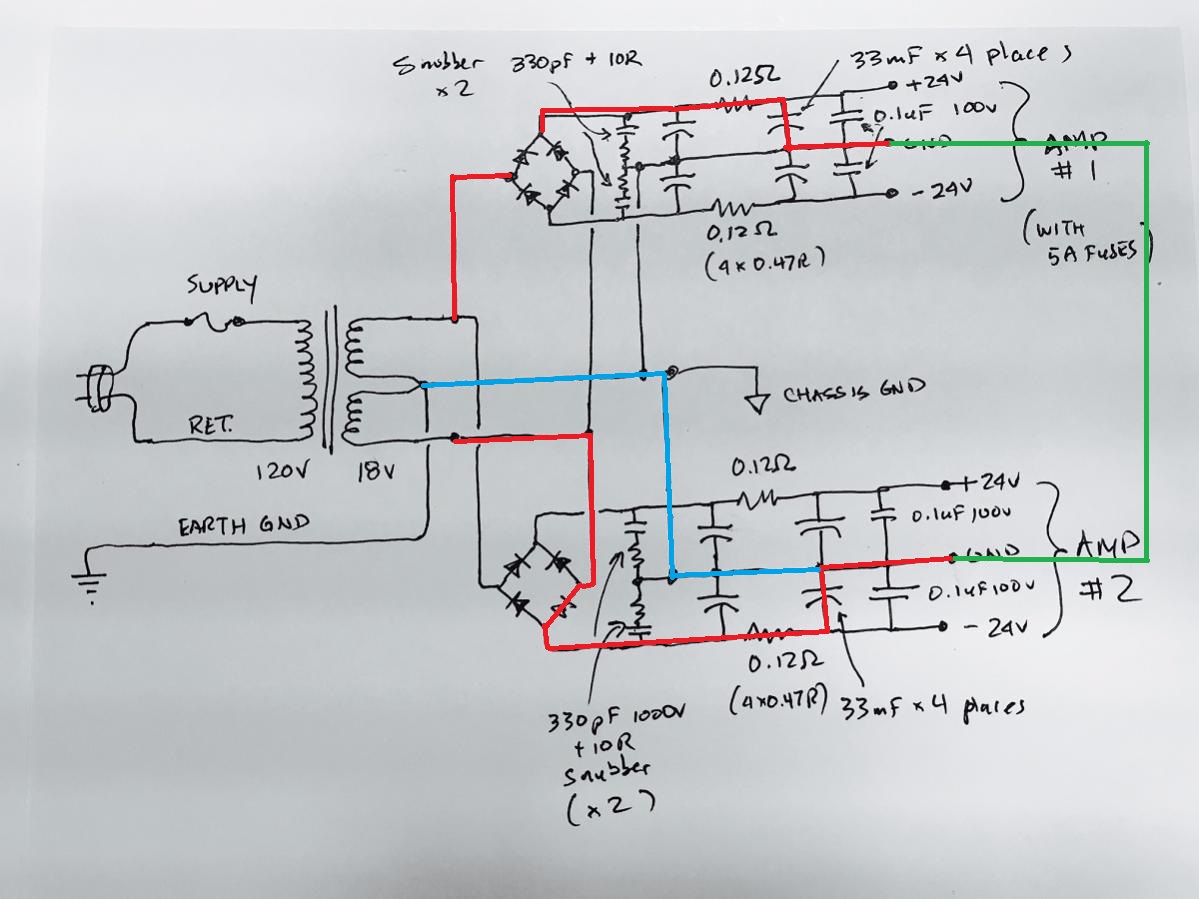

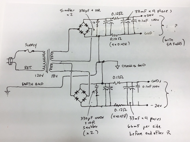

Here is what I did
OK.
Problems:
1. Two 'separate' PSUs joined at the dirty end.
2. Two 'separate' PSUs joined by common secondaries.
3. The dirty end join then connected to safety ground.
You cannot have "isolation" while at the same time joining things together. With a pair of secondaries wired as one secondary with a CT you can only drive one bipolar PSU, using one bridge. Alternatively, use them as separate secondaries each feeding its own bridge to form the two halves of one bipolar PSU.
Better, but you should join the two halves together at the clean end (which you have called 'GND') not the dirty end.
On a separate issue, if you feel snubbers are needed they should be across the secondaries not the reservoir caps. 'Bypass' caps should be at the audio circuit end, not just slapped across a smoothing cap.
Run a short thick wire between the two amp boards (0V) and connect the PSU 0V and chassis ground to the midpoint of this wire. Also, replace the ground to chassis connection with a GLB. But only if you have lifted the input ground from the power ground.

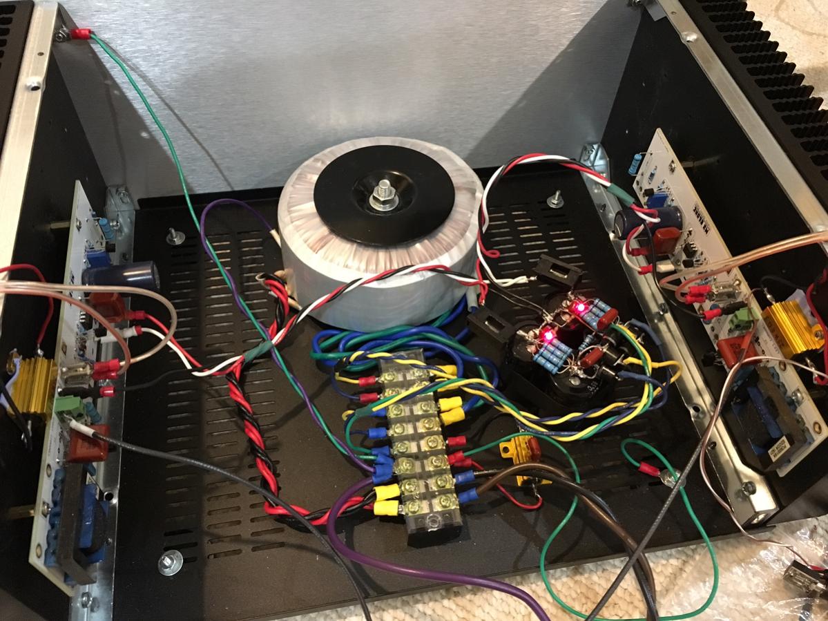

I rebuilt my PSU just like the diagram above except with just 33mF on each side of the R in the CRC and connected the clean GND together, dirty GND is connected to EARTH GND with a GLB consisting of an 8R 25w resistor paralleled with a 100nF 250v film cap. The two secondaries are separate and connected to two separate bridges as shown.
Here is photo of new setup (wire connections on terminal block from top is as follows: secondary 1+, secondary 1-, secondary 2+, secondary 2-, clean GND to GLB, dirty GND/Chassis GND/EARTH/Trafo static shield, mains hot, mains neutral):

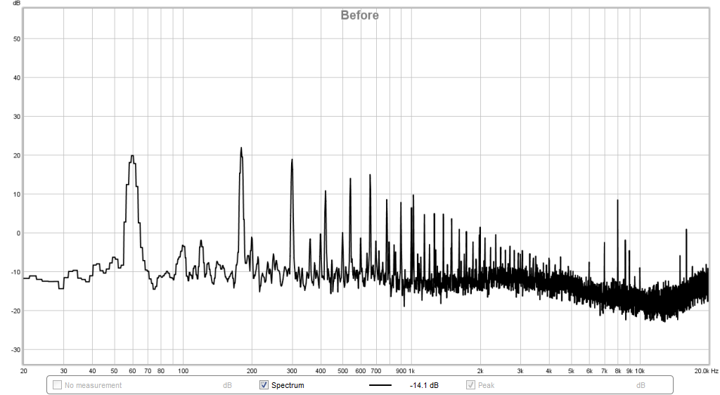

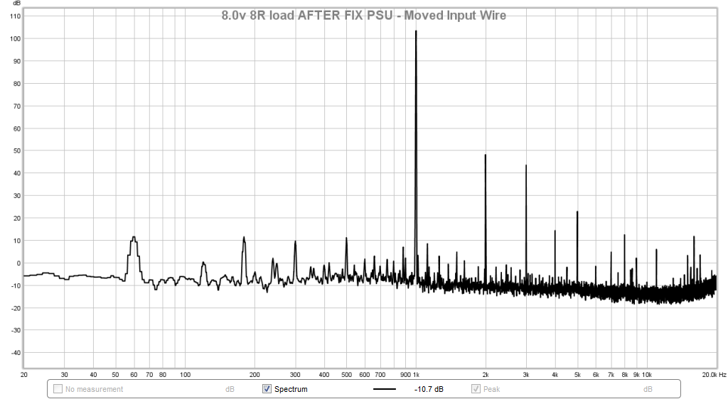

Here is FFT of amp output with no signal before the change to the PSU:

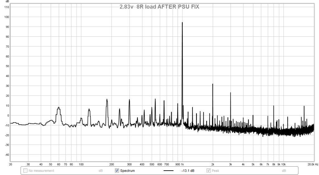

Here is after switching to the new setup as described above - seems that the noise is still there:
Here is with 2.83v into 8 ohms 2kHz signal:

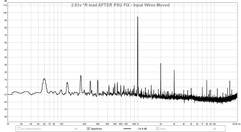

But now I find that moving the input cables high up (away from mains input) gets the HF hash to really go down. I still hear a little bit of hum. So really not much better than my "dual mono" PSU that I had before.
610963d1491889030-strange-forest-noise-linear-psu-after-2.83v-fft-move-input-wires.png
8v into 8R load with input wires moved up high away from mains inputs:
610964d1491889030-strange-forest-noise-linear-psu-after-8.0v-fft-move-input-wires.png
So maybe it is the whole saturation thing that causes the 3rd harmonic and odds above that? Mains measure in at 123.0vac.
I think the PSU topology is now setup correctly per recommendations of folks on this thread. The slight hum I hear is intrinsic to this design? Pass' Specs for M2 noise is 600uV with inputs shorted.

Does the amount of hum change when you unplug the amp from the mains? The amps should play for a while without mains power connected.
It may help if you move the chassis connection to the clean GND and shorten the power/GND leads to the amps. The long PE/GND leads connected to the chassis are also not helping things.
When a transformer saturates the magnetic flux is no longer contained in the core. This will induce voltage in surrounding parts. So adding filter capacitance really doesn't reduce this radiated noise.
If the noise comes from other transformers on the same AC power line then capacitors will filter it as the stray magnetic field is only local to the saturated core.
If you use a buck transformer to reduce the mains voltage it will not significantly lower the rail voltage.
So odd order harmonics come from saturation and are inserted into the surrounding leads by magnetic flux. Rectifier distortion comes from turn on and turn off surges and has even order harmonics. These can be treated by inductors and or capacitors.
If you don't want to use a buck transformer then you need to isolate the power transformer so the flux leakage doesn't make it to the circuitry.
