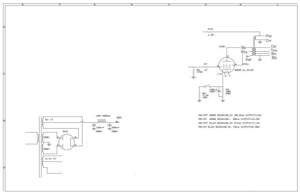

ya ya ya thanks costis_n it is very clear, but will you tell me one thing! Which is very important is that will it possible to use a 150ma 300-0-300V transformer in a KT88 or 6550 because i am not sure will it operate in low power dissipation e.g. 6-8W ? with a OPT 20W?
cause my old amp is a 6.7W EL34B. I am trying to upgrade or improve it.
OK really thanks, but i still not one thing to ask: is the design of that amp ,
(EL34B) cathode is a // 390-400ohms and 100uF,63V turns out the voltage at 26.9V 67ma
and the schematic tells it can also replace with 6550 = KT88 and with a cathode bias 36.2V, 90.5ma .
So is the design really can interchange EL34 & KT88? With no bias problem!
Sorry missed this thread due to work. costis is right - there will be a voltage drop due to DC as the primary resistance of the transformer has to be taken into account. For eg. I use the UBT 2 OPT which has a primary DC resistance of 430 Ohms and drops about 20 Volts at a plate current of 70mA. Also, the mains transformer needs more power. With more than 70mA per channel for the KT-88 alone it would be over loaded. We need to consider around 30 ma for the 2 driver tubes plus some allowance. Reg. the last point 90mA bias for KT-88 is over doing it I think. The recommendations per datasheet are

I am using 70mA at 39V at the grid.
re: vinodt1347 i think you point it out clearly, but will the total current dissipation is the summation of all current? which turns out: plate current is 70ma + biasing ? and i am still miss-understanding the bias setting, the graph can only tell me the load line of the plate but the the cathode, by the link: it saids the capacitor of the cathode is Ck= 1/2pi f Rk.
So that's mean all the things is biased by the resistor of the cathode and the anode resistor?
And in the output stage of vacuum tube amp. Most Class A is loaded the OPT in the anode, no resistor is involve as well. Which the maths will be different. This is totally different from the pre amp. So how to calculate the anode and the cathode?
Total current = sum of all currents (2 KT-88, 2 drivers i assume, screen grid current). I think you can neglect the screen grid current. I did not quite understand the 2nd question. You will need to be a bit more clear. I think the equation you put in is to calculate the value of the bypass capacitor across the cathode resistor. Without the capacitor, there will be negative feedback which will reduce the overall gain of the KT-88.

Emm.. i think i better make things easier cause i am a student at all. I would wonder could any one can help me or just give a schematic of a width range cathode bias circuit.< with a OPT (3k5 3k5 B+)primary | | (4,8,16ohms)secondary | | Power 20W
Old biasing is a 390,15W//100uF,63V supply B+ 380V
I hope the biasing and cover KT88/6550 & EL34. The main transformer power will be increase.

I will be building this amp in a few weeks. I have a question about the power supply. I only have a 300-0-300 200ma transformer (from a previous se84 project). Will the voltage be enough? Do I need to change some resistor values like the cathode resistor?
BTW, I will be using a KT88. I have all the correct parts except for the transformer (voltage rating).

Back to the main problem, is my schematic right or not, or just use the previous amp of this Post? I only got a 3K5 2K5 OPT the ratio i think is 30%- 70% it cannot match the ULT design. Triode or Pentode might do so?
Well, the bias in fixed bias amps is made by a separate negative voltage supply. So it is very different.
And yes, the 6550 is similar to KT88, almost same.
For 2A3, you need also another small transformer to power the filaments. Same fot 300B.
30% ultralinear is OK too. of course 2A3's are triodes, so no UL with them.
We all have transformers we never used, don't worry about that. OR, you can use it with 6L6GT / KT77 /EL34tubes, the power of the transformer will be OK with them.

Will a voltage of 340-360 be enough for this project?
i can't give any information in this reply, cause the data are not enough, please give details of the 340-360V, do you show your schematic out. 300V with a pi circuit rectifier or others? where is the 40-60V goes?
Do you completely follow the schematic of this post, if ys is the capacitance or the inductance is the same? Please remarks!
There are no problems in the current rating of your transformer but i think it can be larger than 200ma. That's the information i can give you.
