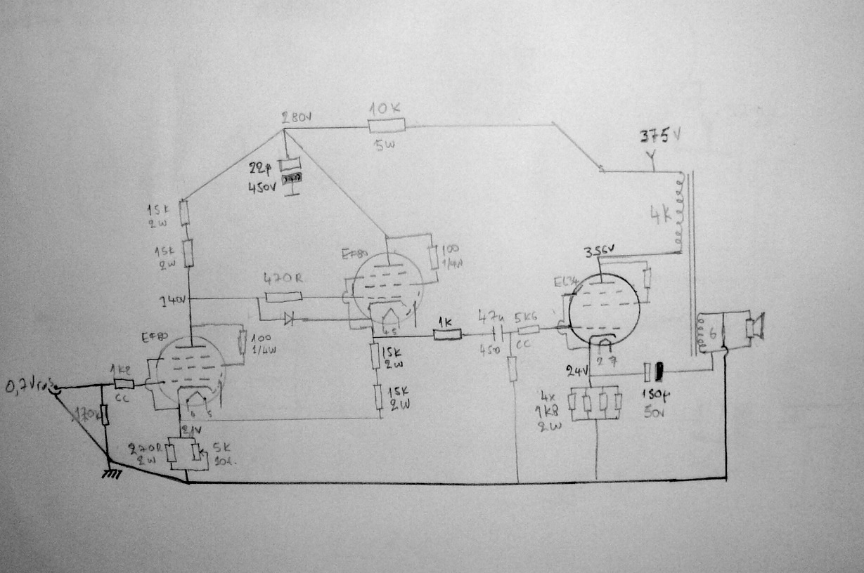

I have to ask has anyone had any success putting a 6DJ8 in the driver circuit?? I could change values of resistors ect. to make it work but I wonder how it sounds. Only asking because I have plenty of NOS 6DJ8 and 12AT7 available and would like to use them up:D
Yes
Yes, you can just drop one in and it will work however itis suggested you change the cathode resistor value to half of the 6n1p value...I have done both and was not impressed much by either change...to me, the original circuit sounds best but again, this is very subjective. Start by just swapping the tube then parallel a resistor of the same value to the cathode if you don't like what you hear...IIRC it is 1K and the recommended value for the 6DJ8 is 500-600R....that is IIRC...
Thanks JM, I'll have a go. Perhaps also buying some 6n1p tubes might be worthwhile, after all they are pretty cheap. I might even try using both sides of the 6dj8 to drive a single kt88.... now I just got to find some output transformers.:D
Here you go. It is for EL34, but you get the point.

This design is simple and sounds great as it is...sure you can do all sorts of different iterations on the driver circuit but until you have built it and listened to it as it is, I wouldn't change a thing...just my two cents from a guy who has built it a few times now....
As far as output transformers go IMHO you can't beat the price and quality of Edcor...they perform way better than they list in the specs....the Mars OPTs are good too...I habe used James as well...my favorite was the Edcor...big and heavy but who cares...it is a tube amp...wasn't meant to be portable.
The beauty of this amp is in it's simplicity and price...for as easy as it is to build and for how cheap you can do it it sounds fantastic...
I have built it with premium parts and average parts and either way it sounded great...I was not a big fan of subbing the 6DJ8 with either cathode value...seemed to suck the life out of it either way....but that's from a guy with badly damaged 43 y/o ears so take it for what it is worth...I do recommend setting it up with a two pole three position rotary switch to enable it to switch between triode, UL, and pentode...if you have UL taps on your OPTs.

Trancendar are fine...I have built with them a few times now, probably would go with the 15w especially if you decide to run in pentode....I haven't built this amp with them but I have built a similar circuit and they were good products.
