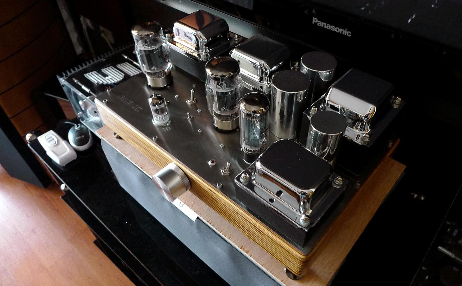

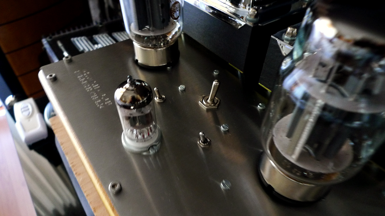

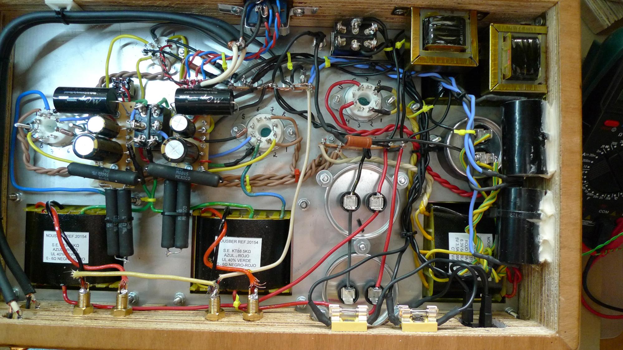

Hi all,
And I have mine running!.
Absolutely quiet, great sound. It is best to ring, very natural.
I placed a switch to change the bias and another to remove the pot.
I want to apply ccs in the anode 6n1p and eliminate the resistance of 47k. Okay ixscp10m45s with a resistance to regulate the flow?, How many watts must be the resistance?
regards
regards
