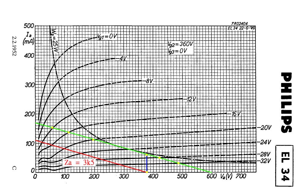

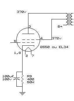

Could any one teach me that will it possible to change the bias of an EL34 into KT88. Because i would like to try the KT88 with the orchestral music. And the original bias of the EL34 is a // circuit with 390 15W and 100uF, 63V, which turns out about 26.9V &67mA bias. Will KT88 draw much current than the EL34? cause the transformer might not enough.
Please help Regards

What transformer are you using?
Are you saying your cathode resistor is 390R for the EL34? If so, I beleive that is a bit low for the EL34 all things else being equal to the original design.
If I recall correctly (you can refer to the schemtic at the beginning of this thread) the original design called for a 560R cathode resistor for the EL34 and then used a 3K to parallel the 560 to bring the cathode value down a bit for the KT88 operation (470 i beleive is the parallel equivalent)...
Again, this was the preference of the OP, not set in stone.....
With 390 on the cathode you shouldnt have too much issue as long as your OPT is rated for it...

Yeah, the design originally calls for a 5k primary...
Is this amp already up and running? Are you using the 3.5K primary?
If you are already using the 3.5K primary with a 390-400R cathode resistor I bet the KT88 will work better than the EL34 as you have it already set up.
RE: vinodt the B+ is marked in the graph
Re: jmillerdoc the amp is running and i am using a pentube mode which connected to the B+ , 2K5 with the grid and 3k5 with the anode. but will you told me the current of the KT88 i think it might over load
Z = (Vin / Vout) squared.
if Z = Va^2 / Pa : Z = 380^2 / 25 Z =~ 5800
what is the use of this Z for plotting the load line and define the operation point?
Would you teach me how to define the current flow of the EL34B and the KT88, which the main transformer might over load. I have check the design of this post, which turns out the main transformer is rated as 600V C.T. @ 230mA. And my old transformer is a 600V C.T. @ 150mA. I think this is not enough at all. But with in a Class A design it might draw much less power than Class AB.
So would it possible to change the bias of the old setting and replace the EL34?

I have plot the graph and i am not sure is this right or not>
Looks okay, just remember the anode voltage in the plot is from Anode to Cathode, not from B+ to ground.

First of all. this amplifier is triode or ultralinear, so you have to use the correct graph. They re all in the datasheet.Well in my transformer it is more like 20 Volts. Don't listen to what other people with other transformers say, you have to measure it yourself. So you have to measure the voltage at the anode.
Then you have to adjust the cathode resistor so that the cathode is around where you want it.
Then you plot your load-line to see if it is okay.
