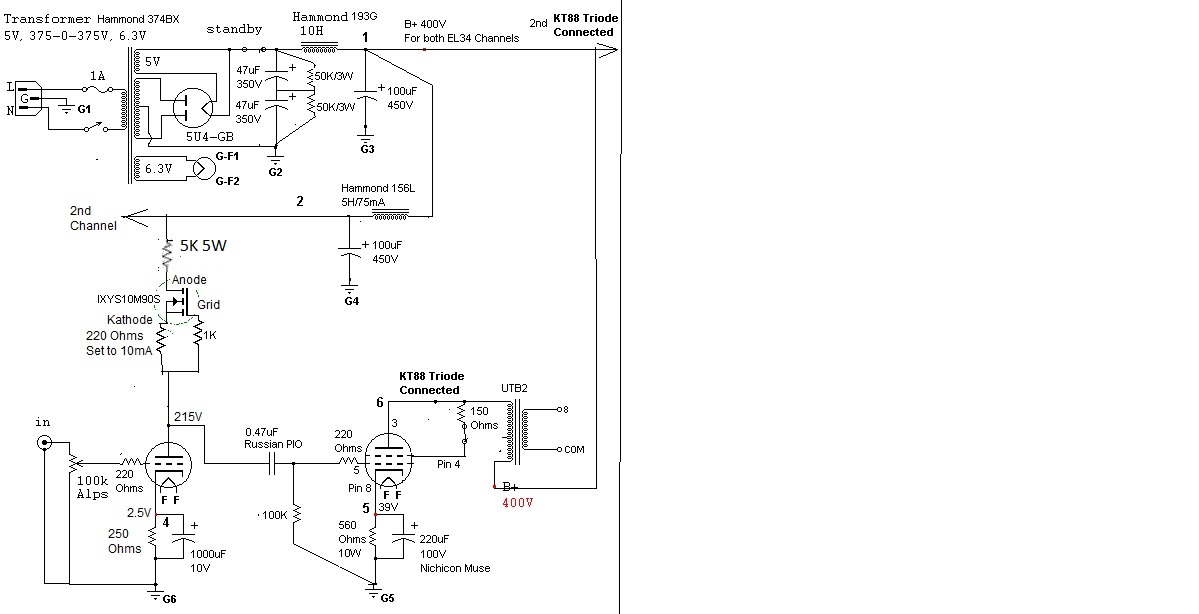

D3a Driver + CCS plate load
This is the circuit I have implemented. The driver is the D3a pentode in triode mode. The cathode resistor used was actually 180 ohms and not 250. That gives a grid (cathode) voltage of 1.8 V due to the 10ma flowing.
The IXYS chip can be obtained from Future electronics. It should be well heat sunk.
I have also tried this with a 25K/10W resistor plate load. The CCS is better.
The output transformer is 5K SE - UBT2.
Vinod
