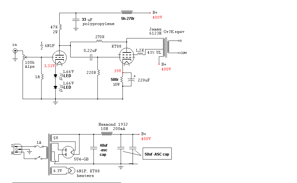

I have been using PSU II and I got a nice CLCRC. 33uF is the max value for the first capacitor for this specific tube (5u4-gb). What I got is: 33uf - 10H - 220uF - 250R - 120uF. I don't have the transformer so I cannot check the resistive value. I'm all confused now because of that article. Any thoughts?

Just waiting for an answer, I browse 5u4-gb datasheet. What they say here is that you MUST NOT connect the tube directly to the transformer but to use a resistor so that the transformer resistive value +the additional resistor should be in the range of 170Ohms. I didn't buy the transformer yet as I was looking at Edcor XPWR033 or XPWR002 , tube 5u4-GB 33uF - 10H (Hammond 193J) 220uF. Could you please share your working schematic?

this is what i use for mine with 5u4 i get 426v B+ and the current rating is plenty the amp is dead quiet and the LED is a must try.
XPWR048 120Vrms, 60Hz. 700V(350-0-350)@300mA, 30V(15-0-15)@50mA, dual 6.3V(3.15-0-3.15)@4A & 5V@4A $90.33 USD

Thank you for the schematic. I want to try triode mode only with 120Ohm resistor. I may try the LEDs as per your schematic.

Yes, you need to go with the SE. The PP will not work well because it is designed for a Push Pull application. The SE is for the Single Ended amp such as this one on this thread. The SE is air gapped to accommodate the current running through the SE design in such a way as not to saturate the core. The PP core will likely saturate at certain frequencies and give a poor bandwidth response. People have used over-sized and over-rated (watts/current) PP OPT's for single ended applications but I think the one you are attempting to use here wouldn't work well. If you are planning to buy new from Edcor but don't want to spend the $$$ for the top-line OPT consider using their second best line of SE OPT's. They have a rated response of 40-18K but you will likely get better than that. This would be much better than trying to use the PP OPT and should definitely outperform the PP OPT in bandwidth. I used the top-line Edcor SE OPT's in my build and they work super!
Hi all,
I am in process of building this amp but I got stuck in OPT.
Would it be sufficient to use GXPP15-8-5K from Edcor, considering it's a 15w transformer or I must go with CXSE25-8-5K ?

I'm an idiot. I meant GXSE15-8-5K I am worry about 15w. I can live with 40Hz (i think).
What I am doing is putting a variable resistor in the cathodes of the output tubes. There are some very nice and small 12.5 Watt, 500 Ohm rheostat from Ohmite on eBay at this moment at a very reasonable price....

You may want to consider placing your pot in series with a minimum value resistor that way you could make it to where you never "dial in" to a dangerously low value. Just my 2c worth.

Should have mentioned that I am placing 120 Ohm resistors in series. Am still ponerding about a CCS in the plate/g2 lead to prevent the output transformer being destroyed should the tube short. Just set the CCS for a current about 10 mA larger than max operating levels at max mains voltage fluctuation.

What were you planning to use as a CCS?

I have a switch to choose between CCS with DN2450 and 47K resistor as a load for the driver, and everybody preferred the CCS. This is also something to try, very easy to implement. My CCS is set to 6.5 mA, with the 47K 4.5 mA are drawn.
Led for the cathode 3.4 V.
