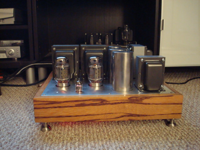

i built mine with the CXSE25-8-5k, i have use the gxp15 and theyre good for the price but for this built "KT88" i i prefered the bigger iron looks better too.😀
Thanks Tim.
Awesome amplifier you built here.
