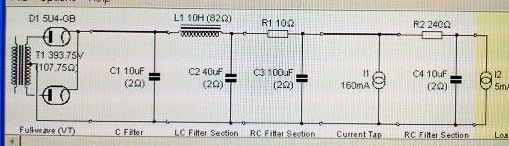

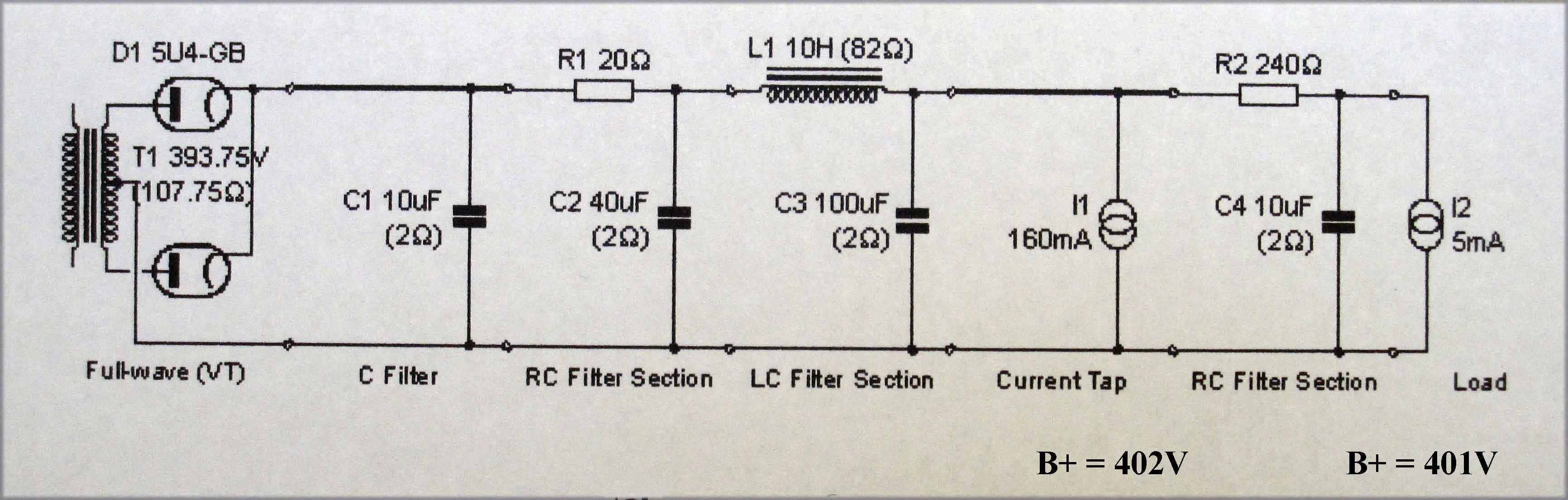

Thanks Svein and Seel! I was curious when rewriting the schematic... I've written the schematic as CRCLC, so I'll wire it as CLCRC... Wow! I think this is finally it! Time to put it all together. I'll do a simulation in PSUD2. Thanks guys!
PSUD2 Simulations:
CLCRCRC: @ 160mA tap: B+ = 402V, Ripple=0.095V
@ 5mA tap: B+ = 401V, Ripple=0.043V
CRCLCRC: @ 160mA tap: B+ = 402V, Ripple=0.025V
@ 5mA tap: B+ = 401V, Ripple=0.012V
It seems the CLCRCRC has 3x the ripple as the CRCLCRC. That's quite a difference...
PSUD2 Simulations:
I found the same in the simulations, but in real life it does not change much.
