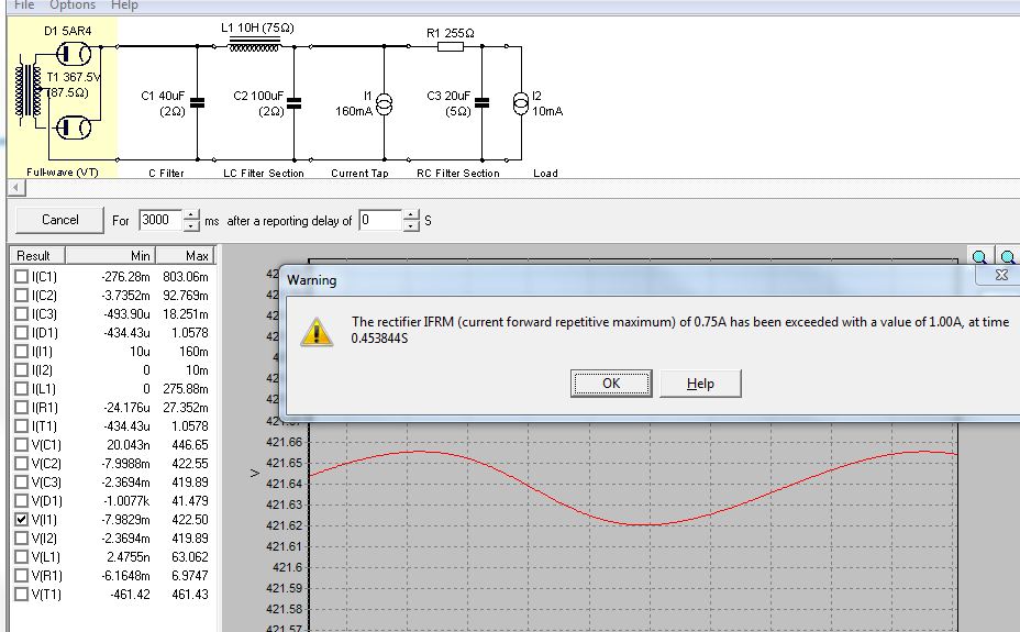

This is my first go at using PSD2. I'm looking at putting a 5AR4 into the power supply instead of a 5U4-GB. I have a few questions.
First, did I build this model correctly? I'm still a little shaky on how to model the loads. The first V(I1) is B+, the 160 mA is the draw of the KT88s, and the final RC represents the channel separation as done by Kegger at AK (510R and 10 uF per channel).
Next, PSUD2 throws an error message, complaining that I've exceeded a current capacity of the rectifier. This seems like something that should be a concern. Is it?
You need to add an initial delay into the calculation, say 1000ms. I also was getting this error when I first started using the calculator.

EDIT: That's about what I got for a B+, right around 420v

I take back what I said about the delay, I don't get that error with 0 delay like you have. Not sure what's going on.

It is 7.5, and my previous iterations of the model had that, I just hadn't changed it back. It has very little effect on the model. It certainly doesn't solve the problem I'm having.
Using a reporting delay of 1s causes chaos to occur. The graph becomes solid red and I can't change the range to anything other than 421.655 to 421.685. If I zoom out there are just a vertical lines, and if I zoom out more, the only y value is 421.668. Chaos. So that doesn't work.
What should the transformer resistance be? I just used the built-in calculator based on 350V nominal output at 0.2A, which comes up with 87.5 ohms.

huh, I disabled "soft start" and the error went away. It shows a mighty current spike through the rectifier at start-up, but I guess that's not in accordance with reality, since it takes a few moments for it to heat up.

Look at the GE 5AR4 datasheet on Frank's Electron Tube Data site. There is a formula on the sheet for calculating the required series resistance value. You might also try reducing the input capacitor to 30uF. The 6N1P RC filter caps only need 10uF. When I built my version of this amp I used LC instead of RC, it provides better filtering. I also initially tried the plate-to-plate feedback. To me it reduces the clarity of the amp, however I am not using pentode mode, too much distortion for my taste. I have mine setup for triode & UL only.
Thanks! Looks like I need two 100 ohm resistors, one for each plate of the 5AR4 to even try this rectifier. I thought I could just swap one in for my 5U4G I now have. I little reading does wonders 🙂
