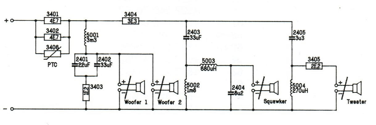

Post No 1 shows how the speaker are connected. The colored threads go to the speaker positive. Speaker positive is found if you connect a 1.5 Volt battery and the cone or dome moves away from the speaker.
Please do not get confused: At the x-over speaker positive may be connected to negative! This is to keep the phase constant, which changes from the coils and caps.
Maybe you thougt this was wrong?
If you compare the length of the wires you will find the tweeter probably to be a little longer than the one to the mid.
This may help, schematics are not evil, they are your friends!

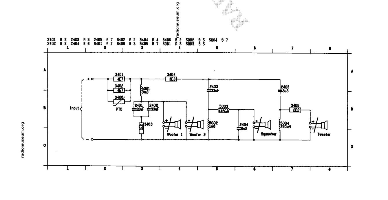

This one is from the service manual. Interestingly, the PTC does not protect the tweeter, but the whole box. A very questionable concept. Anyway, you diasabled it, which is a good thing.

Thanks for the schematic, Turbo!
We can now see that the PTC in parallel with the two 4.7 ohm resistors forms the overload protection circuit for the entire speaker. Here's how it works:
When operating normally the effective resistance of the protection circuit will be smaller than that of the cold PTC (a small fraction of an ohm).
During a prolonged overload, the resistance of the PTC will rise and so will the effective resistance of the protection circuit (perhaps to around 2 ohm) thus reducing the current flowing to the loudspeaker system.

Galu and Turbowatch2, both many thanks for your time and input. Also thanks for the schematic; I found it myself too (see attached picture).
Like you said Turbowatch2, the cable to the tweeter was a BIT longer...I did that check also. Next to a small bend in that cable (which was made when I pulled it out) I could more or less trace back that I actually did switch the cables...which I cannot believe...just a total brain lock-down somewhere when I wrote it down.
So, I again changed cables yesterday, had to wait for a day for re-glue, and voila, the sound is back as it should be!! I feel really silly 🙂
Anyway, so happy that it came down to such a basic error in stead of another more in-depth problem.
The coming days I will do the change to the other speaker as well and then I can finally listen to the 'new' set!
Curious if I can hear a difference...with the new damping added, the new Jantzen capacitors, and also now that the PTC has been shorted.
And yes Turbowatch2, I'm a novice. Not a first time (I did repair a Korg M1 synthesizer a year or two back from a bad capacitor in the PSU section) but my knowledge in general of these electronics is very basic. Only starting to understand the functions of the components, how they interact and what they do. Reading out this simple schematic while looking at the crossover board is also very helpful in understanding what's going on.
Looking closely at the schematics I notice one thing: There are two capacitors working parallel to each-other, namely the 22uF and one of the 33uF capacitors.
Now, could they be combined into one capacitor of the combined values of the two? So, one capacitor with the value 55uF?
If so, why didn't they do this? Or am I overlooking a vital function of each of the two capcitors?

Regarding the capacitors, 22 uF and 33 uF are preferred capacitor values. They are used in parallel because the required capacitance of 55 uF is not available as a preferred capacitor value. There is no other reason and no 'vital function' for this combination.
Reactions: picowallspeaker
It is wrong to search in such a simple x-over for any sound improving trick's. So putting 2 caps in parallel is only for cost saving, not some secondary capacitor resistence etc. It may simply have been a few Cent cheaper to use (many thousends used!) combined 33 and 22 uF instead of a single 55uF cap. This x-over is all about low cost. 6dB with a impedance correction for the woofer, 12dB for the other way's.
The IT versions one stage higher would use MKT caps for parts 2403 and 2405. This is the only sound tuning I would think about for this speaker. The 3.3uF may be worth replacing. A good industrial film cap should be around 1-2 €. This may improve the fine details a little. Do an A-B test if you like.
Anyway, modern, basic bipolar caps sound very similar to film caps. The old ones you replaced, even new, were often audible worse than film capacitors.
